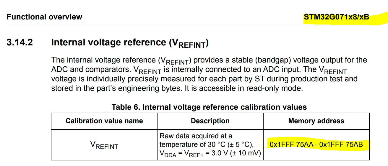

It's in the HAL LL library as well. Apparently the same for all STM32G0 chips:
https://github.com/STMicroelectronics/STM32CubeG0/blob/fc04c80381ca29237220794fb4dd8bf68043ecd9/Drivers/STM32G0xx_HAL_Driver/Inc/stm32g0xx_ll_adc.h#L246

I wonder where I can find VREFINT_CAL_ADDR ,Thanks�?
Apr 16, 2022 3:32 PM UTC
For what chip?
