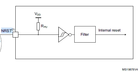

Hello, i am interested in the input structure of the NRST pin of the STM32G0x0 series. The datasheet shows a reduced diagram. My question is: is there a more detailed version of the input structure. Is a clamping diode to Vcc build in? If so, which current can this diode handle?

Welcome @pp_ee, to the community!
Why should there be a clamping diode there?
A large, charged capacitor should not be located there, 100nF should be sufficient in the vast majority of cases. These 100nF do not contain enough energy to cause destruction.
