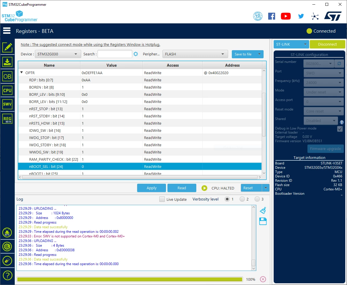

Hello
I work on the stm32g0 micro.
i programmed it with a simple "blinky" code.
it works correctly.but when i reset it doesn't work until i program it again.
can you help me?

The same problem for me and the year is almost gone. When ST pretend to solve this problem?
JCuna.1
Senior
November 23, 2021
Ok, I got a workaround, changing bit nboot_sel from 1 to 0 fix the problem of bad reset while debugging.0693W00000GYWH6QAP.png

This is because G0 goes down to small pincount packages, hence Reset can be gpio, boot pin is also swd signal for debug.
