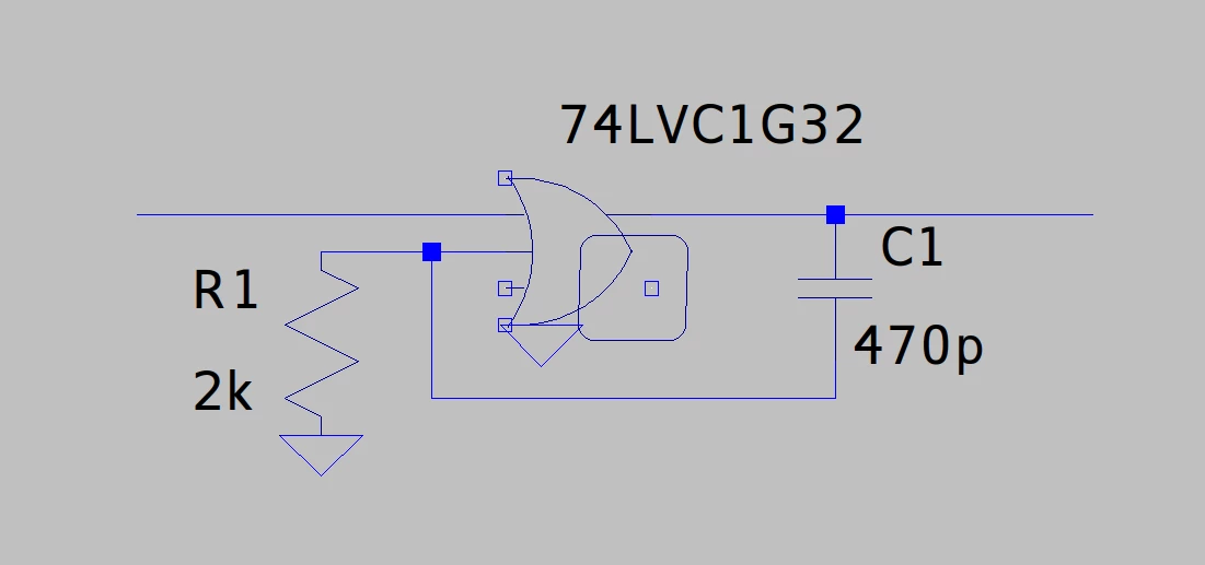

AScha.3
Jun 20, 2025 11:10 AM UTC
just put a simple gate at the pin, making any positive pulse longer (1 us or so):
...and problem solved.
