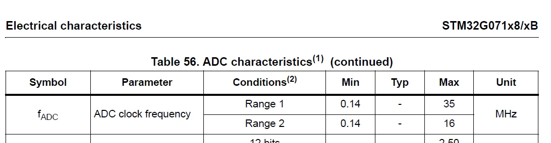

I don't understand why CubeMX is limiting me through their IOC file to select an ADC clock below 2MHz. The datasheet says 140 kHz is the minimum ADC clock frequency for the STM32G07. Anyone has any answers or help ?.

Could you please tell in which datasheet and on which page you found that 140kHz?
Sep 3, 2025 10:57 AM UTC
