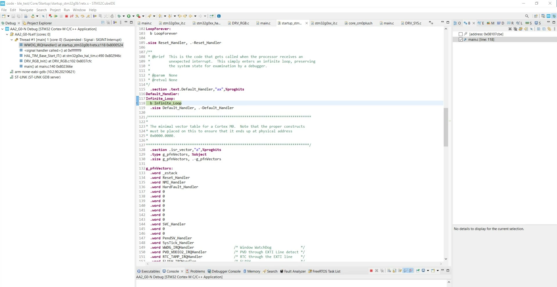

Enabling any interrupt at the initialization triggers the WWDG_IRQHandler when watchdog timer doesn't even configured in the code whereas excluding bootloader fw doesn't seem to cause any issues, code runs fine. In the bootloader fw, I haven't configured any interrupts except the cubemx generated system interrupts such as NMI, Hardfault, svc, Pendsv, systick and RCC_CRS.
I've ensured to define handler for all interrupt request in the app fw. code is developed for stm32g0b1ret6 mcu

It's a catch-all Handler, dozens of the vectors point here.
Determine which is firing, perhaps USART or SysTick. Narrow down to what loader uses. Ensure VTOR is aligned​

Looks like it's debugged already - see the called procedures' hierarchy in the left pane - watchdog interrupt is firing.

watchdog hasn't been configured in the code. It is the default handler who is triggering the watchdog handler. Not sure why?

Issue has been sorted. It was because of improper address in the VTOR register in app fw.
