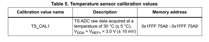

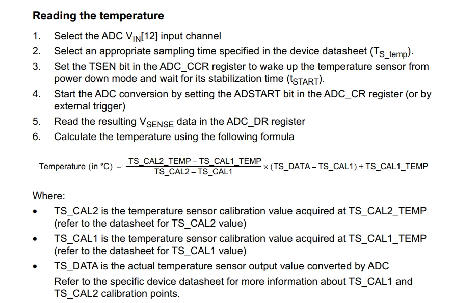

Hello All,
I need to read tempereture of mcu.
But I confused about formula given at referance manual.which is below.Because there no data TS_CAL_2 val
Thanks.
Regards.
EMRE

Hello @emre ÖZDEMİR​ ,
There is a internal request to update the formula in the coming releases of the RM0454.
In the meantime, you can refer to the formula provided in RM0360:

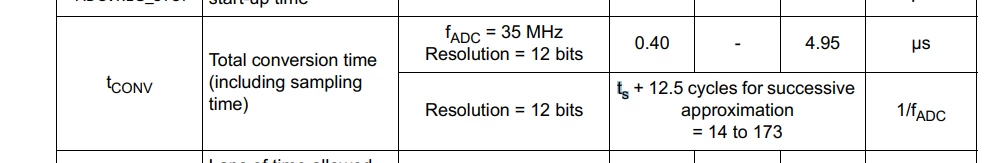

About sampling time when I check the datasheet
Here is the conversation time formula
0693W00000DnkJKQAZ.pngfor temperature minimum value is 5 ms
ADC clock speed is 16 mHz.
And ADC clock prescaler is 10
Sampling time 160.5
if I calculate the time (160.5+12.5)/(16MHZ/10) = 108 us.This should be suitable then.
There is not a info about a certain sampling time to read temperature.

waclawek.jan
Sep 21, 2021 9:15 AM UTC
Which STM32, exactly?
> here is the code for vref (I get this formula from datasheet)But this also gives me (around 2.78V) from the calculation.
> Vref = 3.00 * ((double)adcData[3] / *VREFINT_CAL);
No, it's the other way round, Vref = 3.00V * (*VREFINT_CAL) / adcData. That gives Vref = 3.23V.
What is the actually measured voltage at VREF+ pin?
From this, voltage at your temperature sensor is Vref*1005/4096=3.23V*1005/4096=0.793V
The calibrated 30deg. voltage is 3.00V*1042/4096=0.763V, so your voltage is 30mV higher. Given average slope 2.5mV/deg, this is equivalent to 30mV/2.5mV/deg.C=12deg.C, i.e. internal die temperature 30deg+12deg=42deg. IMO entirely plausible.
