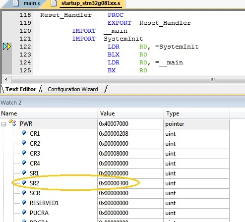

STM32G0 - Initial PWR register settings
Checked PWR settings at startup.
Find PWR->SR2 status value 0x00000300.
According manual this tells
  • Regulator in Low Power mode (LPR)
  • Flash memory in power down
Is this initiated by Keil/ST-Link debugger?
Or are there errors in reference manual of register PWR->SR2?
JuM
JuMBest answer
Senior
Jul 30, 2020 12:36 PM UTC
Sorry, sorry...
Forgot to enable clock for peripheral PWR:
  RCC->APBENR1 |= RCC_APBENR1_PWREN;        // Enable clock

Seems that debugger cannot get read access on PWR registers.
Tried to set LPMS in PWR->CR1
  PWR->CR1 &= ~PWR_CR1_LPMS;
  PWR->CR1 |= (PWR_CR1_LPMS_2 );    // 1xx, shutdown
but that does not change watch values of PWR-CR1 from 0x00000208...
JuM
JuMAuthorBest answer
Senior
Sorry, sorry...

RM says that register is only partially reset.
Bit 9 REGLPF: Low-power regulator flag
This bit is set by hardware when the MCU is in Low-power run mode. When the MCU exits
the Low-power run mode, this bit remains at 1 until the regulator is ready in main mode. A polling on this bit must be done before increasing the product frequency.
This bit is cleared by hardware when the regulator is ready.
0: The regulator is ready in main mode (MR)
1: The regulator is in low-power mode (LPR)
Bit 8 REGLPS: Low-power regulator started
This bit provides the information whether the low-power regulator is ready after a power-on
reset or Standby/Shutdown. If the Standby mode is entered while REGLPS bit is still cleared,
the wakeup from Standby mode time may be increased.
0: The low-power regulator is not ready
1: The low-power regulator is ready
So you're in low power run mode. Is that expected? Is your frequency less than 2 MHz as required?
The MCU enters low-power modes by executing the WFI (wait for interrupt), or WFE (wait for event) instructions, or when the SLEEPONEXIT bit in the Cortex®-M0+ system control register is set on return from ISR.
