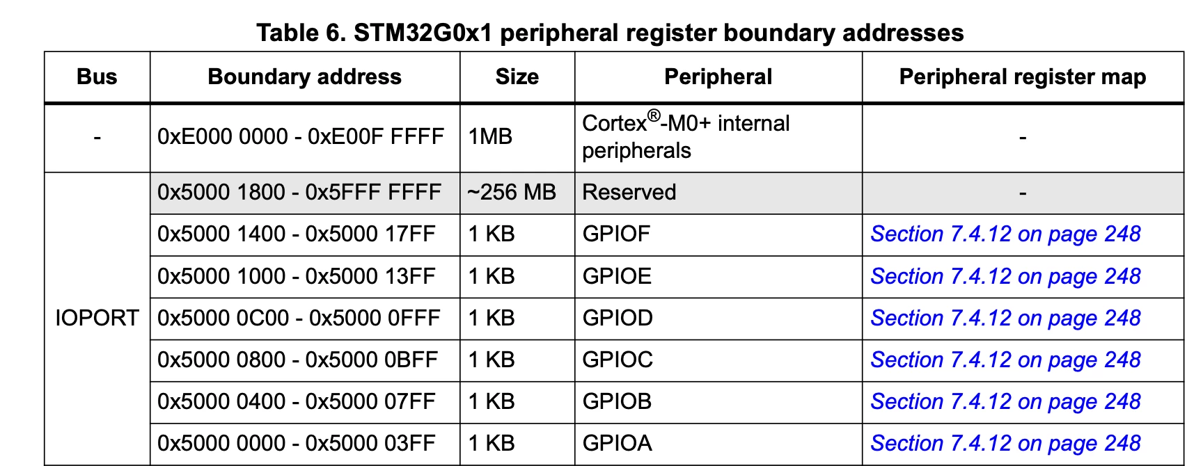

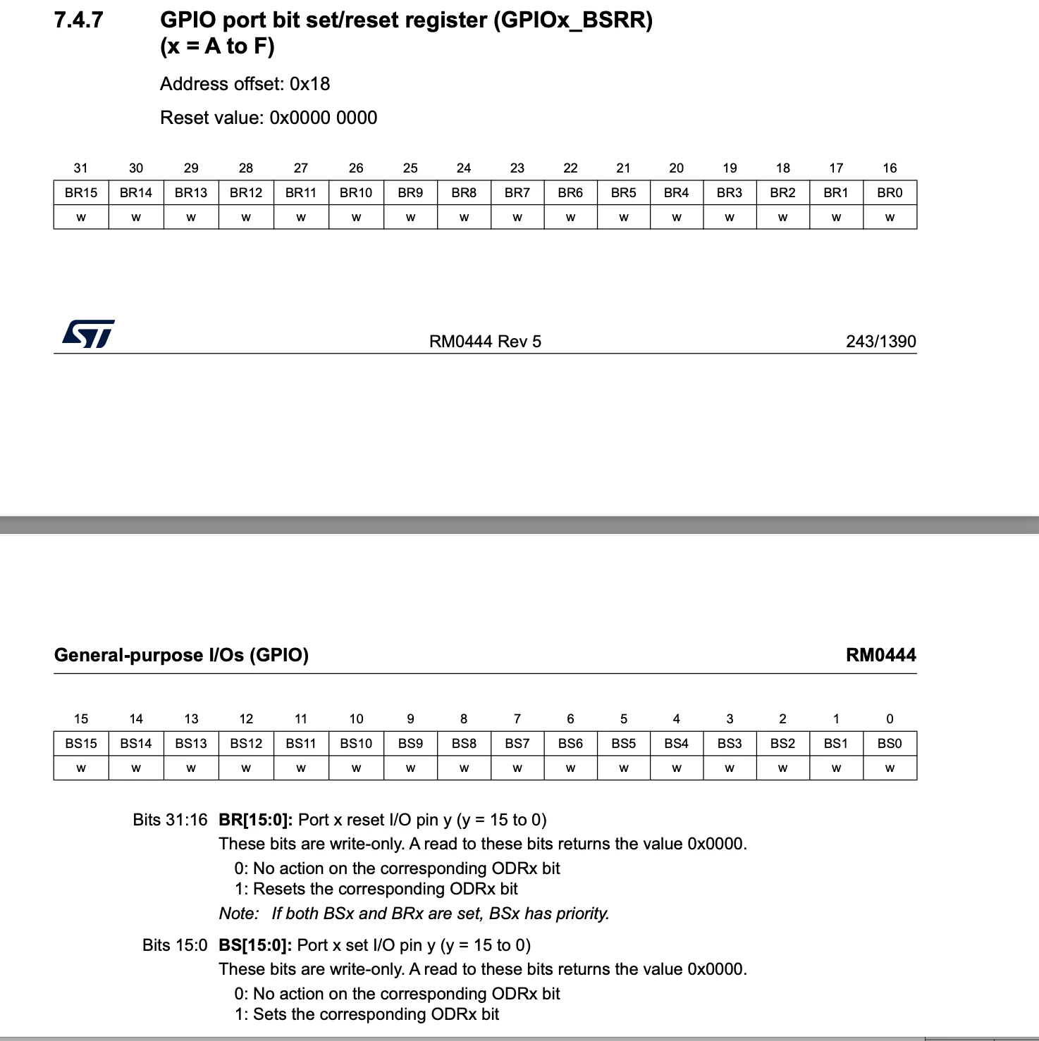

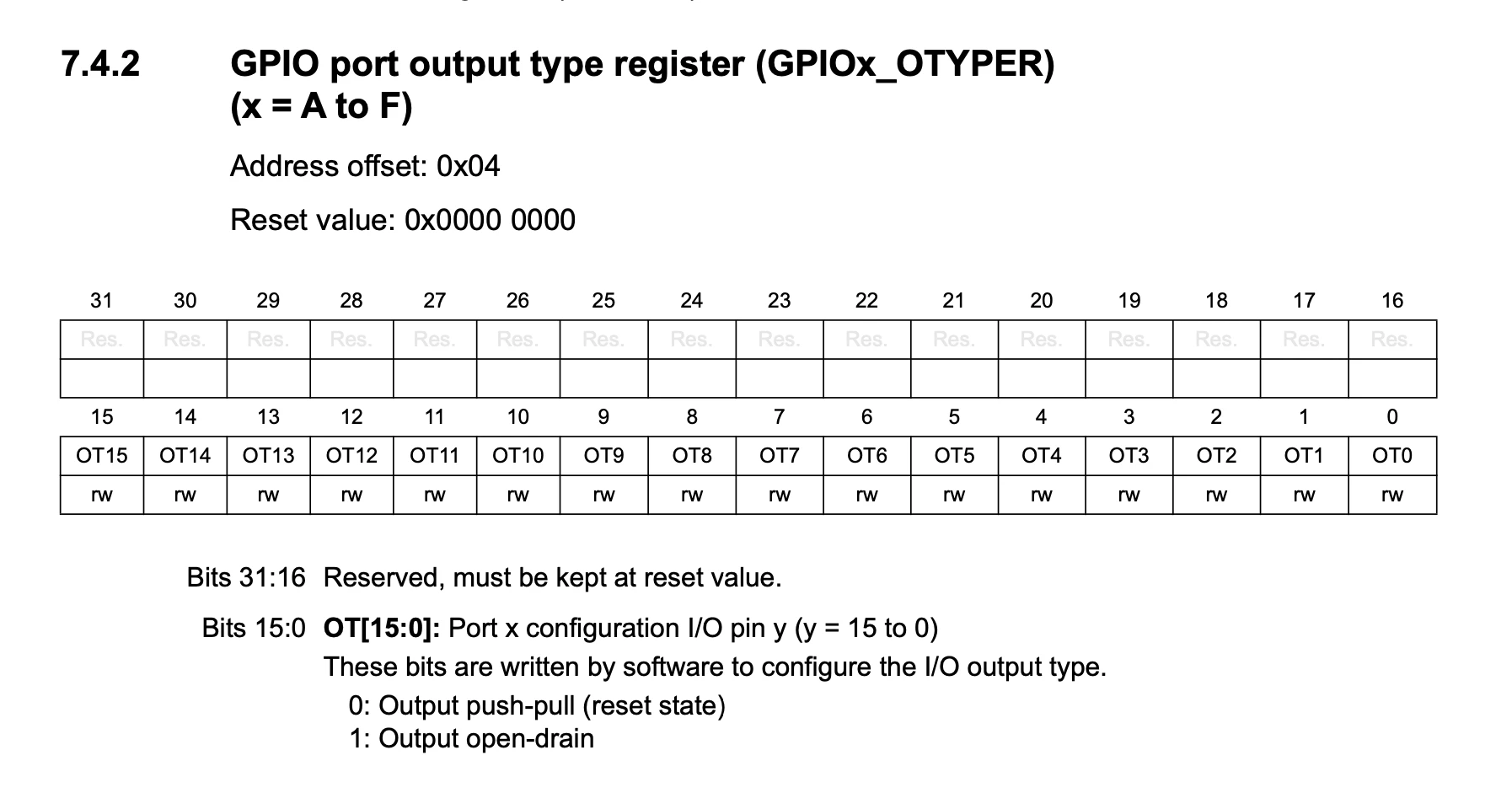

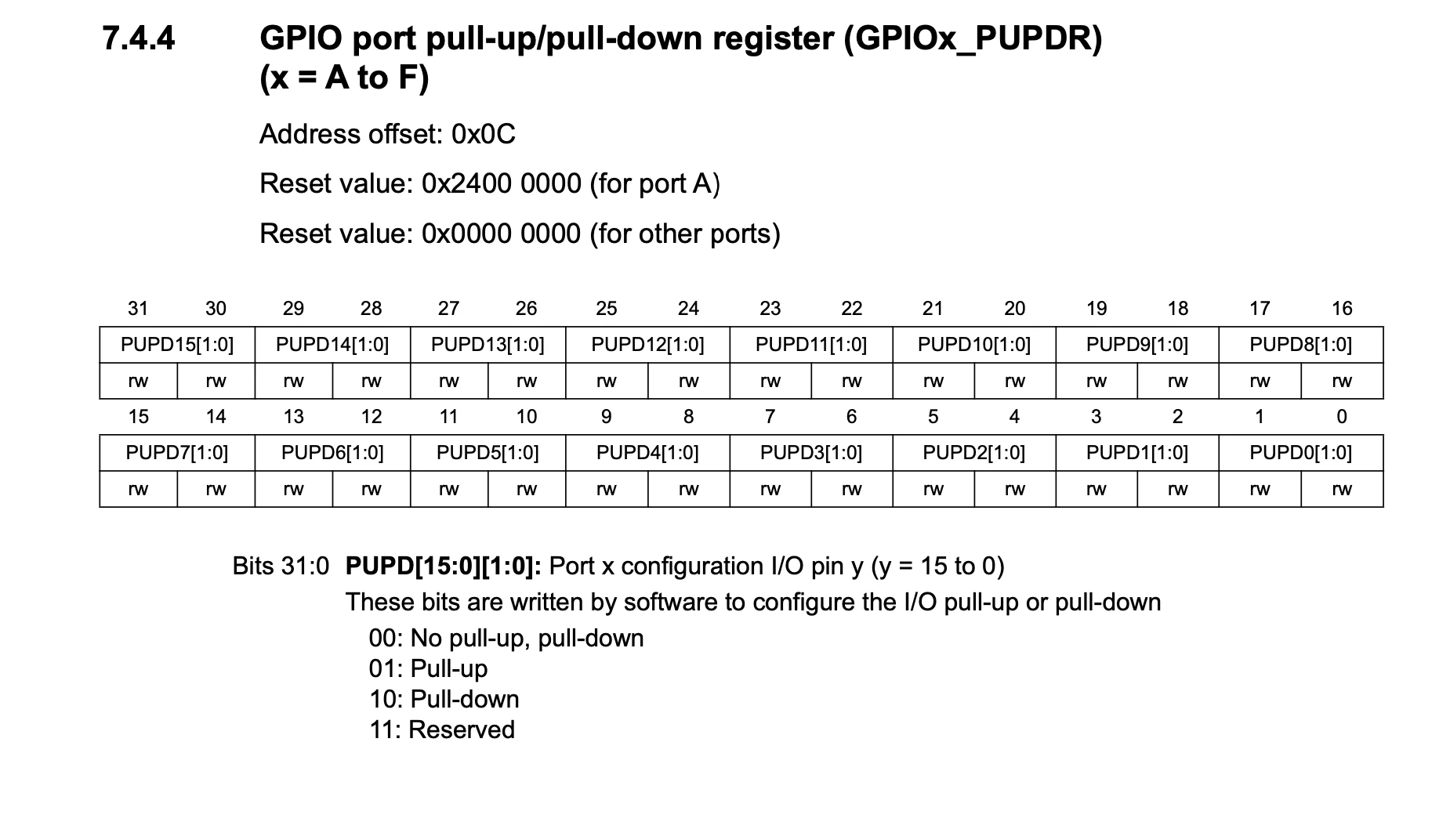

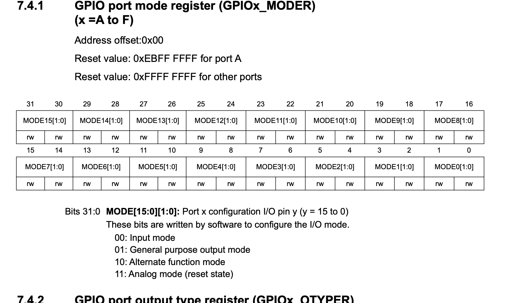

Hi, I use STM32Cube IDE, and use STM32G0 - G0B1RE device. I try to enable the mod register to blink the LED here is the code that i try so far, based on the Reference Manual (rm0444), I need to enable RCC_IOPENR before modify the GPIOx_MODER. But unfortunately it still did not work.
When i try in debugging mode via the SFRs by set the value of RCC_IOPENR, GPIOA MODER (MODER5), OTYPER (OT5), PUPDR PUPDR(5), and BSRR the LED was turned on.
The LED is at GPIOA (PA5) based on the schematic.
Did i missed something? or there is anything to enable before I modifie the GPIOx_MODER?
In the reference manual to enable to peripheral in STMG0-G0B1RE the GPIO Bus is IOPORT not AHB or APB

A few things:
The default value for MODE0 is 0b11, so setting bit 0 will not change anything since it's already set. That is expected. You should to unset bit 1 (not done) and set bit 0 (already set).
Using the CMSIS defines will make your code much more readable. For example:
GPIOA->MODER = (GPIOA->MODER & ~0x03) | 0x01;
Mark the register as volatile to prevent the compiler from optimizing out changes that otherwise have no effect.
volatile uint32_t *ptr;

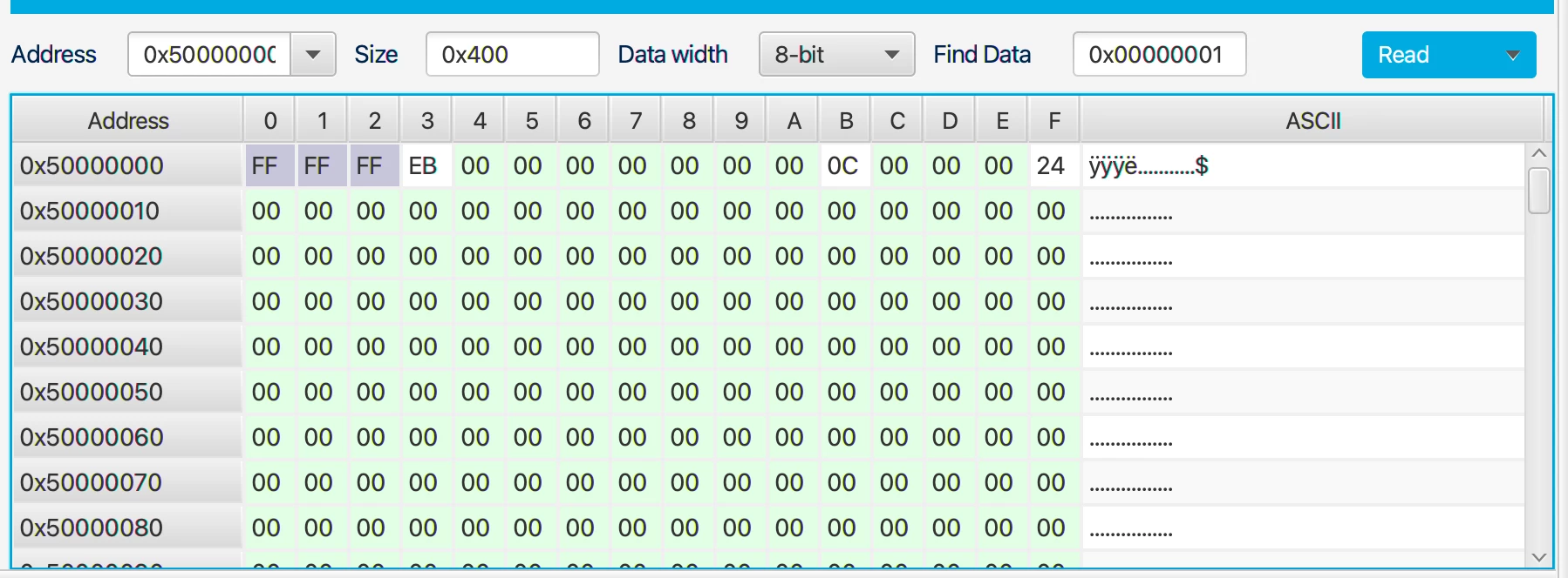

Thank you for your response, but still did not work, when i try with HAL it works, but manually do from the registers it did not work, there something that keep the GPIOx_MODER value not change
 RCC->IOPENR = (0x1 << 0);
	GPIOA->OTYPER = (0x0 << 10);
	GPIOA->PUPDR = (0x02 << 10);
	GPIOA->BSRR = (0x1 << 5);
	GPIOA->BSRR = (0x1 << 21);
this is the memory value for 0x50000000 (GPIOA Register)

Finally did it, thanks to @TDK for suggestion, i will accept your solution.
Here is the working code:
GPIOA->MODER = (GPIOA->MODER & ~GPIO_MODER_MODE5_1)| 0x1; //or ~0x00000800

January 19, 2024
Sorry, thought you were setting up PA0, not PA5. But the rationale was correct. Glad you got it working.
