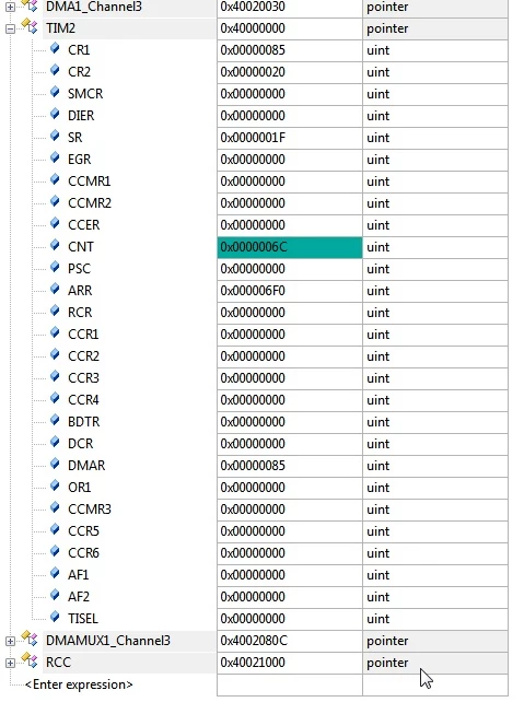

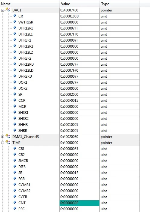

JuM
JuMAuthor
Senior
Sep 12, 2019 6:04 AM UTC
​Yes, added feeding DAC manually with 0x7FF. Result is (Vref internal 2.500V): 1.24 V.
So first TIM2 trigger occurs (also proved stepping manually).
TIM2 is running too, but seems not to trigger DAC again, and DAC therefore sends no DMA requests.
 DAC1->CR |= DAC_CR_EN1; // (Re-)Enable DAC1, channel 1
 DAC1->DHR12R1 = 0x7FF; // pre set DHR, to...
 TIM2->CR1 |= TIM_CR1_CEN; // ...let timer 2 trigger the transfer DHR -> DOR
JuM
JuMAuthor
Senior
Sep 12, 2019 6:15 AM UTC
DAC and TIM2 registers: after first TIM2 trigger for 0x7FF:0690X00000AR8CnQAL.jpg​

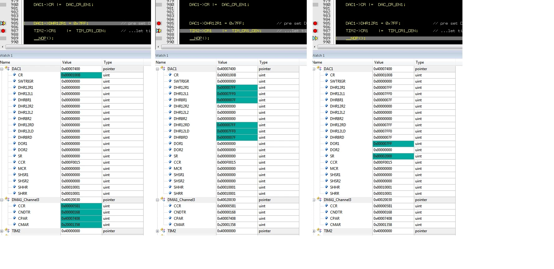

Sep 12, 2019 6:18 AM UTC
JuM
JuMAuthor
Senior
Sep 12, 2019 7:54 AM UTC
DAC trigger sequence (only once...):0690X00000AR8X9QAL.jpg​

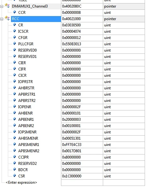

waclawek.jan
waclawek.janBest answer
Sep 12, 2019 8:45 AM UTC
Try to set DMAMUX channel 2.
It appers to me that DMA channels are numbered based 1 whereas DMAMUX channels based 0.
JuM
JuMAuthor
Senior
Sep 12, 2019 11:09 AM UTC
​Jan, great!! Thank you!
Now it works.
