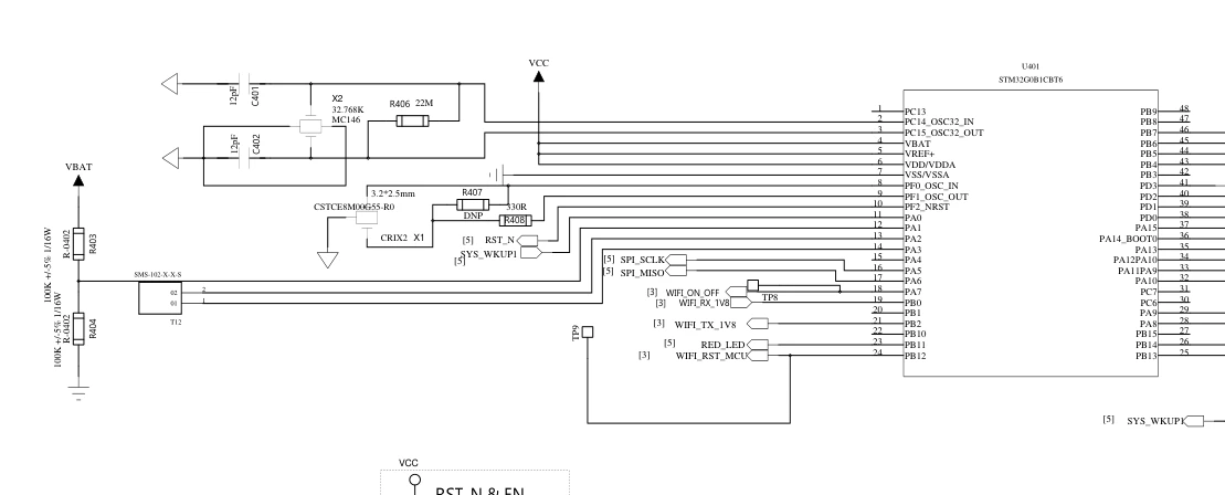

We have a custom board with STM32G0B1CB on which we are trying to measure the battery voltage.
VREF+ pin is tied to VDD which is fed by a DCDC at 3.5V
The battery can go from 2.75 to 4.5V and is fed to channel 1 (PA1) through a 100K : 100K resistor divider giving a max voltage on PA1 of 2.25V.
The battery voltage is currently fed from voltage supply that is changed from 2.75V to 4.5V. As mentioned earlier, at around 3.55V the adc reading has a big jump of close to a 1000 raw value at 12 bit which is just baffling. I am trying to get a curve of adc raw value vs. battery voltage and this jump just breaks the pattern.

What change (hardware or firmware) do i need to make to get a reliable continuous output from the adc?

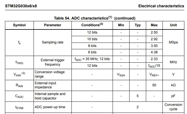

That's too high signal impedance and yes, that can result in such surprising behaviour exactly around VREF+/2.
See ADC characteristics section in datasheet for maximum allowed input impedance for any  given sampling time.

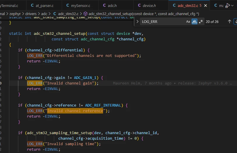

please also verify what will be the Vref voltage in that case because Zephyr STM32 ADC only allows ADC_REF_INTERNAL, what is the that voltage actually since I need to know that to properly convert the adc raw readings into voltage.

September 11, 2024
Thank you JW.
I went through the datasheet as well as the ADC link you posted and indeed need to change the resistor divider value.
will a 40K: 40K divider be ok or there is a lower recommended divider suggested? trying to prevent leakage current through the divider to get maximum battery life and it is too late to change the circuit at this point.

What is "VREF_INTERNAL"? Do you refer to something from RM/DS?
The ADC *always* uses as its reference the voltage on the VREF+ pin (against VREF-, but that in most packages is internally bonded to VSS).
September 13, 2024
sorry,
the define in Zephyr is "ADC_REF_INTERNAL".
running calculations as per VREF+ voltage (tied externally to VDD) or 3.5v worked!
