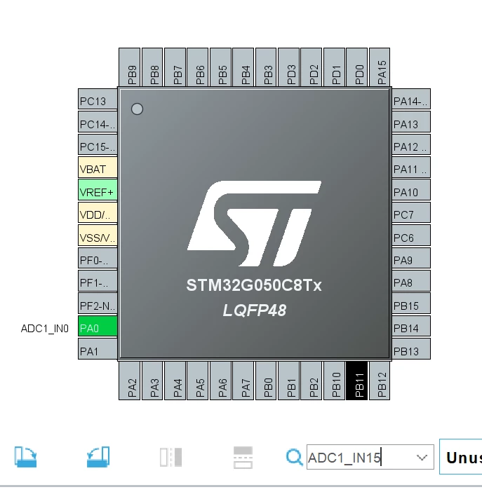

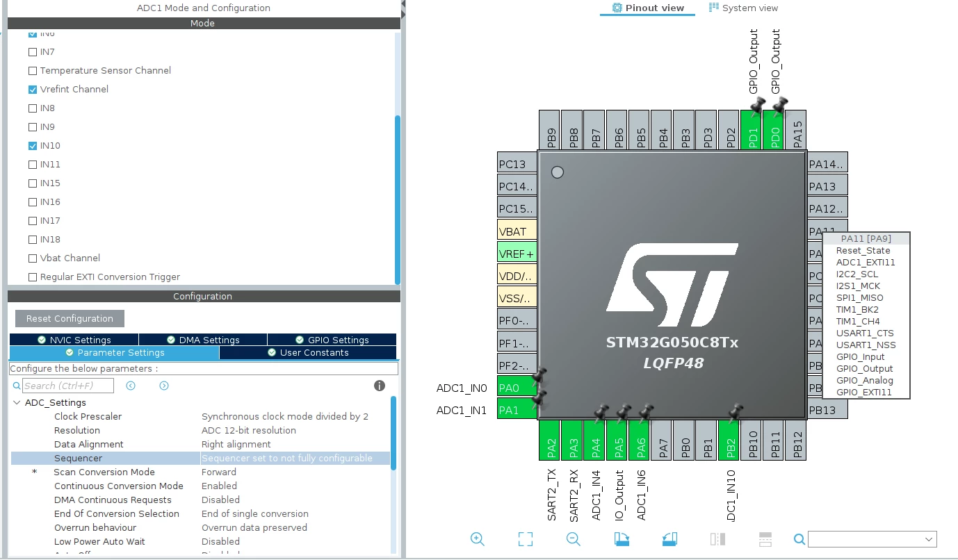

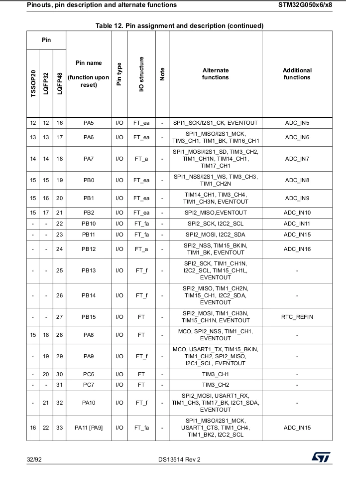

Hi There,
I am currently using the STM32G050C8T6 (LQFP48) and would like to use PA11 as an ADC input, based on the datasheet: DS13514 - Rev 2 specifically table 12, it appears it can be used as ADC_IN15, However in STM32Cube IDE , PA11 can not be assigned to ADC_IN15, I understand that in fully configurable sequencer mode only inputs from 0 to 14 can be used, however in either mode PA11 can not be assigned to ADC_IN15 in Cube.
Finally, the main question is which is correct Cube or the datasheet, and would like to make sure this is not a hardware limitation or mistake in the documentation ?

Probably a typo. PA11 looks to be an alternative pin to the Regular EXTI Conversion Trigger. By default PB11 is selected but you can override and select PA11.
ANx inputs are typically on 1 pin only. If you do a search and IF there is an alternative pin, it'll highlight (shaded black) more than one pin. In this case, ADC1_IN15 only highlights 1 pin, PB11.

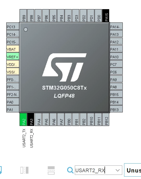

An example is if I wanted to see if there is another alternative pin for USART2_RX. This shows there are 2 pin locations indicated by shading the pin black.

It is not only more than a typo, it is incorrect and misleading on the Datasheet, which should be the source of truth for any part.
I would have thought something like this should be fixed and updated on the Datasheet, are there any plans to update this by ST ? (Last update done on June 2022).
Otherwise as users where do we look for the source of truth ?
