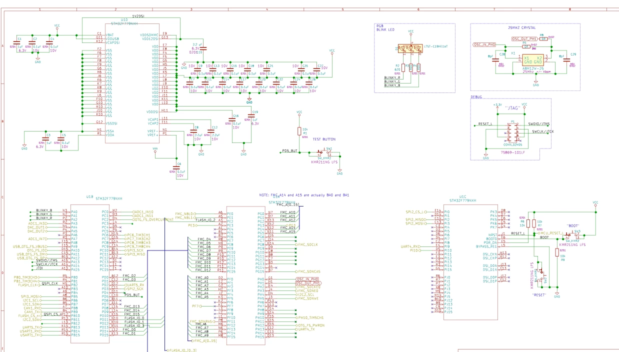

hello I am using the STM32F779NXH MCU it has an internal 1.2V voltage regulator that I believe should output volt on the CAP_1 and CAP_2 pins. The MCU will not boot, and will not be recognized by the st-link. This is a brand new board and has never been programmed.
I have connected the BYPASS_REG pin directly to GND as stated in the data sheet https://www.st.com/resource/en/datasheet/stm32f777bi.pdf. ( page 33 I believe).
I am wondering if there is anything else I should look for as to why there is no voltage on the CAP_1 and CAP_2 pins.
RESET is held high through a 10K resistor to 3.3V, but the data-sheet doesn't mention that the voltage regulator is dependent on RESET.
Also 3.3V is present and correct.
Attached is an image of the MCU page of the Schematic.

From that schematic it is not clear whether VDDA is connected to the power supply.

Good eye, you're a life saver. I owe you all the beers. Blue wired it up and boom it works!​
