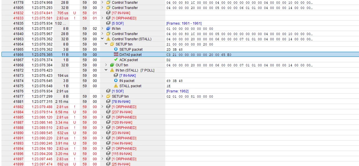

STM32F779 USB Endpoint 0 (EP0) interrupts stop after constant deinit and reinit of the USB
I'm going to rip my hair out... I mean
There has been an issue with rapid disconnect and reconnect of the USB on our product, where the USB stops communicating. We enabled early suspend and when an erratic error (EERR) bit occurs during an early suspend. We plan on deinit and reinit the USB.
Our USB device is using a RNDIS (USB Ethernet) and CDC (Virtual Comm) interfaces. Using Device mode full speed (FS). We are not using the HAL library, We do use middleware from SEGGER emUSB.
To test that this is reliable, we added the deinit and reinit code to a one second timer on the device. It works fine until it doesn't. Looking at where it fails, The STM32 microcontroller thinks after onClassRequest, we have a get status request which was never sent from the computer, then the device stalls endpoint 0. Normally what i observed, instantly, the device would clear the stall on endpoint 0, but seems it never responds back. Then we would start the deinit and reinit process after and the peripheral never recovers. The device would never get up to setting the USB address phase. just keep the constant cycle of GetDescriptor request.
I tried everything besides ripping my hair out. If you have any ideas on what i can try or where to look, it would help.
This isnt the exact deinit, company would make me rip my hair out if i posted their code. This is just an example to show i tried flushing out the FIFO buffers and clearing interrupts to try and fix this issue.

USB analyzer screenshot:
USB STM32 print log:
635:301 Interrupt - EP0 Interrupt
635:301 Interrupt - _OnRx() Start
635:301 Interrupt - Enter HandleSetup: Setup 21 00 00 00 00 00 20 00
635:301 Interrupt - ENUM: OnClassRequest
635:301 Interrupt - Enter HandleSetup: Setup 00 00 28 01 00 02 25 01
635:301 Interrupt - ENUM: GetStatus
635:301 Interrupt - We got spagetti
635:301 Interrupt - _StallEP0: USB_Setup.c:802
635:301 Interrupt - _OnRx() End
635:303 Interrupt - _OnRx() Start
635:303 Interrupt - _OnRx() End

APTchassakBest answer
October 17, 2024
Figured it out, Hopefully no one else ever has this problem.
I don't think this is the correct solution to the problem, but a kludge.
https://community.st.com/t5/stm32-mcus-embedded-software/stm32f3-processes-an-invalid-usb-setup-packet-in-pcd-ep-isr/td-p/446111
Not the exact problem but similar to what remco2 was saying where I was receiving a packet size greater than the endpoint.
After constant cycling of the USB where i reinit and deinit. There was a small chance that garbage can appear in my FIFO. I would have an interrupt triggered and the packet status in OTG_GRXSTSP would tell me I have a [OUT data packet received] packet. The byte count would tell me like 104 bytes going to EP0, but the max size for this endpoint is 64 bytes. I simply checked the size for this case in my code. would reset endpoint 0 by doing the whole flush of the FIFO and resetting Data PID to DATA0 (Idk was written by synopsis, they don't explain anything but left this comment in their code Refer to Chapter 5.8.5 in the USB Serial Bus Specification, Rev.2.0 for reset endpoint). Then the crisis was averted.
There was a second part to this issue, sometimes i would receive the invalid packet when OTG_GRXSTSP for status would tell me i have a [SETUP data packet received] packet. The size was 8 bytes, so i couldn't rely on the method above. Instead i had a flag checking if [SETUP transaction completed] was received to reset this flag. If I received two [SETUP data packet received] packets in a row without a complete. I would reset EP0 like i did above and not process anything after that.
static volatile uint8_t issue = 0;
case OUT_DATA_STATUS:
 //Num bytes from OTG_GRXSTSP register
 if (numBytes > EP0_MAX_PACKET_SIZE) {
 _ResetEP(0);
 break;
 // Process SETUP data packet received here
 break;
case SETUP_DATA_STATUS_COMPLETE:
 issue = 0;
 break;
case OUT_DATA_STATUS_COMPLETE:
 // Process endpoint on complete here
 break;
case SETUP_DATA_STATUS:
 if(issue)
 _ResetEP(0);
 issue = 0;
 break;
 else
 issue = 1;
 break;
I know for a fact this is not the right way, but this should fix what ever temporarily.
 _ResetEP(0);
 break;
 break;
 issue = 0;
 break;
 break;
 if(issue)
 _ResetEP(0);
 issue = 0;
 break;
 else
 issue = 1;
 break;
