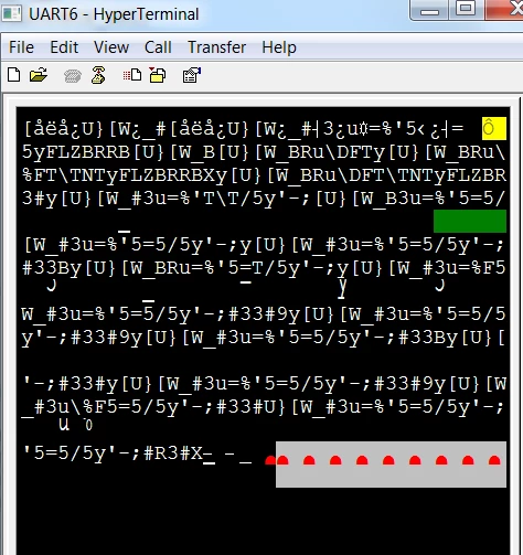

When I try to use UART6 for communicating with hyper terminal (or putty).
My UART6 and HT are configured as below
I get corrupted output on hyper terminal.

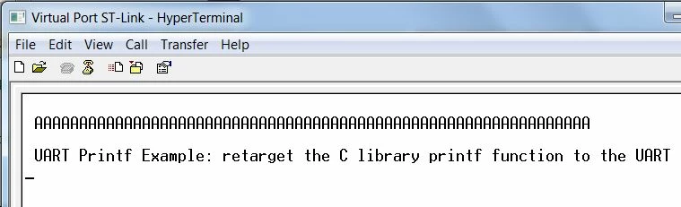

If I use UART1 via ST-link with baud rate 115200. I do get proper output on hyper terminal.

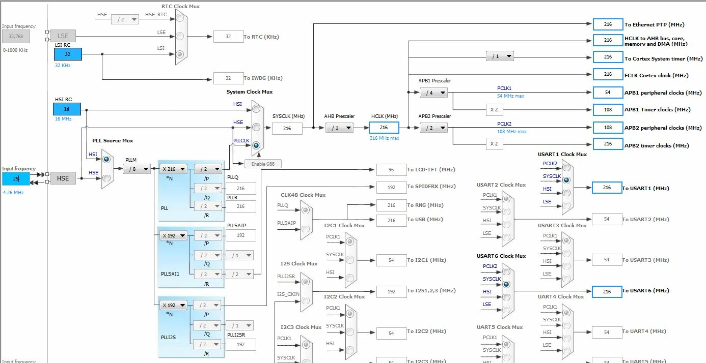

I tried to set different clock source for UART: PCLK2, SYSCLK, HSI, LSE but it doesn't resolve the issue.

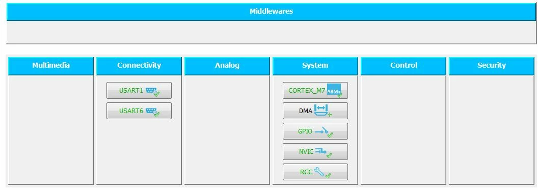

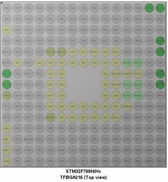

My CubeMx setup is as below:
I don't understand why UART6 output doesn't work as it should be?

How are you wiring USART6 to hyperterminal?
The USART is at CMOS levels which are not compatible with RS232 levels.

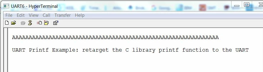

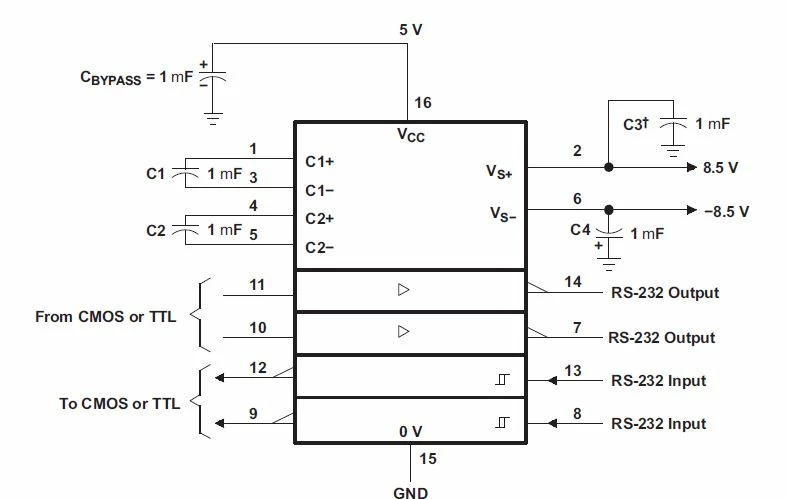

Dhaval Patel
Mar 13, 2018 5:42 PM UTC
Posted on March 13, 2018 at 17:42
Thanks Clive for pointing out this. Somehow I missed this. Now I use MAX232 to drive my RS-232. It works fine.0690X00000604TqQAI.jpg
Incase someone has same issue then below is the ckt dia (taken from TI data sheet)
Connect ground of Discovery board to MAX-232 ckt ground and RS-232 ground (pin5).
Pavel A.
Mar 12, 2018 11:39 PM UTC
Posted on March 13, 2018 at 00:39
On the Cube timing tree you immediately see that HSE is not connected at all.
PLL feeds from HSI. To fix this, click the radio button on PLL source mux to select HSE.
Or, select HSE input for the System clock mux.
Then, in case of conflicts (if something shows up in red color), select 'resolve' until all red stuff disappears.
- pa
Dhaval Patel
Mar 13, 2018 5:47 PM UTC
Posted on March 13, 2018 at 17:47
Thanks for trying to help me on this. I have already tried different clock combinations. I think for discovery board we can use any source of clock to drive UART clock from three available clock types as per AN4661.
Tesla DeLorean
Guru
Mar 13, 2018 5:53 PM UTC
Posted on March 13, 2018 at 17:53
You can. There is a dependency on the define HSE_VALUE being correct so the math works properly when HSE is in use, and this is a frequent cause of garbled data, but as your other USART worked properly I discounted this as a possible cause.
