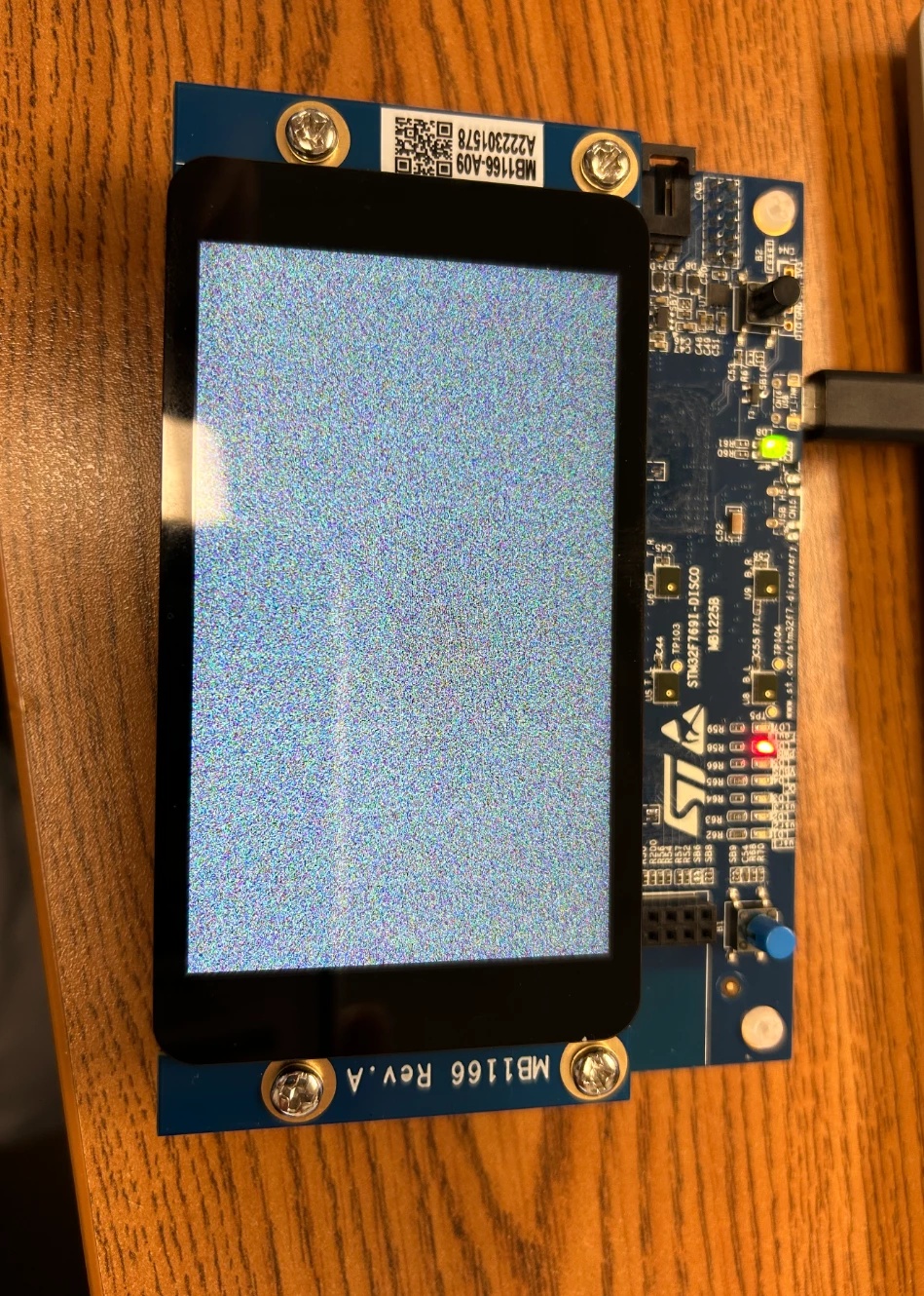

I attempted to build the LCD_PicturesFromSDCard project in IAR EW for Arm 9.30.1, and STM32CubeIDE 1.15.1, and successfully built in both IAR EW and STM32CubeIDE.
Upon connecting to the STM32F769NI MCU Discovery Kit and running the application with both IAR EW and STM32CubeIDE, I was met with static displayed on the screen (please see attached image).
Have you seen a similar error in past troubleshooting? What was the build error you observed in Keil 5.38.0? What version of the STM32CubeF7 software package were you running to successfully display an image?
Thank you.
Tesla DeLorean
Guru
May 14, 2024
Image looks to be random frame buffer.
Make sure SDRAM is started and cleared.
Check .BMP files supports (resolution / colour depth) by the application

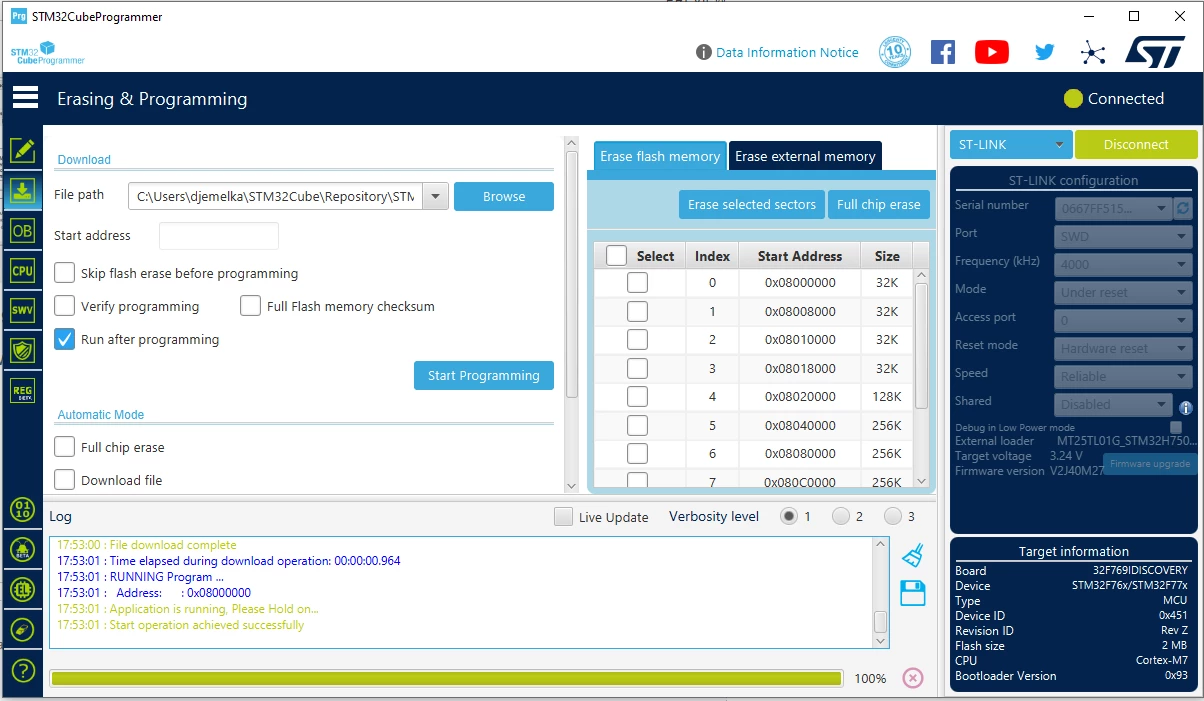

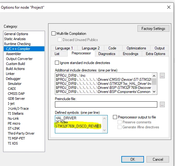

Hello @amattes ,
Are you able to run any LCD example STM32CubeF7/Projects/STM32F769I-Discovery/Examples/LCD_DSI at master · STMicroelectronics/STM32CubeF7 · GitHub?
Please make sure that you used "USE_STM32F769I_DISCO_REVB03" in defined symbols.
I'm using  IAR EW for Arm 9.20.4 toolchain.
Could you please try to download the LCD_PicturesFromSDCard example using STM32CubeProgrammer and .hex file in the attachment.
I hope this help you.
