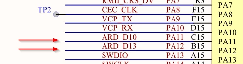

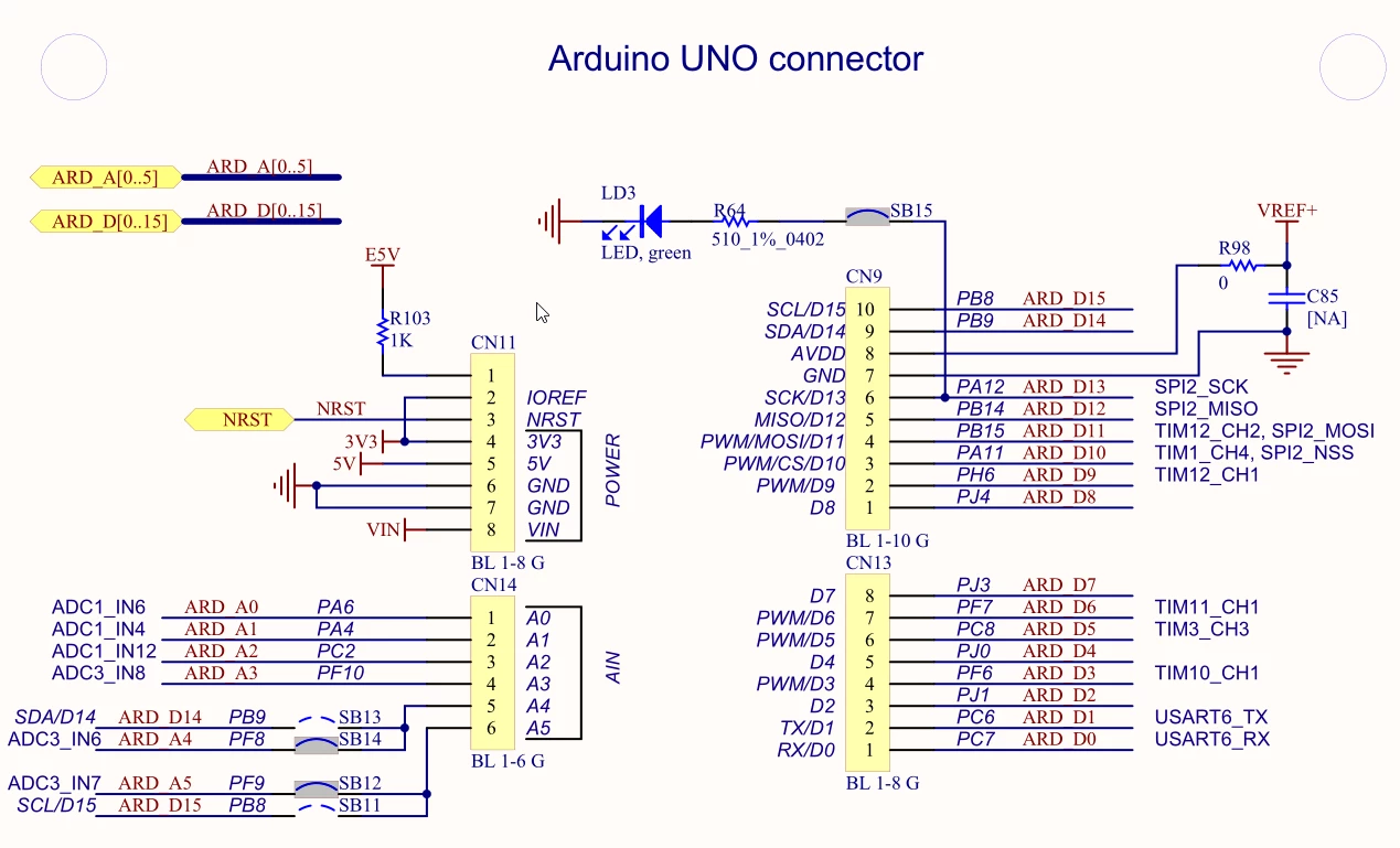

BViet.1
BViet.1Author
February 2, 2022
Yes it's my first post with this account. Have a new job, so my old account is not working anymore ;)
GPIO read and write on these pins are working as expected. I measured the output voltage levels with an oscilloscope and debugged the input levels during pin reading.
I've added a picture of the Arduino connector and the pinout of MCU.
