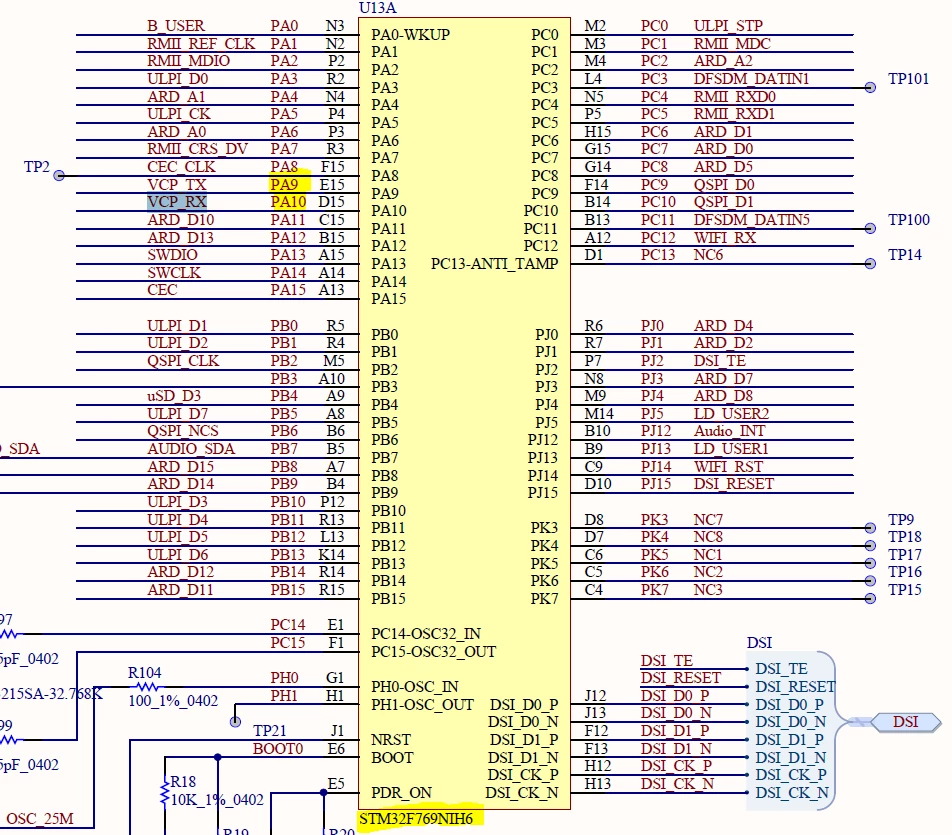

Posted on February 22, 2017 at 07:46
Hello IMEN,
I checked these already. In UM2033, page 20, 6.15 it is said that 'The serial interface USART3 is directly available as a virtual COM port of the PC,'. But according to the schematics, the virtual COM port is connected to USART1(I verified it too).

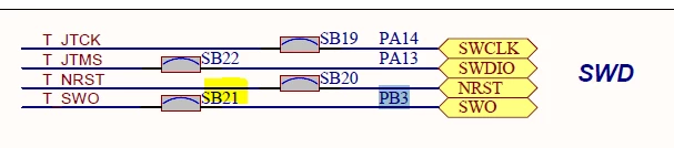

Check if there is any solder-bridge configuration on the board impacting the connectivity of PB3 (SWO) to the ST-LINK portion of the board.

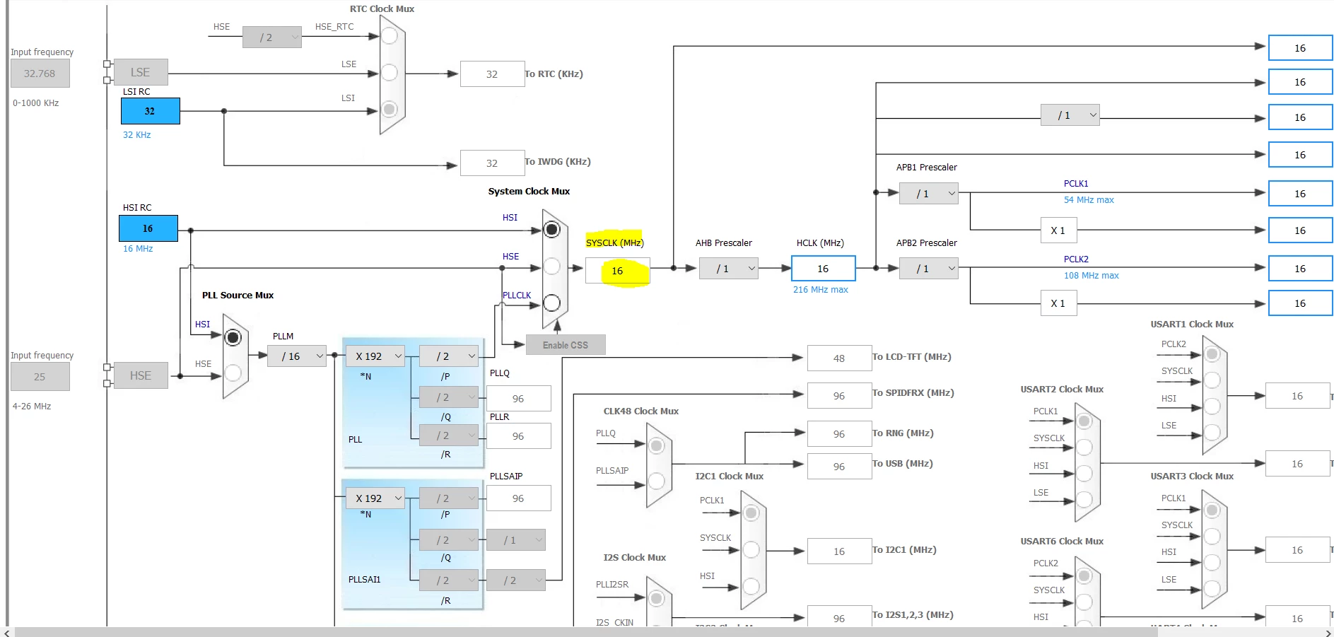

Check that the core is actually running at 216 MHz.

Thanks for replying. I looked at the schematics and PB3 is connected to SB21. I believe that SB21 connection is already soldered isn't it?
I checked the clock configuration in cubeMX and it is as follows. I tried setting the System clock to 16 MHz and added these lines in __write() function.
volatile uint32_t *ITM_LAR = (volatile uint32_t *)0xE0000FB0; // ITM->LAR
*ITM_LAR = 0xC5ACCE55; // Enable Access
Still I didn't see cannot see any output. I am not sure how you got to these 2 lines above?
Regarding this ''
You could try using the USART/VCP method to output diagnostic information, that's how I'd confirm the internal configuration on the F7 NUCLEO boards.
In the schematics, the VCP_RX and VCP_TX are connected to PA10 and PA9 respectively. So I configured PA9 and PA10 as USART1_TX and USART1_RX respectively. Then I configured USART1 and was able to print using HAL_UART_Transmit(). I was able to see the output via virtual COM port.
Now how to output the diagnostic information you asked?
jose239955
September 1, 2017
Posted on September 01, 2017 at 19:07
You have to solder R92 (between the the SD card connector and the MCU)
Explorer
January 14, 2025
This was the fix ^^^
