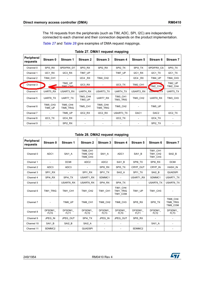

STM32F769 PWM using DMA on two channels PA2 and PA3 issue
I have an issue with using two channels of DMA to generate the PWM on PA2 and PA3 pins.
I configured using CubeMX TIM2 PWM Generation CH3 and CH4.
I have added the DMA memory to peripheral for PA2 DMA1Stream1 and for PA3 DMA1Stream6.
The issue I have is that only the DMA1_Stream1_IRQHandler is called and only the PA2 PWM generation is done. DMA1_Stream6_IRQHandler is never called.

I don't speak the Cube/HAL gobbledygook, but
   /* Set the parameters to be configured */
   hdma_tim1.Init.Channel = DMA_CHANNEL_4; /* PA3 TIM2_CH4 */
is IMO incorrect, I believe you want to set the channel in given stream in DMA, corresponding to given trigger from TIM, ie.
Reading out and checking the DMA registers is always the ultimate way to find out what the mcu is actually doing.

As I see in HAL_TIM_Base_MspInit() i get a warning
/* Several peripheral DMA handle pointers point to the same DMA handle.
    Be aware that there is only one stream to perform all the requested DMAs. */
I am trying to set-up two DMAs on PA2 and 3 which are both on DMA1 Channel 3 and only the stream is different (Stream1 for PA2 and Stream6 on PA3).

waclawek.jan
Feb 6, 2020 5:23 PM UTC
Okay, so this may be a Cube/HAL limitation.
Ditch Cube, go for the registers.

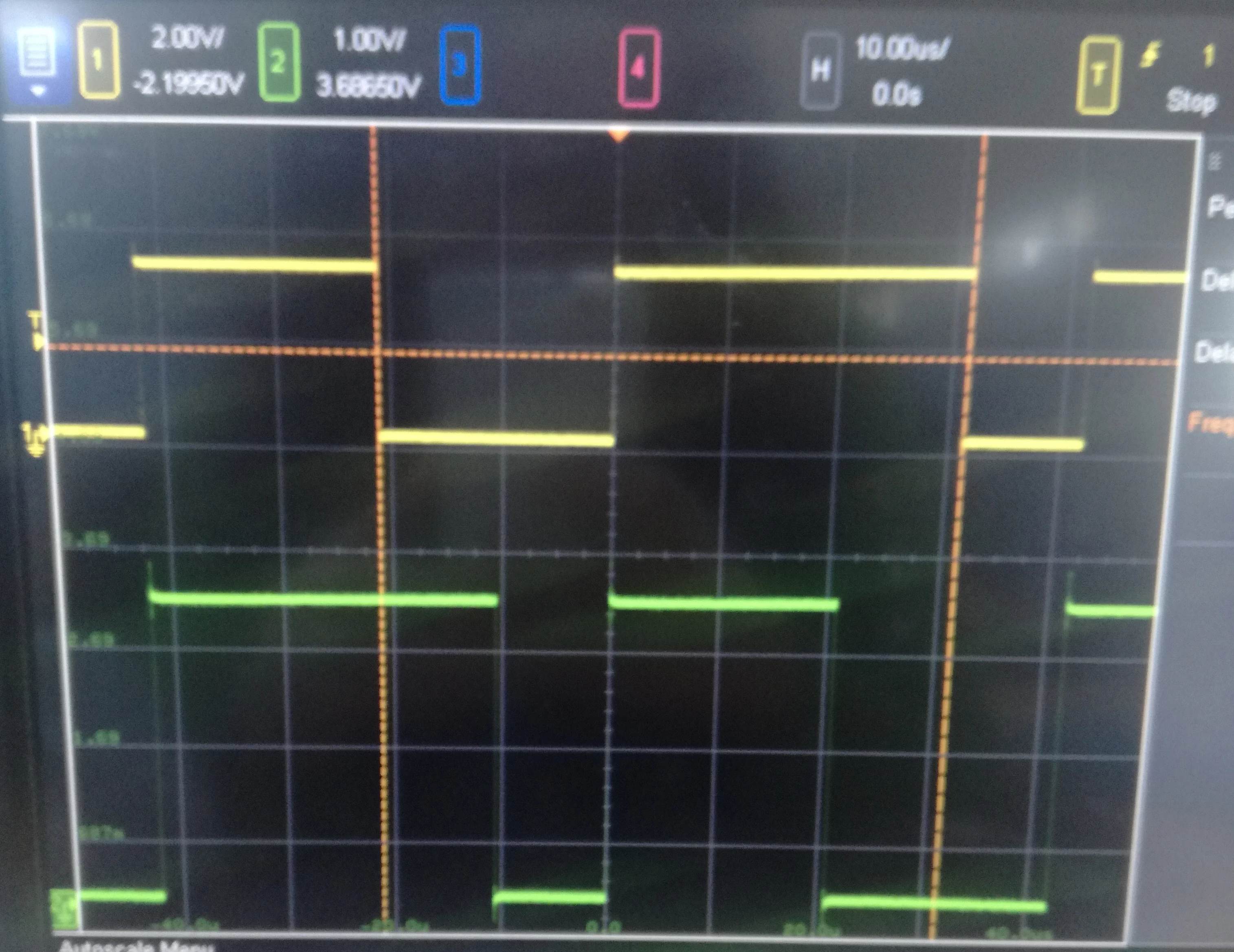

Feb 7, 2020 6:20 AM UTC
​Hello,
I have managed to set-up the desired PA3 to use DMA but only with Steam7.

hdma_tim.Init.Channel = DMA_CHANNEL_3; /*PA2 and PA3 have the same channel*/

The CubeMX is blocking selecting both CH3 TIM2_CH3 (Stream1) and CH​4 TIM2_CH3(Stream7)...
waclawek.jan
Feb 7, 2020 9:12 AM UTC
Oh, that's an unexpected twist.

I succeeded to generate PWM using DMA for both TIM2 channels on PA2 and PA3.
You find attached the compiled code I used.

​Ok, thank you. It works now. I have used different variables in the code (initiated in tim.c with a name and used it in DMA_Config, another variable) and it was not the same addresses :D
Now it is working.
