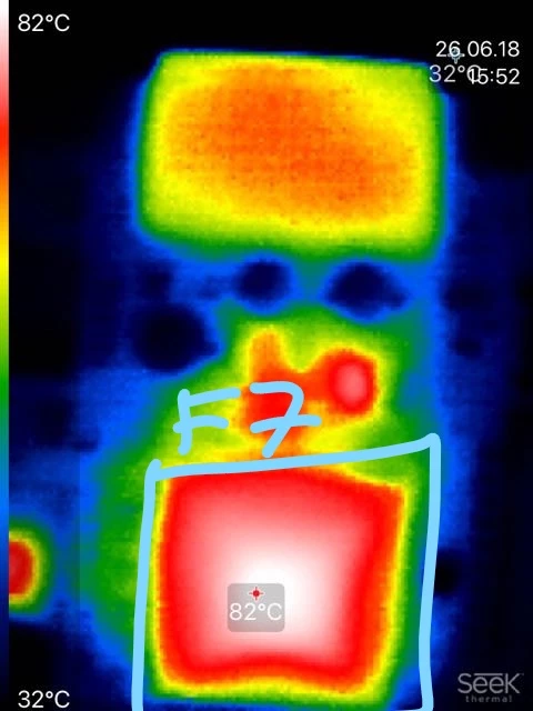

Hello, I have a PCB with LCD, SD-Ram, QSPI, CAN bus, SD card and everything works fine.
I use a STM32F769Bi (208pins LQFP).
Now I think the temp of the STM32F7 is very high (80-85deg).
Normally I work with Stm32f103 and have no temp problems.
(practically no temperature increase).
Does anyone have experience how much temperature is ok or do I have a PCB problem?

Dear Gentleman,
That  behavior is not normal and you should have an issue somewhere. Having a temp offset of 50 between TC ( case) @82 and 32@ board .  That means more than 1W of PD ( Power dissipation) which is exceeding 1053mW of our LQFP208 package !  Please check your PCB , software configuration of I/Os , short cuts. Etc.
Good luck and let us know.
Cheers,
STOne-32

Sorry don't have a thermal camera, perhaps you can do a comparative loading test with a F7 NUCLEO or DISCO board.

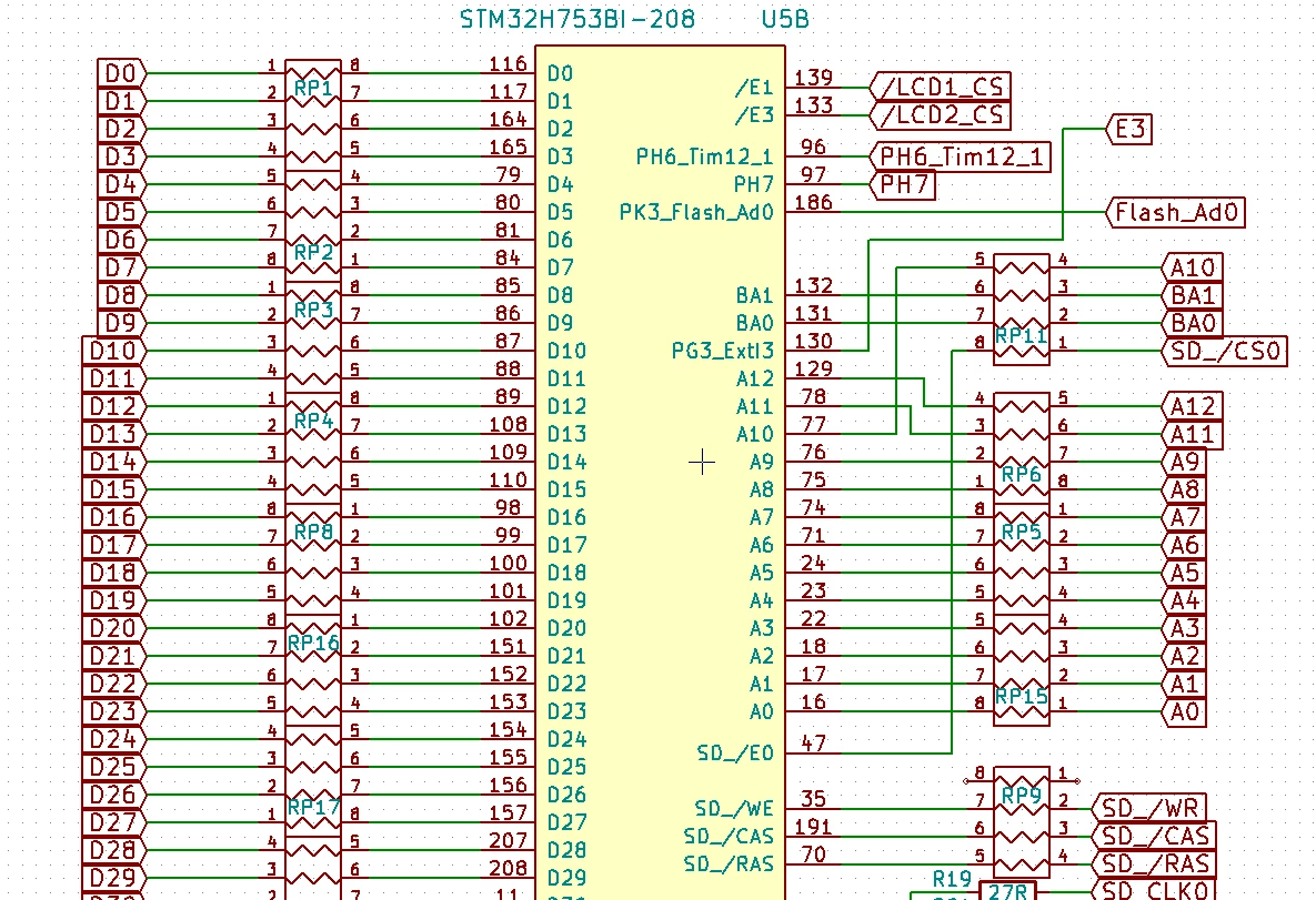

Of course its going to get hot.
with LCD and SDRAM, you are pounding the bus matrices.
is it your custom board ?
easy fix use a heatsink, biggest possible within the package
The proper fix is inline resistors on every high frequency line:
      data/address lines and Qspi lines ( nSS not needed)
      LCD too maybe... definately the LCD clock pin
I use 27R or 33R, upto 100R should be ok.
These are 4x33R packs. like this one
https://www.digikey.com/product-detail/en/rohm-semiconductor/MNR04MRAPJ300/RHM1349TR-ND/4083230
The advice is to place the resistor as far away from the processor as possible.
