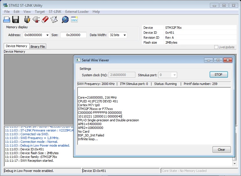

Hi
 I am using Atollic studio and the STM32F769 Discovery board.
I removed resistor R93 and fitted a 0R link to R92 so that the SWO line is connected to the ST-Link on the discovery board.
I have followed this tutorial to enable SWV and make use of ITM_SendChar:
http://blog.atollic.com/cortex-m-debugging-printf-redirection-to-a-debugger-console-using-swv/itm-part-1
I have enabled SWV and set the core clock frequency: currently 200MHz. (I verified this by calling SystemCoreClockUpdate() and checking the value of SystemCoreClock 200000000)
I have set the SWO clock to 2000kHz.
Unfortunately i do no receive any characters in the SWV console window within Atollic.
If i breakpoint the ITM_SendChar function i can see that its getting to the line 'ITM->PORT[0U].u8 = (uint8_t)ch;' without issue.
I also just tried the 'STM32 ST-Link Utility' with SWO viewer and can see a few characters when I press start but do not see a continuous stream of characters as i expect.
Anyone have a suggestion?
Thanls
Chris

              The firmware version I had on the ST-LInk was V2.J30.M19 but it seems to have issues with SWO.
              I just reverted back to V2.J29.M18 and SWO is now working fine

    Tesla DeLorean
    Guru
    Mar 5, 2018 6:21 PM UTC
    Posted on March 05, 2018 at 18:21
    Ok, so not exactly an oranges-to-oranges comparison, I did bring up one of the Nucleo-F767ZI boards where I output to the USART and SWV, no mag-ic incantations involved.

    Tesla DeLorean
    Guru
    Mar 5, 2018 5:45 PM UTC
    Posted on March 05, 2018 at 18:45
    Attached is an example that should output via VCP USART and SWV at 200 MHz
    I've removed the code touching the SDMMC, but it does initialize the screen. It should allow for SWV provided SWO is connected all the way through to the ST-LINK

    Chris Lynch
    Mar 5, 2018 5:53 PM UTC
    Posted on March 05, 2018 at 18:53
    Clive,
               I just tried your code and the VCP works fine.
               The display also inits and has text.
               But still nothing out of SWO, do you have text continuously transmitted on the VCP and SWO?
              I only see text on VCP after reset.
    Chris
    Chris Lynch
    Chris LynchAuthorBest answer
    Mar 5, 2018 6:31 PM UTC
    Posted on March 05, 2018 at 19:31

    Chris Lynch
    Mar 6, 2018 9:31 AM UTC
    Posted on March 06, 2018 at 09:31
    Pavel,
               Thanks for asking.
                Yes they did, but i only received about 4 characters when i should have received a character every 100ms.
               See my answer above regarding the ST-Link firmware as the actual problem.
