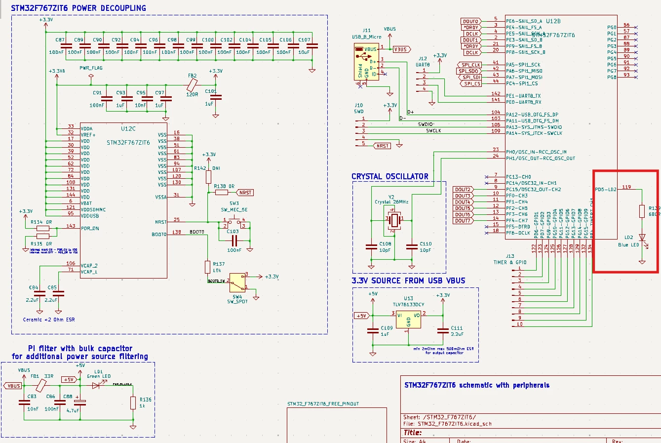

Yeah, sorry not familiar with your board design, attach schematic or portion thereof
HSE_VALUE established correctly?
PLL working? Skip SystemClock_Config() let it run from HSI
LED to VCC or GND?
VCAP capacitors present and correct? See 1.25V there?

Sorry, below is my schematic for stm32. I marked LED that I was talking about with a red box.

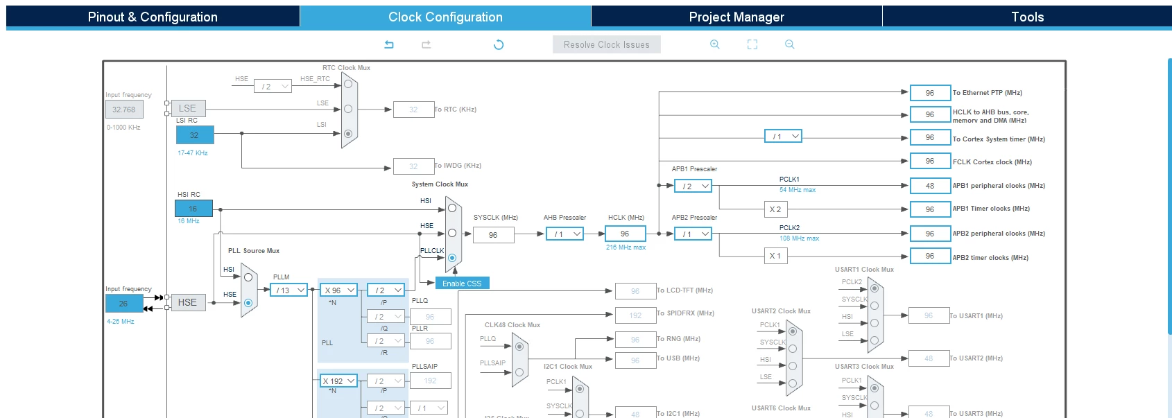

This is my clock config. I tried using HSI and result is the same.

Not sure why one ST-LINK would work vs another. Is your board self powered, or from the ST-LINK?
Nothing immediately jumping out from the schematic as problematic
