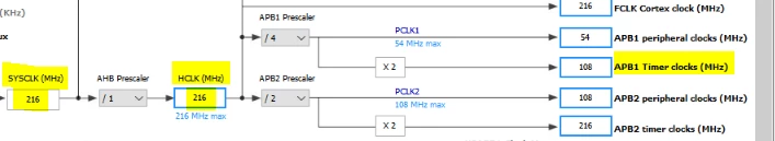

I am having some difficulties wrapping my head around what's happening with my TIM3 interrupt.  I am creating a timer class for my application.  It needs a 1 microsecond resolution.  For some reason I can only achieve a 2 microsecond resolution.  I started with the STM32F7Cube TIM_Base example for this Nucleo board.  The system core clock is 216MHz.  I have hopefully followed the instructions for configuring the timer using the method from the MCU documentation:
Update_event = TIM_CLK/((PSC + 1)*(ARR + 1)*(RCR + 1))
My code is as follows:
// Initialize TIMx peripheral as follows for a 1us tick (1MHz):
// + Period = SystemCoreClock/1000000 - 1
// + ClockDivision = 0
// + Counter direction = Up
TimHandle.Init.Period = (SystemCoreClock/TICK_RATE_HZ) - 1; // TICK_RATE_HZ = 1x10^6
TimHandle.Init.Prescaler = 0;
TimHandle.Init.ClockDivision = TIM_CLOCKDIVISION_DIV1;
TimHandle.Init.CounterMode = TIM_COUNTERMODE_UP;
TimHandle.Init.RepetitionCounter = 0;
TimHandle.Init.AutoReloadPreload = TIM_AUTORELOAD_PRELOAD_DISABLE;
if (HAL_TIM_Base_Init(&TimHandle) != HAL_OK)
/* Initialization Error */
Error_Handler();
//##-2- Start the TIM Base generation in interrupt mode ####################
if (HAL_TIM_Base_Start_IT(&TimHandle) != HAL_OK)
/* Starting Error */
Error_Handler();
Many thanks in advance!

    If the clock runs at 108 MHz then the period needs to be 107 ie 108-1 to get to 1us (or 1 MHz)
    Interrupting at MHz rates is not recommended, it will burn a ridiculous number of cycles, more so with HAL.
    If you want clock signals, use the TIM to generate the signal in HW, not with interrupts.
    1 MHz 0.5us width, Prescaler = 0, Period = 107, Pulse = 54 (50/50 Duty), PWM Mode
    500 KHz 1us width, Prescaler = 0, Period = 215, Pulse = 108 (50/50 Duty), PWM Mode

    On a general note, check the top level clock tree feeding the timer block diagram to see if there is a div2 prescaler not shown at the timer block diagram level.

    Like KIC8462852 EPIC2024278916 wrote, check the clock source.
    But you measured 50% only of the period. So in your case it is 1/4 of the desired frequency
    and not a div2 prescaler.

    Thank you both for the analysis.  I took the existing example for TIM3 from the STM32CubeF7 example project and verified the clock source for TIM3.  In this case TIM3CLK = PCLK1*2 where PCLK1=HCLK/4.  Using that information TIM3CLK = HCLK/2 = SystemCoreClock/2.  For this target the SystemCoreClock is 216 MHz.  As a result TIM3CLK is 108 MHz.
    Is there something I'm missing?  I've played with all sorts of permutations of the Prescaler and Period but can't seem to achieve the 1us period I need.  I even found a clock calculator from Mikroelectronica.  Their ARR and PSC values correspond with what I calculated (PSC = 0, ARR = 215) but I still don't have the right 1 us clock rate desired.
    Many thanks for any other tips.

    Thank you for providing the report.  I too was able to get a 2us pulse width, originally.  My desire is to get a 1us resolution (ie pulse width).  If this is not possible then is there an explanation for that?  The best I can seem to do is this:
