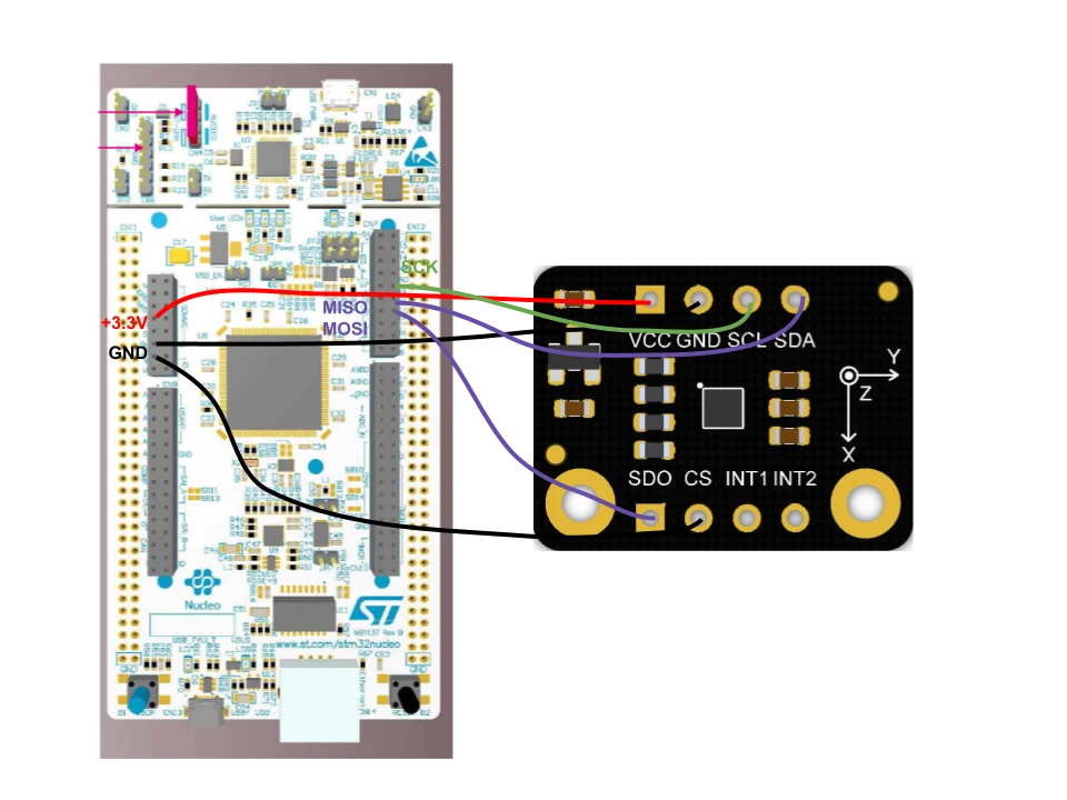

To test the communication between my microcontroller and my accelerometer, I try to read the WHO_AM_I register of the LIS2DW12. This register is a read-only register. Its value is fixed at 44h. Unfortunately I can't read this value but I read FFh. First of all, so that you can confirm that I haven't made an error of connection, here's how I connected my accelerometer to my nucleo-board :
Accelerometer connections.pngI just connected the accelerometer to the supply (+3.3V & GND) and the 4 SPI wires.

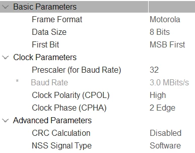

Then, I configured the SPI communication in CUBEMX according to the LIS2DW12 datasheet :

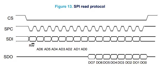

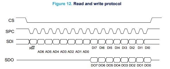

I wrote a simple code to read value of the register WHO_AM_I using the function HAL_SPI_TransmitReceive.  According to the datasheet, to read this register (address 0Fh), it must be sent a byte with the value of the address register and a 1 as MSB -> 8Fh.

OK, you configure "MSB first". But are you sure that SPI mode is correct?
(looks like SPI mode 3 needed and you have it this way, I think)

GuilinuxAuthor
May 11, 2024
Yes, I connected a ground wire to set nCS on external SPI slave low all the time. On the datasheet, it is indicated that the CS pin must be 0 to use the SPI interface, and 1 for i2c. It's the reason why I connected it to a ground wire to have 0 on CS.
But in reality, the accelerometer want to see a new nCS cycle as you told me. I had already tried to connect CS to a GPIO before my post but it didn’t work. I try again and now it's working ! So the first time, I think I tried with another SPI configuration (which was wrong). Thank you for your advice !
