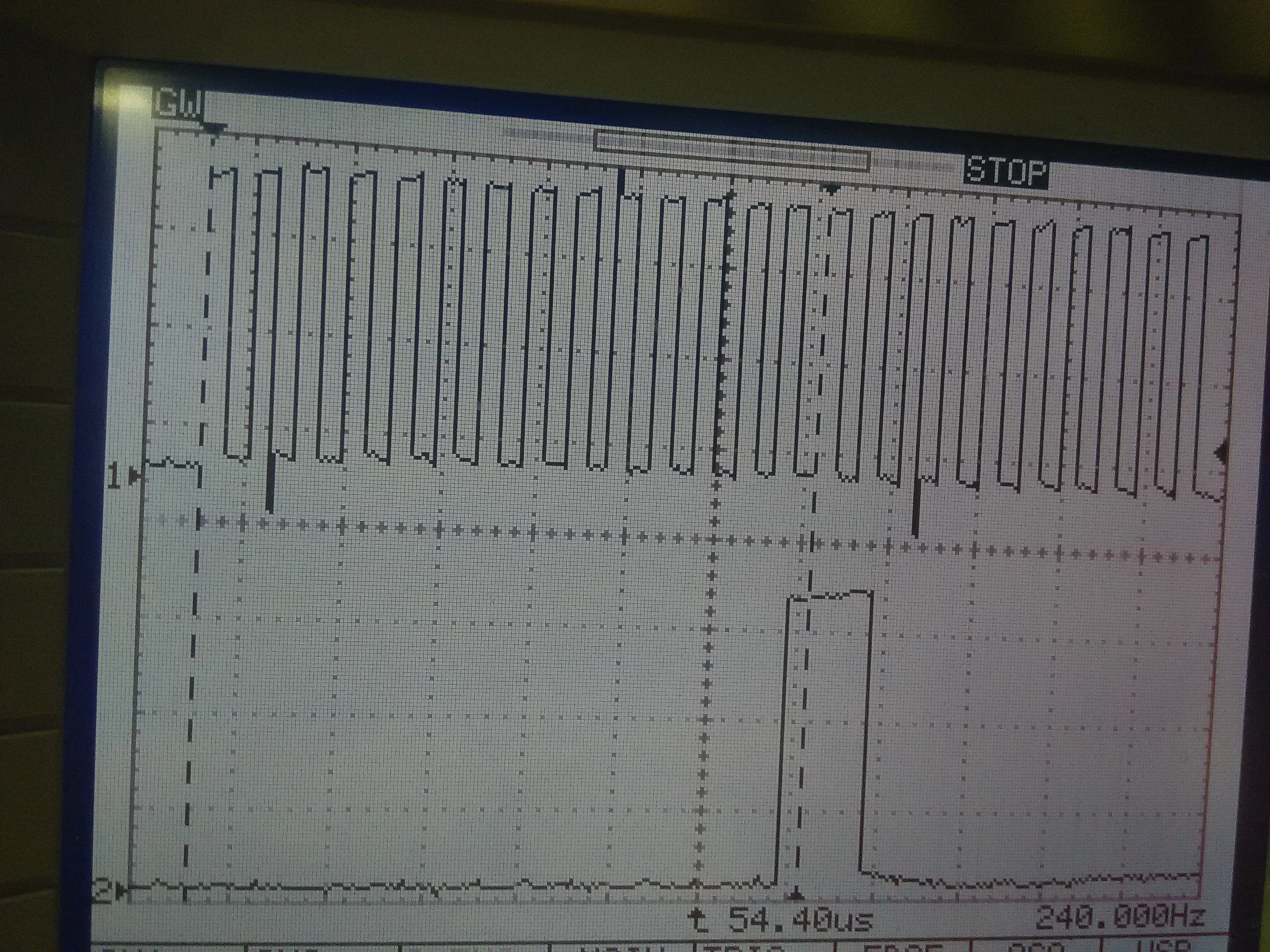

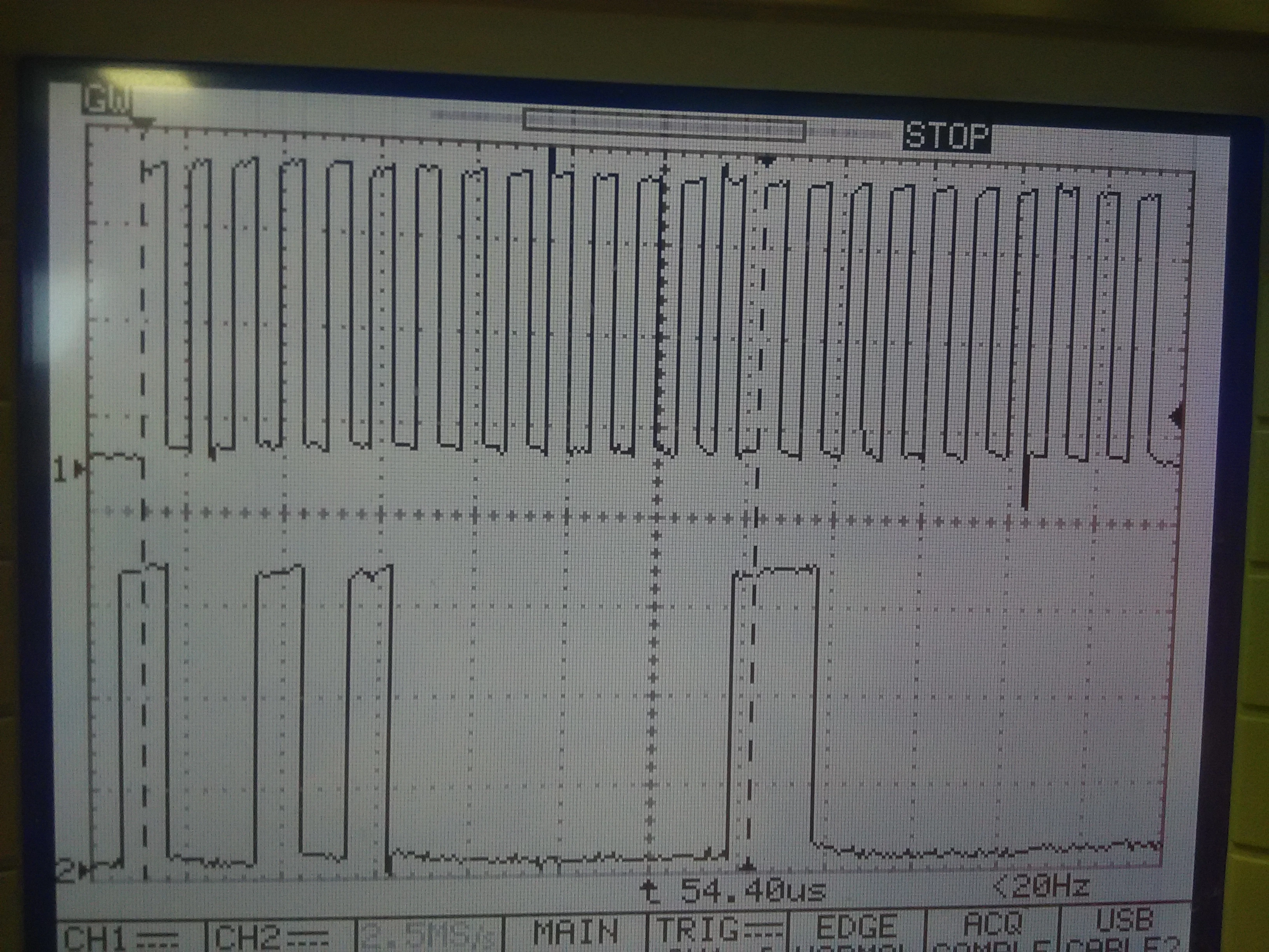

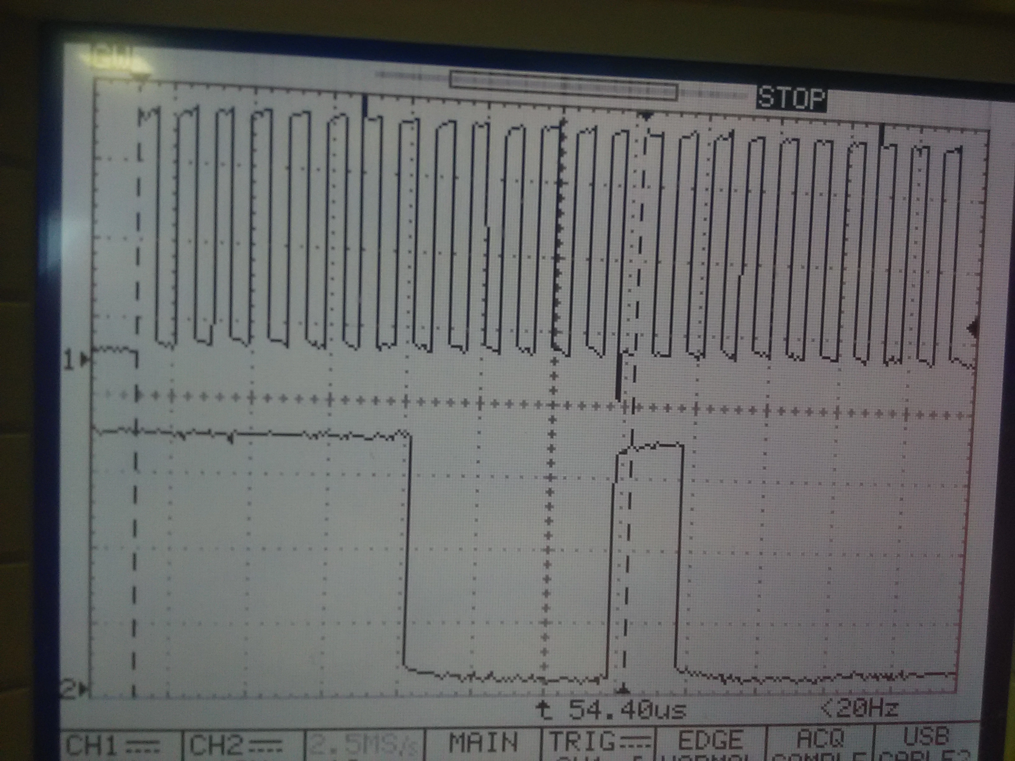

Hello. I work with stm32f767ZI nucleo-144, and try use QUAD SPI bank1 to access W25Q128BV. All OK when i use 1 wire or 2 wire(dual mode), but when i use quad mode(4-wire), something went wrong.
SPI Pins:
            PE2     ------> QUADSPI_BK1_IO2
            PB2     ------> QUADSPI_CLK
            PD11     ------> QUADSPI_BK1_IO0
            PD12     ------> QUADSPI_BK1_IO1
            PD13     ------> QUADSPI_BK1_IO3 and i checked PF6
            PB6     ------> QUADSPI_BK1_NCS
All wires work except PD13(PF6).
I Use Instruction - 1 Wire(0x94)
Address - 4 wire(24 bit all zeros)
Alt Bytes - 4 wire (8 bit 0xFF)
Dummy Cycle - 4 times
Data - 4 wire(wait for 2 byte)
Maybe I missed something.
I will be grateful for the ideas.
Sorry for English

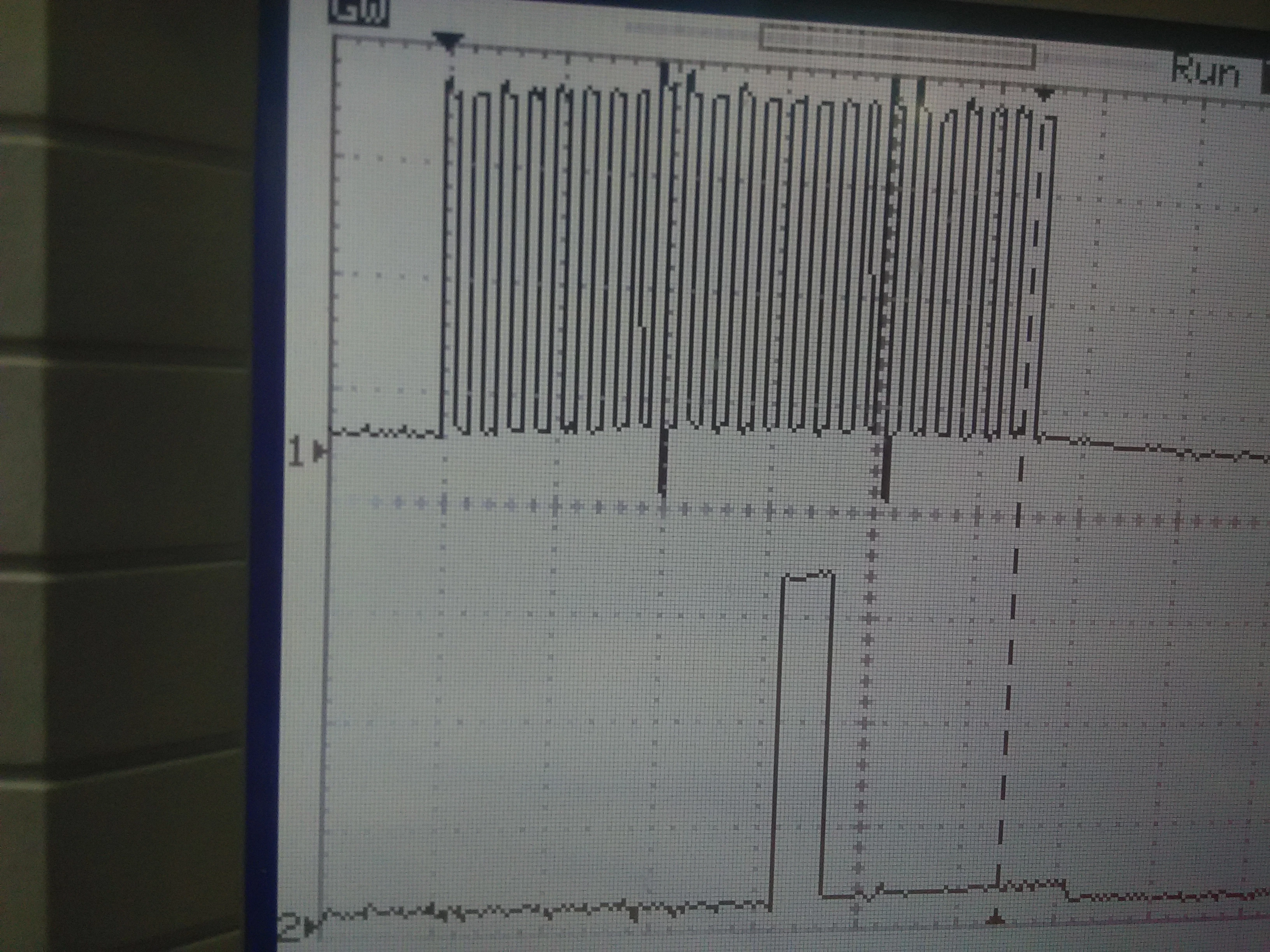

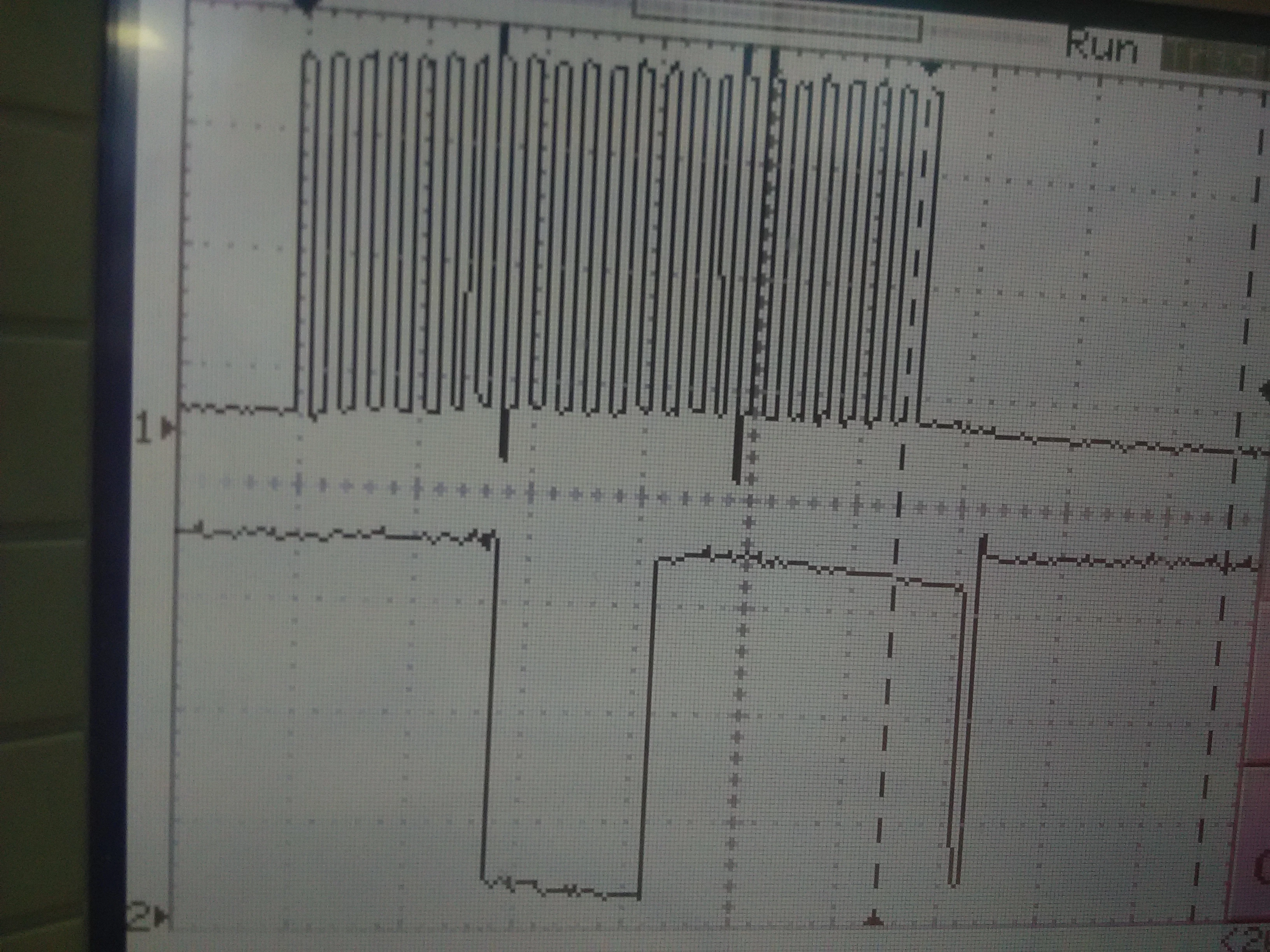

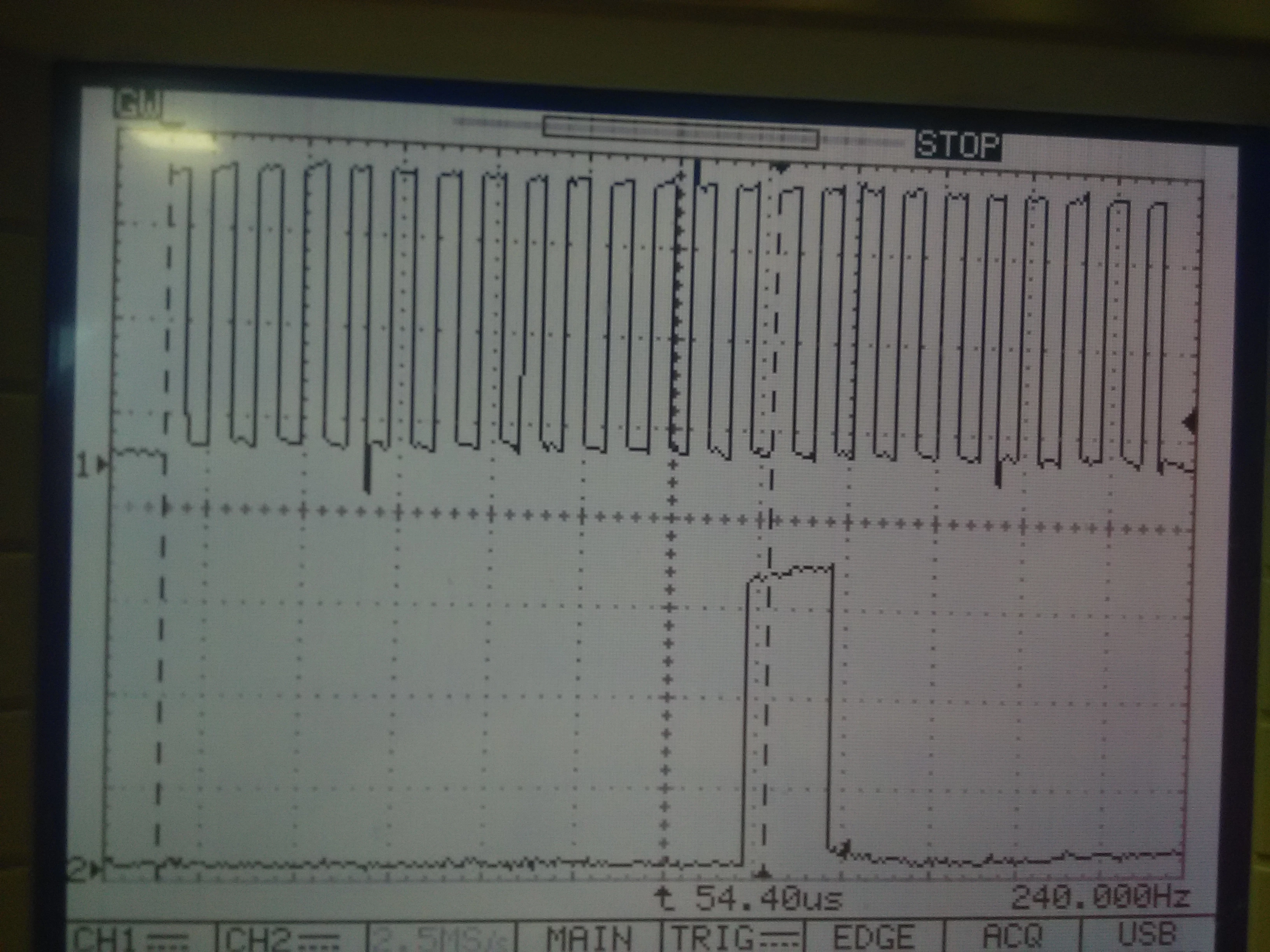

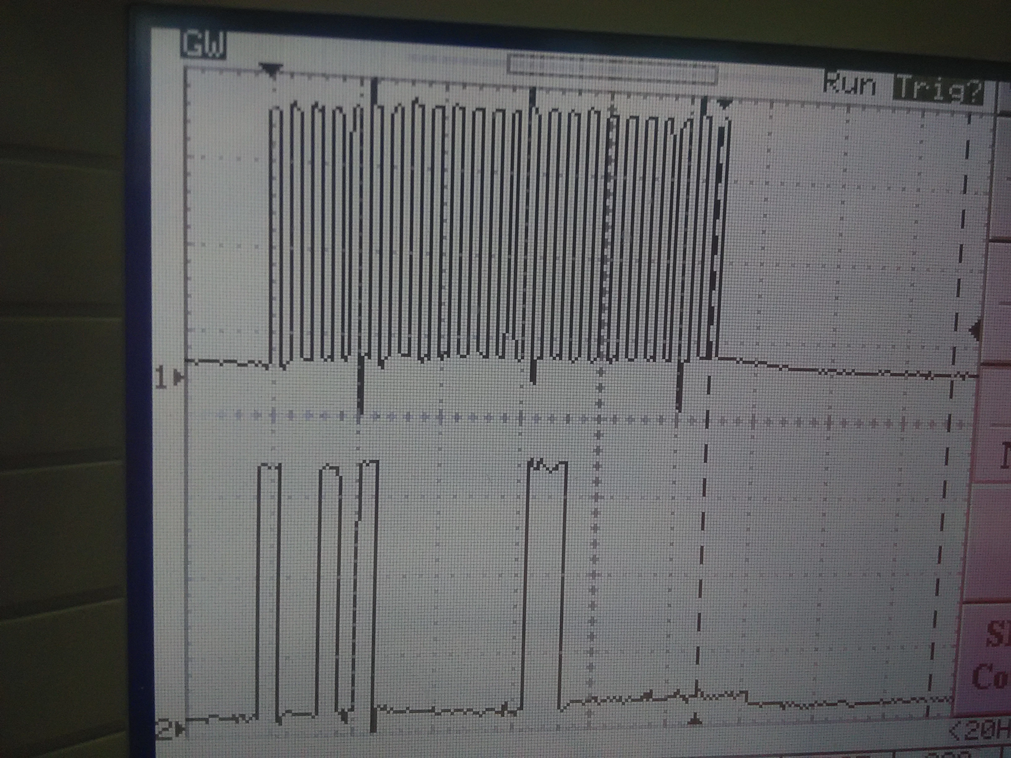

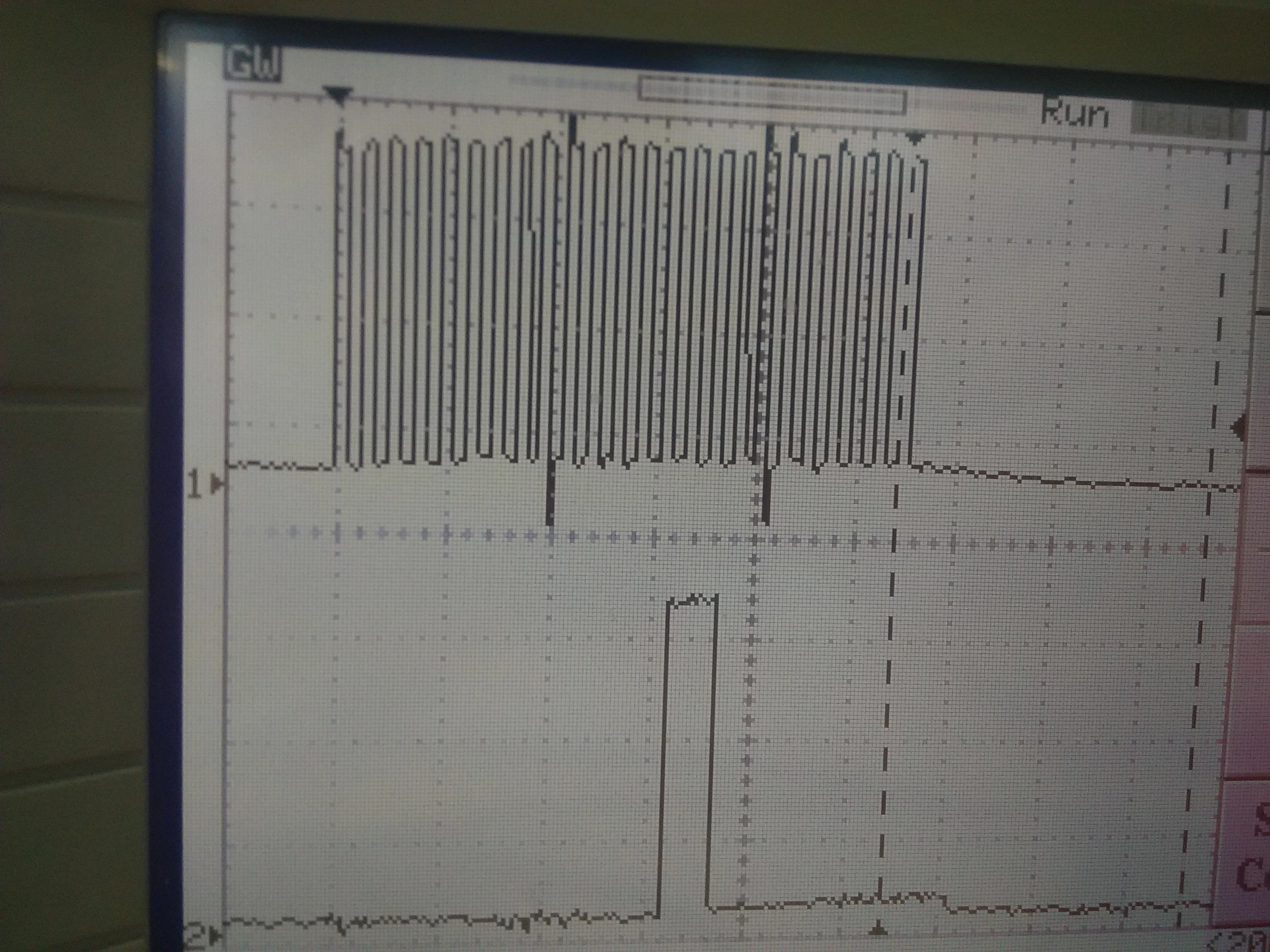

OK, i check errata sheet
http://www.st.com/content/ccc/resource/technical/document/errata_sheet/group0/23/a6/11/0b/30/24/46/a5/DM00257543/files/DM00257543.pdf/jcr:content/translations/en.DM00257543.pdf
(2.12.1 ), then i replaced dummy phase by alt bytes:
Alt Bytes - 4 wire (24 bit 0xFF0000)
But n
othing happens
, i attach new image, because something change on BK1_IO3.
And i attached code where i use HAL to access QUAD SPI.

The image does not match the documentation.
https://community.st.com/external-link.jspa?url=http%3A%2F%2Fnice.kaze.com%2FW25Q128BV.pdf
7.2.33 Read Manufacturer / Device ID Quad I/O (94h)
Daniil Lukashevich
Aug 16, 2017 9:02 AM UTC
Posted on August 16, 2017 at 09:02
Could you check out the new images and tell me where the discrepancy is?
AVI-crak
AVI-crakBest answer
Senior
Aug 16, 2017 9:04 AM UTC
Posted on August 16, 2017 at 11:04
The transfer of control commands beyond the first hardware access to memory - looks the same as in the documentation, but with a slight change. The low byte is transmitted / read first, just like all data.
Reading registers of external memory can give a faulty answer (at first glance), but it is serviceable - just not in the right order.
We want to see how in the documentation x0.x1.x2.x3
We get x3.x2.x1.x0 - one big word in 32 bits.
There is no coincidence with the documentation, the number of cycles is equal to the command + address. The reading of the data was omitted.

Daniil Lukashevich
Aug 16, 2017 3:27 PM UTC
Posted on August 16, 2017 at 15:27
I just made a record in the status registers, like you have in the attached file and the 0x94 command worked, thanks.
Later I noticed that in the documentation for SPI flash this is reflected in the paragraph '6.1.3 Quad SPI Instructions' at the bottom.
For today, reading ID is all I needed, thanks for help.
