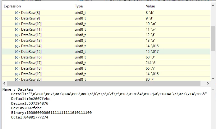

Problem:
Using AES 256 in CBC mode attempting to encrypt block of data on the Host which is the PC, and decrypt that same block on the MCU using the CryptoLib. Encryption on host is done correctly, decryption of the first block of data is done correctly on the MCU, but decryption of the second block of data fails(Bytes 16-31). Below is my test code.

aeserror = AES_CBC_Decrypt_Init(&aesCTX, (uint8_t*)KeyTemp, (uint8_t*)KeyIvTemp);
aeserror = AES_CBC_Decrypt_Append(&aesCTX,(uint8_t*)DataEncrypted,32,DataRaw,&aesoutputsize);
aeserror = AES_CBC_Decrypt_Finish(&aesCTX,(uint8_t*)DataRaw,&aesoutputsize);
The decryption only works for the first 16 bytes, fails for the next 16 bytes. The following website shows what the decryption should be
http://aes.online-domain-tools.com/link/eea909ghxsatKRjSA/
This is what i get when i run it.
Which is wrong since the plaintext goes from 0-31.
Anyone know what im doing wrong?

    DataEncrypted[18] = 187; // This should be 184

    Your input data is flawed, using entirely different AES-256 code I get
    0000 : 00 01 02 03 04 05 06 07-08 09 0A 0B 0C 0D 0E 0F ................
    0010 : 44 F4 41 0E 50 24 30 88-55 41 46 07 17 8C 86 F2 D.A.P$0.UAF.....

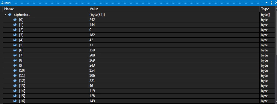

    If you want to try replicate what im doing here is the C# code:
    AesManaged myAes = new AesManaged();
    byte[] IV = new byte[16];
    byte[] key = new byte[32];
    byte[] plaintext = new byte[32];
    byte[] ciphertext = new byte[32];
    for(int i = 0; i < 32; i++)
    key[i] = (byte)i;
    plaintext[i] = (byte)i;
    if(i < 16)
    IV[i] = (byte)i;
    myAes.Mode = CipherMode.CBC;
    myAes.IV = IV;
    myAes.Key = key;
    myAes.Padding = PaddingMode.None;
    // Create a encryption object to perform the stream transform.
    ICryptoTransform encryptor = myAes.CreateEncryptor();
    encryptor.TransformBlock(plaintext, 0, 32, ciphertext, 0);
    And hereare the values of the ciphertext at the end of executing the above:
    Also side note tried _CRC_CLK_ENABLE(); right after the rest of the initialization no difference.
    -Andriy
