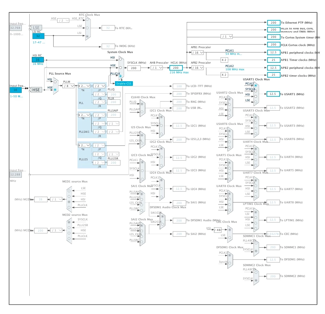

I have issues getting usart1 and spi4 to work..
USART1 "supposedly" work (software side do not complain) but USART1_TX pin is dead, there is nothing exiting this pin, scope shows it is dead. Same on multiple stm32f767zgt6 chips so it is not a dead chip. No clue if I missed something but USART2 works without a problem for e.g.....
With SPI4 I have other problem, sendreceive times out, I don't get how a MASTER SPI can timeout, it does not wait on anything... but it times out... no matter what I try, it always times out .. spi1/2/3 work ok
STM32CubeIDE is what I'm using to configure and program

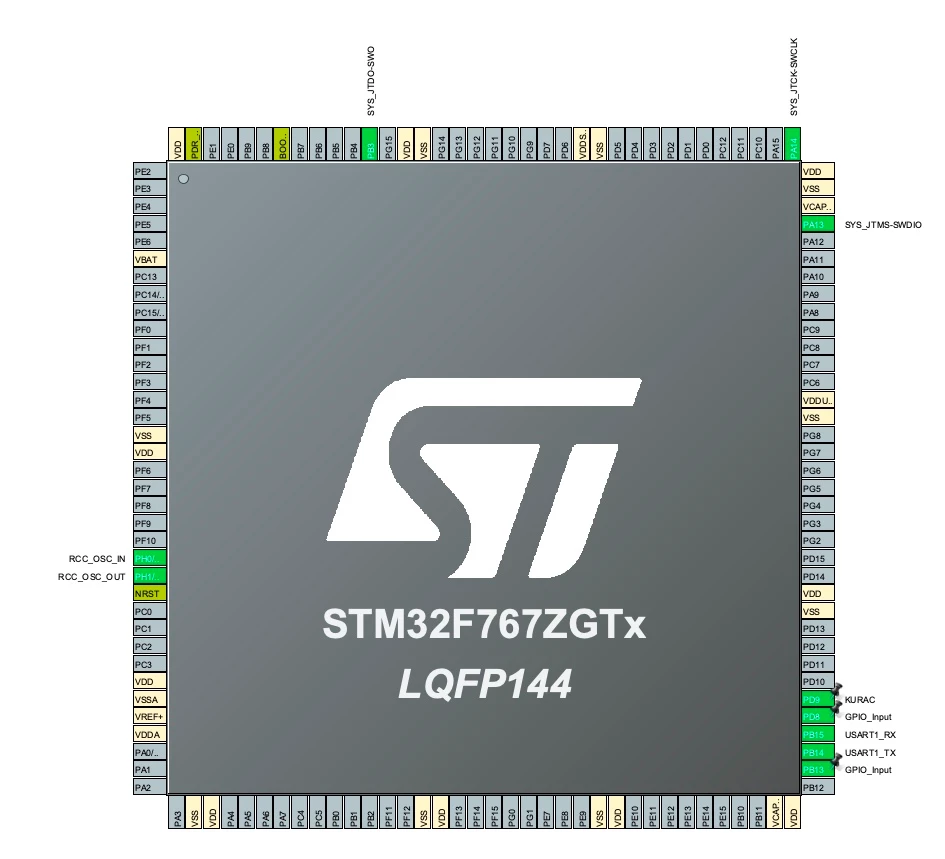

that is some common practice I went through few times, pcb is blank, I cut traces just after the mcu and attached scope to them, a friend with similar board did exactly the same, has exactly the same result with my code...
setup is made by stm32cubeide
this is usart1 .. I set neighboring pins to input to not make a mess if I touch them with probe by accident or short to TX/RX but that's all ..
tried different clock config. even lowered periphery clock a lot to test, nothing changed.. and as I said usart2 for e.g. works ok

USART1 part is solved, 5th inspection of the schematic and board and I found that VDDUSB was not powered (the guy that designed the board assumed he do not need to power it as USB is not used but did not check that some pins, including USART1 pins, use that as power source). This was fixed (patch wire adding power to VDDUSB and small cap directly on pin) and USART1 works like a charm :)
