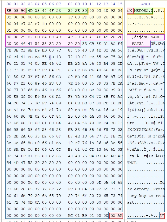

STM32F767 SDMMC DMA read missing first 16 bytes

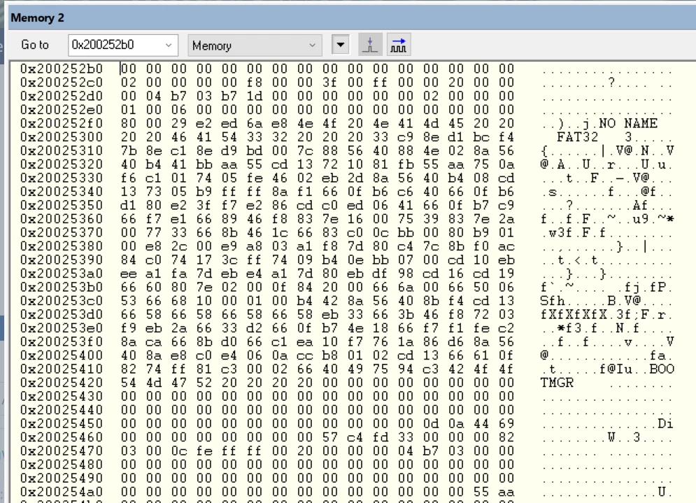

My ongoing difficulties running FATFS on an SD card has uncovered a problem! A read of the boot sector does not read all the data correctly, specifically the first 16 bytes are all zero. This means that FATFS reports there is no filesystem.
The code I'm running is all CubeMX HAL stuff, so I'm at a loss what the problem is. 16 bytes is 1 DMA burst, so that might be significant. Here are screenshots of the SD boot sector, firstly as read by my PC, secondly as read during f_mount() by my STM32F767.

Do the DMA into the DTCM RAM (128K 0x20000000..0x2001FFFF), it is not cached
Otherwise you have to properly manage the coherency

See 16-bytes here as cache is on 32-byte boundaries, ie 0x200252A0, 0x200252C0, 0x200252E0..
This also gets to be VERY dangerous, as ByAddr variants of the DCache commands, as used by ST will have/cause collateral damage

Aargh, I was wondering if it's a caching problem. It's not my code that allocate the FATFS working buffers so it looks like my options are to modify library code or to turn caching off across the board.

Can be handled at the DISKIO or BSP level by aggressively policing the buffer alignment issues.​ Could also decompose the requests, double-buffer, or use polled mode selectively.
S​Ts solution for non 32-bit aligned buffers is to always use the least efficient method, rather than special case the worst, and optimize the other 99.99%

Just a quick update for anyone following this, the suggestion from @Community member​ is looking good and using DTCM for DMA buffers seems to be working.
