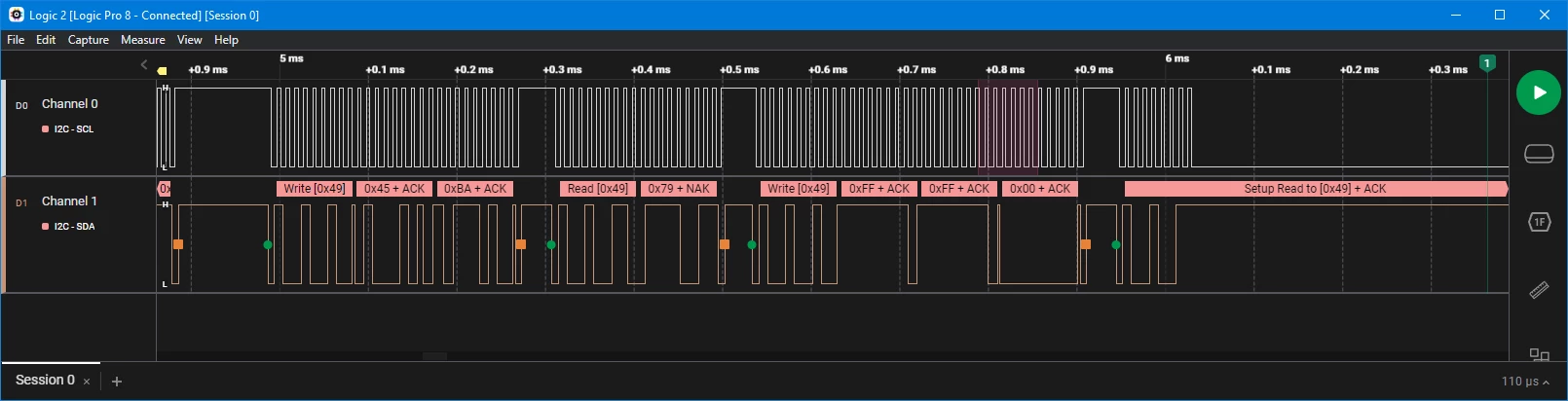

Problem: I2C hangs after issuing Mass Erase command
Send: 0x45 0xBA Erase-NS Command
Receive: 0x79 ACK
Send 0xff 0xff 0x00 Special Erase
Receive for ACK or NAK hangs while sending the I2C device address.

Looks like you eventually get an ACK based on your logic analyzer screenshot. How long does this take? Is the flash erased after this?
Does the regular Mass Erase command work (0x44 0xBB)?

I'd expect it to work, but could take it's time to complete, and might cause the processor to stall and not be responsive to real-time interaction.
June 13, 2025
Ok, I started to make my own tool, and it seems to work now. Takes about 16s for a 2MB part.

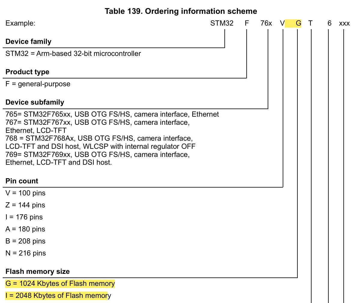

STM32F767 is available with 1MB or 2Mb of flash? How do I know which type I have? The ID is the same for all of them.

What chip do you have? There are more letters after STM32F67 that indicate flash size.

I'd rather like the bootloader client to figure this out automatically.

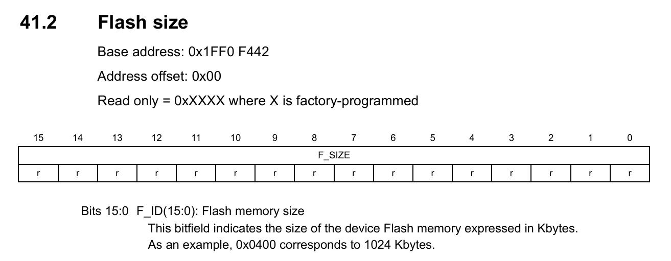

TDKBest answer
June 13, 2025
Read the flash size register.
