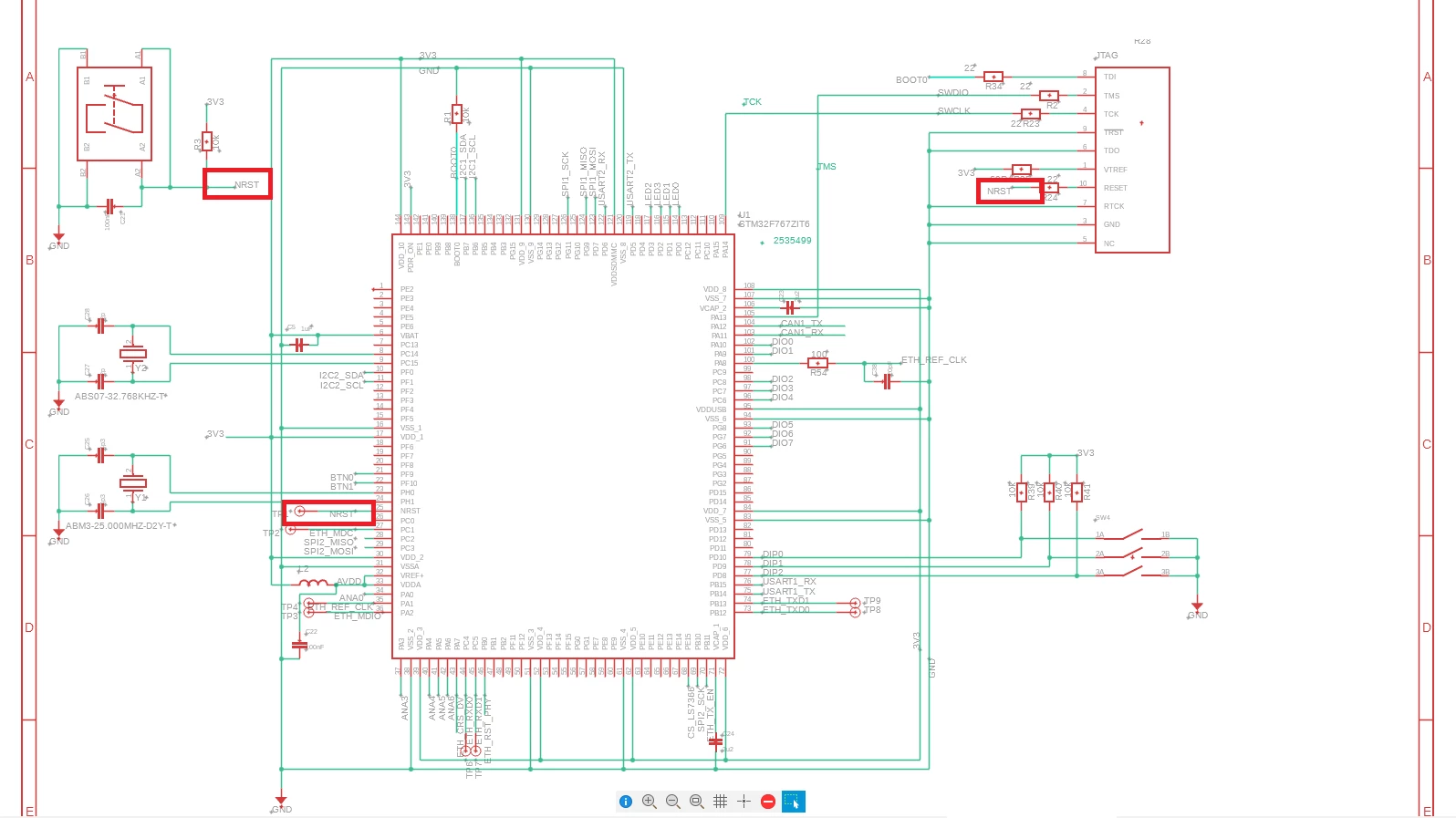

I have a custom PCB based on STM32F767 which has been working for about 2-3 weeks, through about 100 re-programming cycles (doing debugging). Now, after last attempt to flash, the NRST pin is "stuck" to VSS. I lifted the pin of the trace, e.g. NRST pin of MCU is now not connected to anything on the PCB anymore. The PCB's NRST trace is measured to 3.3V, while the NRST pin of the MCU (no longer connected to anything) is now 0V.
If I measure resistance between NRST pin on MCU and VSS pins (connected to GND) i get ~0.5 ohm (probably not accurate reading, but lets call it "low ohmic resistance").
Since the NRST pin is free floating (literally up in the air, off the PCB), and still measured at 0V wrt VSS, it seems the MCU's internal NRST mechanism is now fused to VSS?
This is the second identical board this happened to. The previous board also functioned for weeks, before breaking in exact same way.
I suspect it has to do with I built the ST-Link interface (using spring loaded TAG_CONNECT connetor). I may have disconnected the ST link while the PCB was powered on (though not while flashing, obviously), don't see why that should brick the MCU, but I have no other explanation. I cant see anything obviously wrong in the design thoguh ...
Any help would be much appreciated:
BTW: Measured VDDA to 3.3V and both VCAP pins to 1.13V, PDR_ON tied to VDD(3.3V) and BOOT0 pulled down to VSS by 10k.
Edit: Highlighted the NRST net
Edit: pdf schematic added

The ST-Link pins are connected via 22 ohm resistors, including the pin that goes to the NRST pin on MCU (based on some reference design I worked from). There is no other drive circuit on the NRST other than a 10k pullup and a 100nF debounce cap, which I believe is  correct according to design guidelines? I do have a pushbouton that pulls NRST to GND for hard reset, but with the debounce cap and the pullup, that should be fine, I would think...

Re-reading the design guidelines, I see some mention of potential latchups caused by VddA comming up after Vdd. In my design I power VddA through a ferrite bead (again based on some reference design, which may or may not be good), with  100nF decoupling. I am missing the recomended 1uF additional cap on VddA.
Could a ferrite bead in serries powering VddA cause something like this?
I gues not since the "getting started" guide recomends it (I dont have the 47 ohm resistor t Vref though):

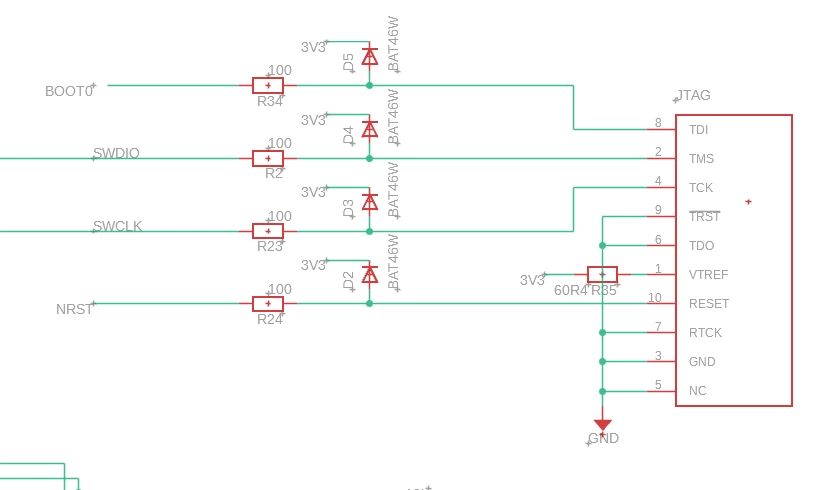

Thanks for the input. I added the missing tantalum cap on VddA and used 100 current limiting resistors in series with the SWD and NRST signals from ST Link. Lets see if that prevents another latchup of NRST :) Curious problem thogugh. Ive not seen damage to MCU's from disconnecting in-circuit debuggers before (assuming ofc thats what this is...).

As for protecting the MCU against this problem, would something like this work?
In my current design (of which two prototypes now was broken due to latching NRST pints) I already have in-line resistors for the SWD and NRST signals (they where 22ohm as per STM's design guide, but I uped them to 100 now). If I clamp all four signals with a BAT46w(0.3 Vf) Schottky, that should prevent the SWG signals and NRST pin of the MCU getting pushed above Vcc.
I see now in the ESD guidelines of STM's AN5612 appnote they suggest another setup for ESD protection using a 4channel TVS, but that would not protect against this specific case where the ST-Link is applying voltage to NRST or SWD pins above the MCU's Vcc (e.g. the PCB is not powered).
Im not too worried about ESD for this project in general as it will be mostly used in lab conditions, so protection against inadvertently messing up the connection procedure for ST-Link debugger is more important.
