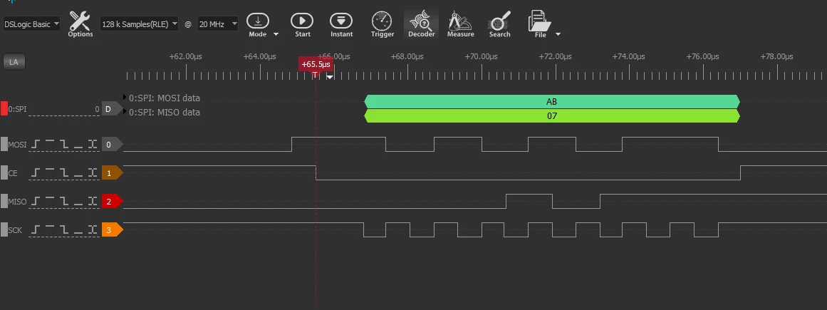

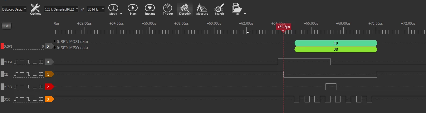

Pilous Droip
Senior
May 30, 2018
Posted on May 30, 2018 at 09:44
I modificated it, and no change ......
How it have to have look:
And here is how it look now:
read_from_reg(SPI1, 0xF0, read);
