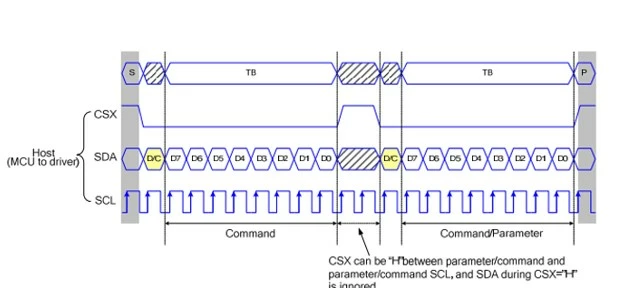

I'm currently using a stm32f767 board and I'm going to try lcd this time.

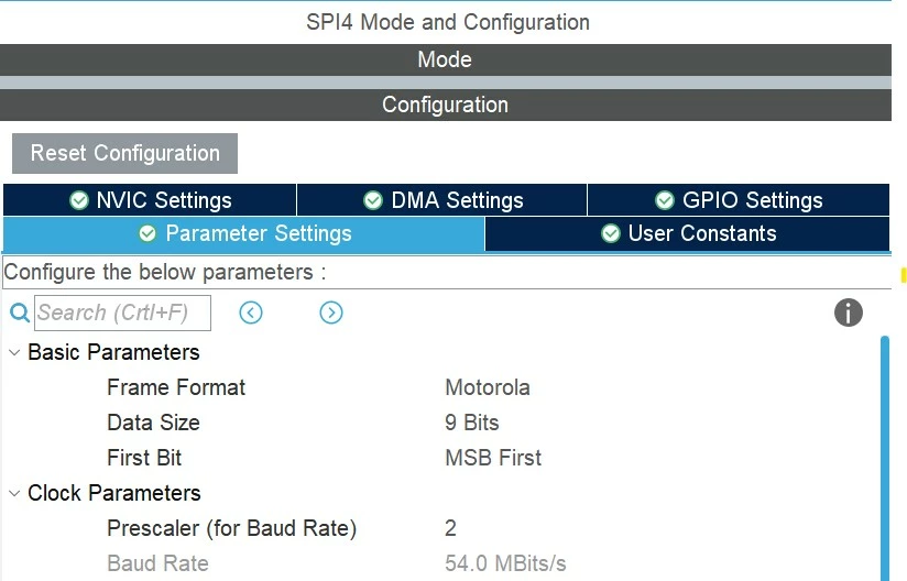

I need to use spi 9bit to write my lcd, but I set the data size to 9bit in the settings window.
I want to implement it as ST7701.
Below is the mode and code I set.
Please check if there is no problem.
0693W000007E2V2QAK.jpg​
​Send D/C bits to the first bit together.

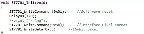

0693W000007E2SdQAK.jpg​
I set it up like this.

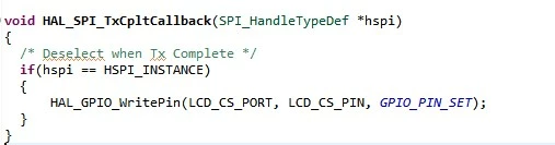

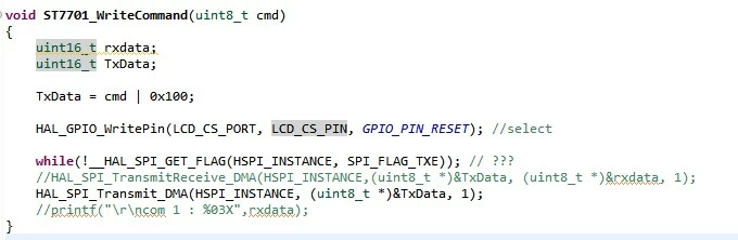

0693W000007E2V7QAK.jpgRESET CS pins, 8-bit data, TxData = cmd | 0x100 and send to HAL_SPI_Transmit_DMA.
​CS pin SET check is done like this.
0693W000007E2VHQA0.jpg​
​Is this the right way to do a 9-bit transmission?
