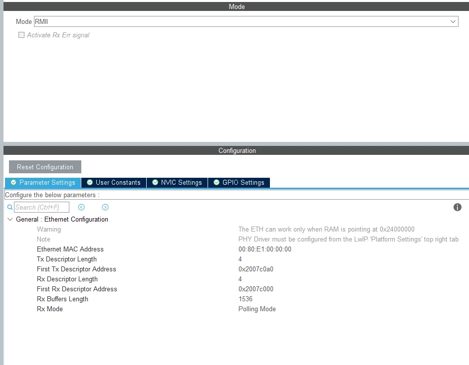

I'm trying to get Ethernet working with STM32F765VIH MCU and developing using Keil MicroVision and CubeMX 6.11.1
When setting up CubeMX I'm seeing warning message that RAM needs to point to 0x24000000 for ethernet to work.
I don't see an option for setting ETH RX Buffer Address like in previous versions of CubeMX. Has this been renamed or moved somewhere else.

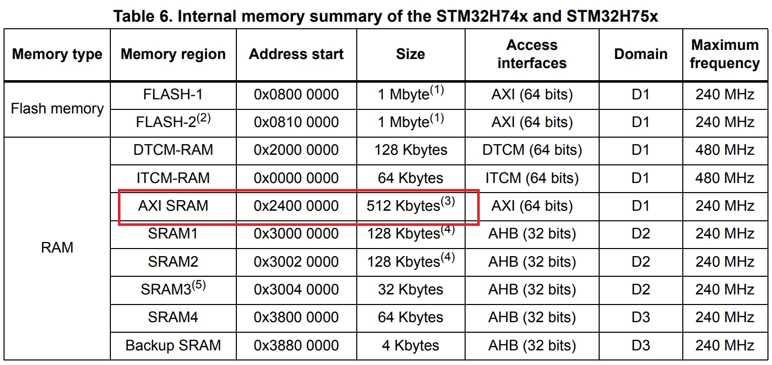

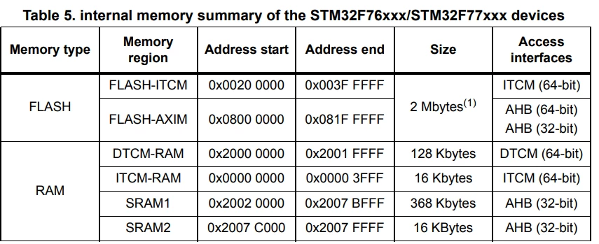

There is no RAM location at address 0x24000000 for STM32F7. I think you're using a project from STM32H7 (AXI-SRAM located at 0x24000000).
STM32F76xx (from AN4667) :
STM32H74x/STM32H75x (from AN4891) :

It is a STM32F765VIH6 device on the board and I started this project from scratch. What I'm seeing is a warning.
Do I need to set something else for this warning to go away or should be ignored. PHY drivers have been selected in LwIP.

To me the warning message is wrong as there is no RAM at the address 0x24000000 for F7 products (internal Ticket 185332)
Doing a search inn all the generated projet I didn't find any address pointing to 0x24xx xxxx. So, I think the warning is just a message.
