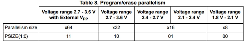

ds11532 rev 6 on page 153 in table 57 talks about a maximum supply voltage of 3.0 volt with 32-bit flash program operation. This number seems inconsistant with a maximum voltage of 3.6 for 8 and 16 bit flash programming. The F74x datasheet also has 3.0 Volt as maximum for 32-bit programming?

You are right: 3V is wrong as maximum programming voltage with 32-bit program, it has to be replaced by 3.6 as we can see in the relevant reference manual:
This is reported to be fixed in STM32F7 datasheets. Thanks for highlighting.
