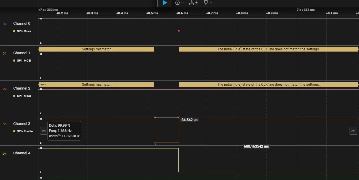

STM32F756VGH6 SPI pins are not responding
  • January 14, 2025
  • 855 views
I am developing and exploring a register programming based SPI driver. I took my time to read the datasheet and analyze the SPI startup sequence. For testing, I am using pre-programmed SST25VF080B memory IC.
I wrote a simple and low speed (less than 1 Mbps) SPI driver using registers. It did not look too complicated for me, I verified my setup function with a debugger (not 100% sure, if the setup code itself is correct, but I know for sure, that every line in the SPI_Setup function gets executed correct.) Problem arises when I enter the SPI_Send function - attempt to write data into SPI4->DR register for transmission fails, the register isnt acquiring the data... Logic analyzer even shows that the clock is not generated either. It may be a simple mistake or mistype somewhere, but I can not get it any further on my own, its my first time dealing with STM32 registers in SPI... Any help is much appreciated.
Some notes: I double checked the wiring and hardware, if I use the SPI pins as regular GPIOs, they work just fine, so hardware problems are very unlikely. I use the CS pin with hardware slave management - the exact SPI4_NSS pin is used and it is automatically pulled down as soon as SPI peripheral is enabled. Logic analyzer shows the CS pin toggling, so I have at least one step into it... If I missed some important project details, please let me know.

waclawek.jan
January 14, 2025
Without even having a look at your code: read out and check/post the SPI and relevant GPIO registers content.
Vilius
ViliusAuthor
January 14, 2025
If I understood your message correctly, my SPI CR1 and CR2 registers look exactly how I treat them in my setup function, like I said, I have verified that every line in the setup function gets executed correctly.
waclawek.jan
January 14, 2025
And have you verified also that there's nothing which would change those registers afterwards?
The same for the relevant GPIO registers.
Reading out and checking content of registers is 101. Post for others to look at them.
I also presume that you've already tested the SPI_CK pin's continuity to the point where you are measuring it, by setting given pin to GPIO Output and toggling it.
