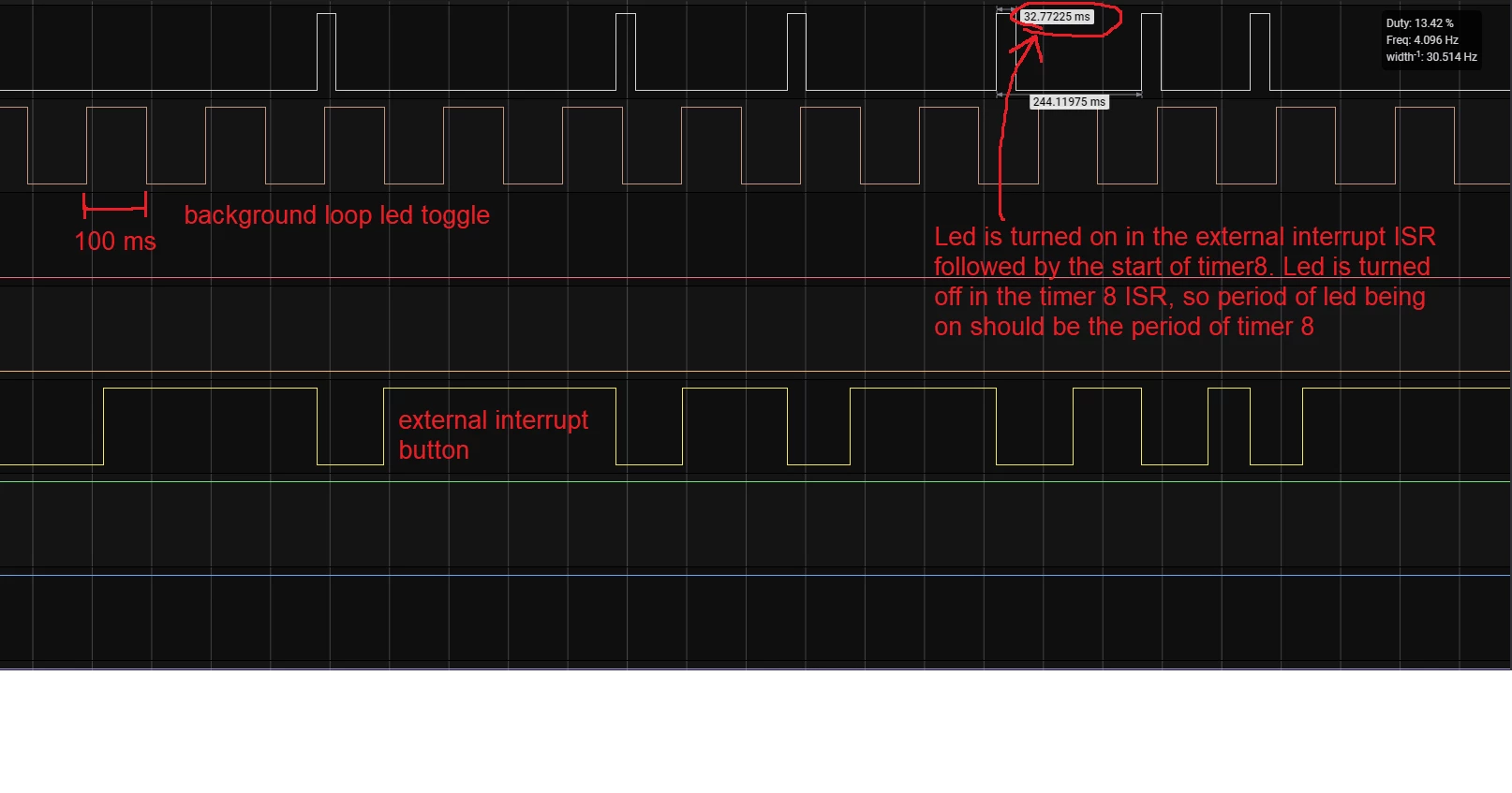

Vilius
ViliusAuthor
Apr 1, 2024 12:39 PM UTC
Right, that was my mistake. Thank you for pointing it out.
However, there are still some problems left. Timer 1 is used for blocking delay and timer 8 is used for interrupt. Both timers have exact same clock setup, same prescalers, same source etc. Full period of 16 bit count is around 500 us in my setup, timer 1 justifies that. However, in my external interrupt ISR, I turn on led, start the timer8, and in the timer 8 ISR I turn the led off. That effectively should depict the period of timer 8 with a minor discrepancy. My logic analyzer shows that period is 32 ms which is is way off the expected 500 us. External interrupt setup and ISR is tested previously, it worked well. What could possibly cause such unexplainable GPIO on state period (it has to be related with timer 8, but since its 64 times off the target, I dont have an ideas...)?

void Timer8_Setup(void){ //16 bit advanced timer
	RCC->APB2ENR |= (1 << 1); //Enable Timer 8 clock
	TIM8->PSC = 99; //APB1 is 50 Mhz and 100 MHZ for timer (The number is set: Clock in MHz - 1) 1 full period equals 1 MHZ
	TIM8->ARR = 0xFFFF;
	TIM8->CR1 = (1 << 2); //Only counter overflow/underflow generates an update interrupt or DMA request if enabled
	TIM8->DIER = (1 << 0); //Update interrupt enabled
	//TIM8->EGR = (1 << 0); //Reinitialize timer
	//TIM8->CR1 = (1 << 0); //Enable Timer 8 counter
	//while(!(TIM8->SR & (1<<0))); //Wait until timer update bit is set
	//TIM8->CR1 &= ~(1 << 0); //Disable Timer 8 counter not to generate any unwanted interrupts
	//TIM8->CNT = 0;
	NVIC_SetPriority(TIM8_UP_TIM13_IRQn, 1);
	NVIC_EnableIRQ (TIM8_UP_TIM13_IRQn);

waclawek.jan
Apr 1, 2024 1:40 PM UTC
According to your delay_ms() function, 1ms is equivalent to 2000 counts of TIM1.
With identical clock source and prescaler, the 65536 counts of TIM8 from 0 to ARR  should take 65536/2000 = 32.768ms.
Isn't it exactly what you observe?
PS. Don't use RMW to clear TIMx_SR bits. Here it's not a problem, as you have only one interrupt source, but it's a bad habit.
Vilius
ViliusAuthor
Apr 1, 2024 1:49 PM UTC
Oh right,
I wrote my delay function quite some time ago. I somehow perceived it as 2000 times full 16 bit count without ever catching the eye to it... Thank you once again... This made and end to my prolong headache on this timer interrupt problem...
