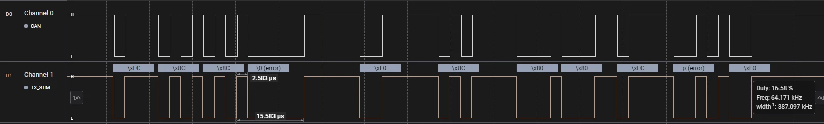

STM32F756VGH6 CAN mailbox registers behave unpredictably
I am learning the CAN communication based on register programming. For now, I dont have anything complicated on my mind, dont have any filters or queues set up for CAN packets, my goal is to start a simple data transfer via CAN between my STM32 and ESP32 acting just as a dummy echo transceiver. I wrote code aiming for 1 Mbps speed (its not crucial, but 1 mbps should not be a problem even on a breadboard), 11 bit identifier, 1 byte data length, no crc, I am using TJA1050 as transceivers for both ESP and STM. My CAN_Setup function is verified with the debugger, it does exactly what its asked for (in terms of bit manipulation). However, problems occur when I try to transmit a byte of data in the CAN_transmit function. Some actual data is generated on the TX line, but its completely wrong (thats not the main problem considering its only development phase.) I can not write any data to the TIR, TDTR and TDLR register (but the mailbox itself is free, its not in the pending state). When I run the program in debug mode, executing those lines does not change anything in the mentioned registers. Likely there could be more problems with my code, but for now thats one thing to hook on. Did my initial research, but could not find the solution, I never experienced something like that programming the registers earlier... Any idea why could the TX mailbox registers appear ,,frozen"? Thank you. If I forgot some crucial details please excuse me, I will provide it as soon as some discrepancies occur.

mƎALLEm
mƎALLEmBest answer
Jan 28, 2025 7:50 AM UTC
I suggest to start an example using HAL at least to validate your hardware and also to inspire from the HAL implementation. After that you can move on with the direct access to the register implementation.
1 reply
