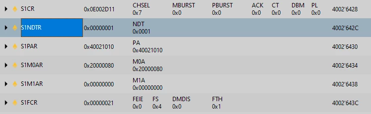

So, I have test it. I have change DMA1 to DMA2. Now it works only for one DMA transfer. When I enable by booth timer the DMA Request update, the software crash and the debugger stop at the adress 0xbeca4cf0. The callstack give me the follwoing information:
It is not so help full. The initialilsation is generated with STM32CubeMX.

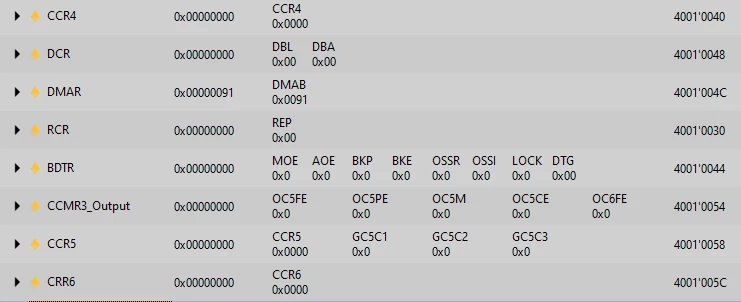

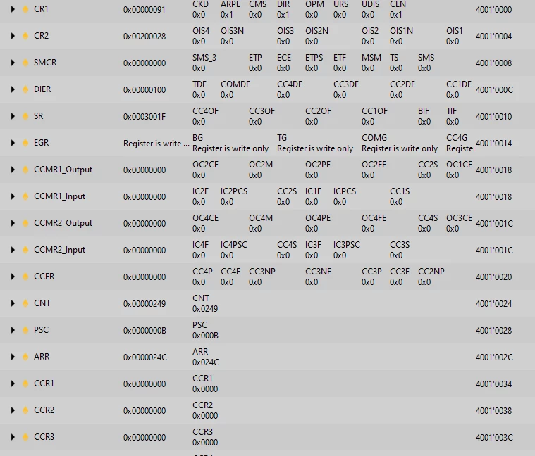

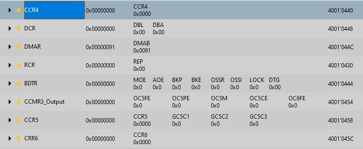

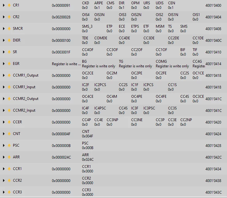

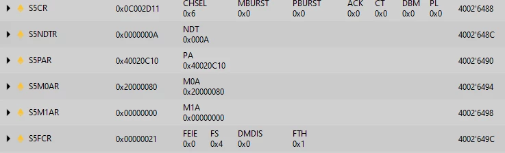

After the crash the following DMA and timer configuration are shown:
DMA2:
TIM1
TIM8

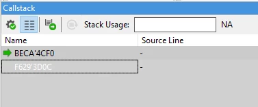

Whre come this crash? If it a problem with the timing otself? Booth timer have the same timing.
Thanks for our help,
Bernd
waclawek.jan
Dec 18, 2024 8:47 PM UTC
Registers look OK.
The crash is outside of what you've shown us.
TIM1 just rolled over (or under - choosing downcounter is weird, and also are you sure you want to set up TRGO/TRGO2? they are harmeless now but not needed for this exercise either) as witnessed by it CNT, and DMA2Stream just triggered a Transfer Complete as witnessed by NDTR and the flags in HISR.  As the flags (namely TC) is not cleared and you have interrupt on TC enabled, the crash is most probably consequence of the interrupt, most probably incorrectly handled.
Check - best in mixed C/disasm view - that the proper vector to the ISR is inserted to proper position inside the interrupt vector table. If not, check if the ISR name matches exactly (noting that C is case sensitive) that in the vector table (usually in the startup code; the interrupt chapter in RM contains the reference list of interrupt vectors). If you use C++, mind name mangling.
PS. What's this IDE?

Thanks all, now I found the last problem. It was the debugger. I user the winIDEA from iSystem with iC5700. And here I must configured a reset after download a new firmware. And I've forgot this. So is artifacts inside of the registers in the MCU, which can result in ...
So, I hope that was all problems. Now I start my tests of the signal analysis.
Regrads, Bernd
