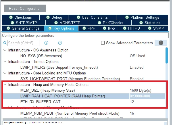

I am using the latest version of CubeIDE (1.17.0), a STM32F765 Nucleo board with Ethernet. I am configuring the project to run lwIP using the internal Ethernet MAC. I am using FreeRTOS (CMSIS V2). CubeMX configures this LWIP_RAM_HEAP_POINTER to a default value of 0x30004000 which is NOT a valid address in the processor. I have gone through the reference manual to find out that nothing is present on this address and it is a reserved address. This causes a hardfault whenever I execute the code. However, if I comment the definition of LWIP_RAM_HEAP_POINTER, in that case lwIP uses normal buffer declared in RAM as heap and my code runs without any problem. I am making a course on this, so I just wanted to confirm if this is a bug in CubeMX or what?

This issue has has already raised in this thread. Internal ticket number 199455 already opened.
Thank you for your contribution.
