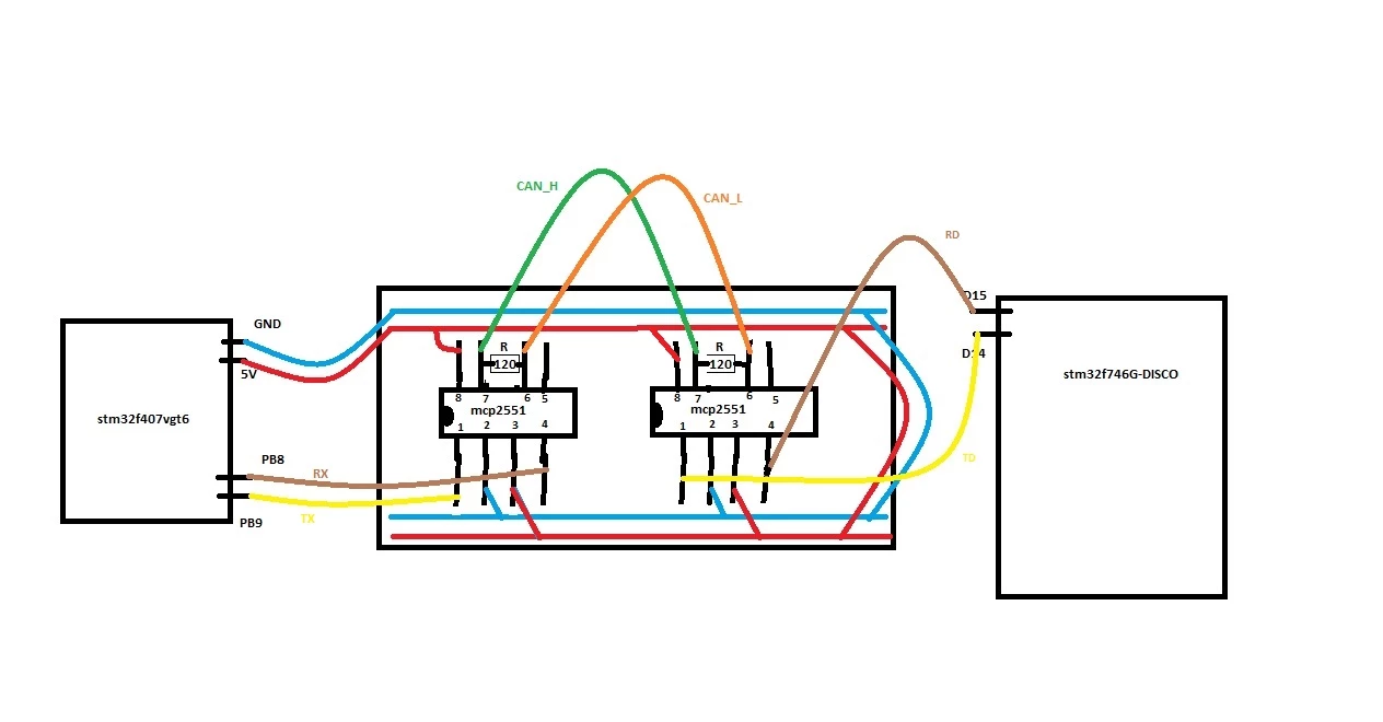

STM32F74G-DISCO and STM32f407VGT6 with CAN bus communication not working
I have two boards: STM32F74G-DISCO and STM32f407VGT6
They are connected with CAN bus, but the connection is not working. On the picture in attachment is my schema. I think that my code is okay, but I am not sure about schema. I have two transceivers MCP2551. I can paste also the code, if needed.
Thanks for answers.

Common the ground on the F746 side

I have tried it, but the same result. Both boards are also connected to the same PC, so there should not be the problem with ground.

According to the MCP2551 datasheet, the driver may be in standby mode: V Rs > 0.75 VDD
See table 1-1
Rs pin must be tied to ground through a resistor

I changed transceivers and used new ones: MCP2542. Now it is working fine.
Thank you very much for your answers.
