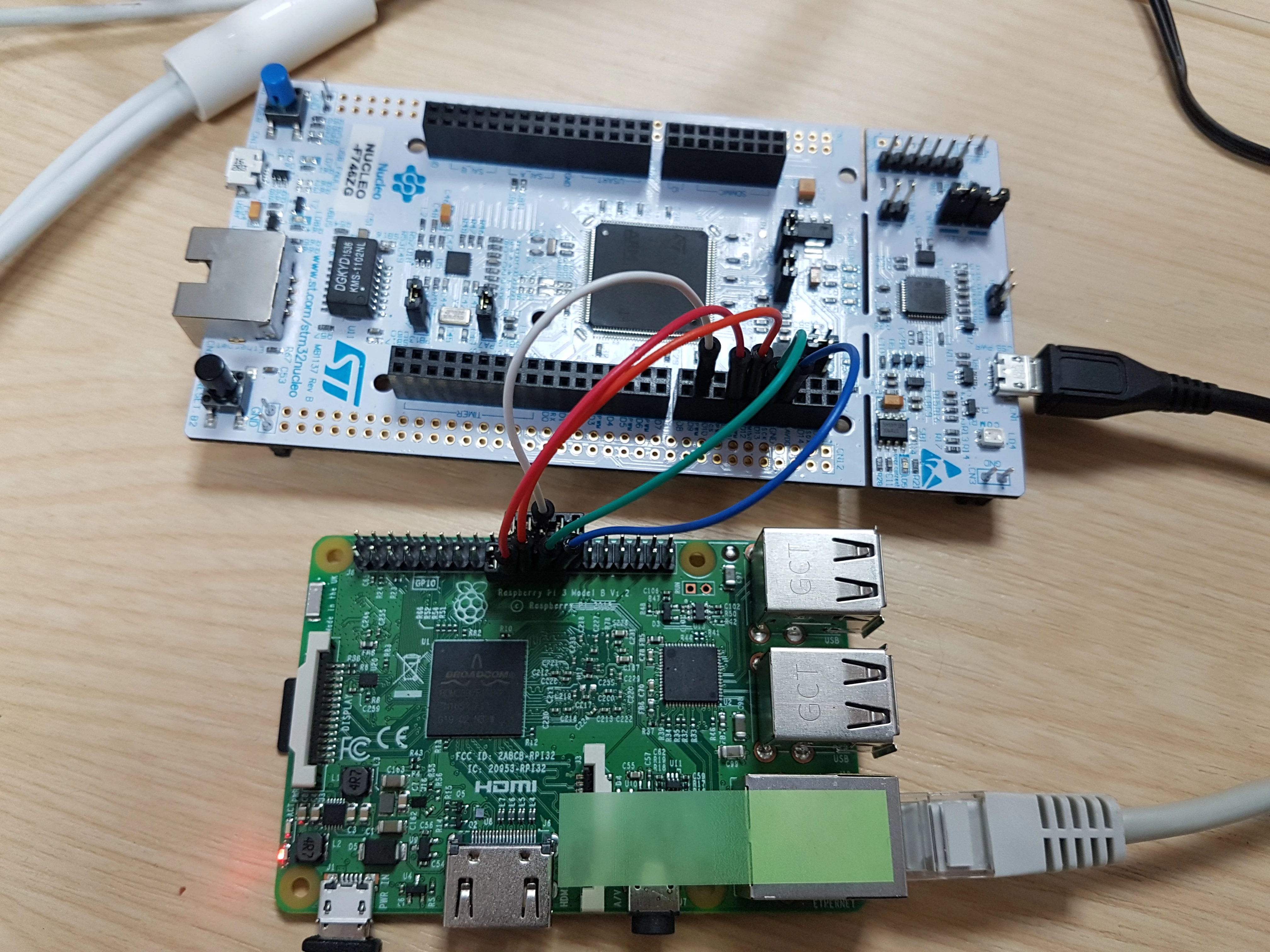

    you wrote  'I'm trying to receive data'   As slave or as Master?
    Write more detail about  your hardware configuration..
    Matt Jackson
    Jul 19, 2017 2:13 PM UTC
    Posted on July 19, 2017 at 16:13
    Hey Vangelis,
    Thanks for the reply!
    The STM32F7 is configured as a full duplex slave.  It is receiving data from a Raspberry Pi 3 configured as master.  I've used this Pi to send SPI data successfully to various other dev boards.
    Here's a pic to give you an idea.   The wires are nice and short, and as I stated above, I've checked that the Nucleo is receiving he SPI data as intended.
    Here are the connections as it's hard to see from the photo:
    NSS / CS = CN7 pin 17 (PA4)
    SCK = CN7 pin 10 (PA5)
    MISO =  CN7 pin 12 (PA6)
    MOSI = CN7 pin 14 (PA7)

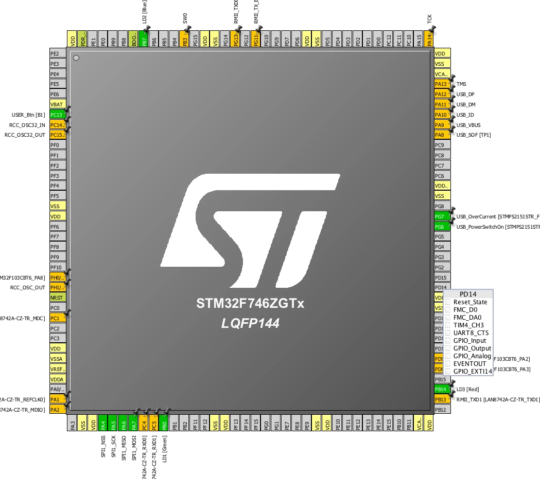

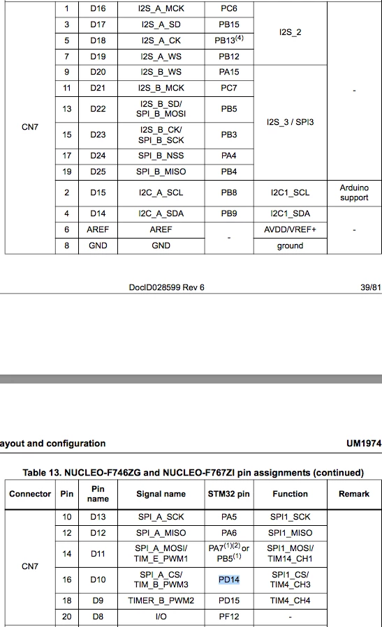

    Interestingly, there appears to be some sort of inconsistency  between the Nucleo Manual and the CubeMX configurator.
    This pin table says that I should use CN7 Pin16 (PD14) as SPI slave select:
    However in the configurator, I'm unable to select that option for pin PD14:

    Vangelis Fortounas
    Jul 19, 2017 2:37 PM UTC
    Posted on July 19, 2017 at 16:37
    Hello again !
    you wrote before '
    I would put up more code, but it's all generated by CubeMX, so it should be fine.
    Unfortunately its not fine
    After your Initialisation function called by main() function , you must initiate the transaction by call  HAL_SPI_Receive_IT(...) function (to use the interrupt and your callback function)
