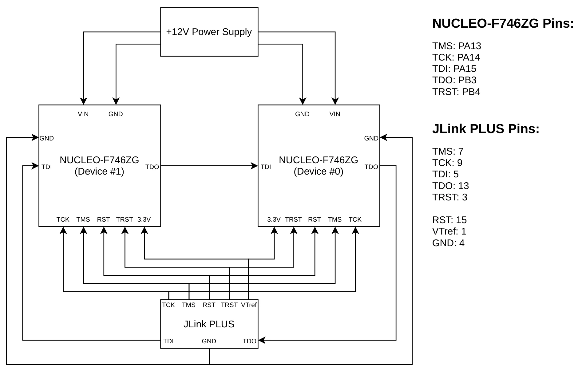

I have two Nucleo-STM32F746ZG development boards daisy-chained together via their JTAG pins (refer to below diagram). When connecting a JLink Plus debug probe to the microcontrollers and attempting to debug the second development board in the daisy chain (Device #1), the connection fails and times out; I am only able to debug the first development board (Device #0) since JTAG assumes a single device to be connected by default, if not configured otherwise. Furthermore, when attempting to run the JLink Commander software, I cannot connect to either development board. I am using Visual Studio as my IDE/debug interface.
I've tried:
  • Adaptive clocking
  • Slowing down the clock speed (from 4000 kHz down to 100 kHz)
  • Running "-jtagconf 4, 1" in the JLink Commander software to program/debug Device #1. The programs responds with "Cannot connect to target".
  • Setting "-jtagconf 4, 1" in my launch.json file for Visual Studio to program/debug Device #1. This yields a connection timeout.
  • Setting "-jtagconf 0, 0" in my launch.json file for Visual Studio to program/debug Device #0. This also yields a connection timeout.
  • Deleting the "-jtagconf" setting in my launch.json file. This allows me to program/debug Device #0.
Connection Diagram:
Can the development boards be programmed/debugged while in a daisy-chain configuration? Is there something wrong with my hardware connections?

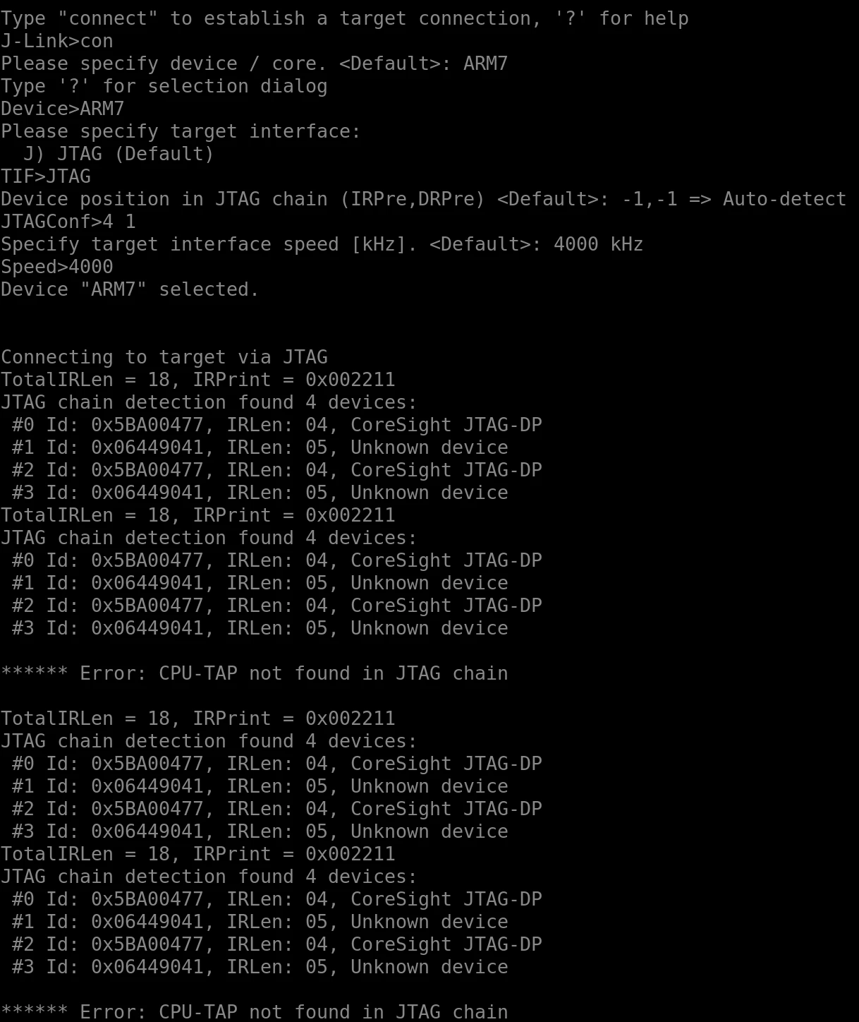

In the JLink Commander software, I specified my devices as "ARM7" cores instead of "STM32F746ZG" microcontrollers, and got a bit further. Connecting to the hardware now shows that four devices are found: two CoreSight JTAG-DPs (IRLen: 4) and two Unknown Devices (boundary scans, IRLen: 5). But the error I am now getting is "Error: CPU-TAP not found in JTAG Chain". Any idea what is missing from my configuration?
Reference picture:
0693W00000QLAqNQAX.pngEDIT 2:
I've played with a few more settings within the JFlash software, and have verified that my hardware setup is correct. I believe this is now a configurations issue with JFlash. I will mark this question as closed.
