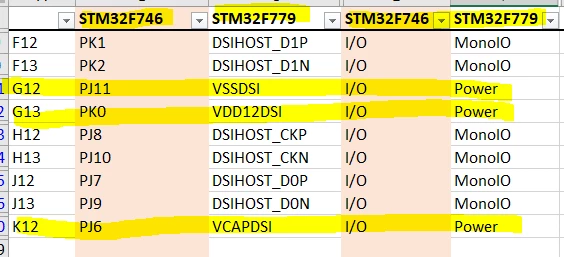

JK1234Author
August 16, 2024
Hello @STTwo-32 ,
I checked in CubeMX tool.
Tool suggest compatible MCU is STM32F779NIH6 against STM32F746NGH6.
But if, I compared both datasheets then I found there is a pin type is change.
refer below capture
So, please provide your inputs.
Thanks,
Jignesh Karena
TDKBest answer
August 16, 2024
STM32F779NIH6 is not due to the DSI pins. CubeMX shouldn't be telling you they're compatible here.
STM32F777NIH6 looks to be pin to pin compatible.

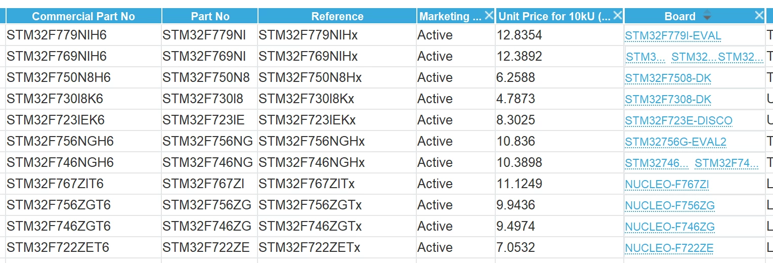

August 20, 2024
There is no eval board for STM32F777NIH6.
From STM32CubeMX, here are your options for ST boards for STM32F7 chips:
