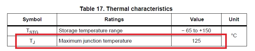

Dear Team,
I am using the STM32F746IGT7 microcontroller in our design. As per the datasheet, the specified maximum junction temperature is 125°C.
We would like to understand the implications of operating the IC at approximately 145°C, which is above the specified maximum junction temperature. Specifically:
  • Will the IC sustain permanent damage if operated at 145°C?
  • Could its functionality or performance be affected at this temperature?
  • What kind of degradation or long-term effects can be expected?
  • Is there any possibility of immediate failure, or could the IC continue to operate with reduced reliability?
The requirement for operation at this elevated temperature was identified after the board had already been populated with this IC. Therefore, we would like to assess the practicality and reliability of operating the existing design at approximately 145°C.
Kindly provide your recommendations and any relevant application notes or reliability data for operation beyond the specified junction temperature.

Hello ​@Athiravinod and welcome to the ST community,
TJmax is 125°C and 145°C TJ is out of specification and we cannot guarantee the reliability of the product.
If it works: it will reduce the life time of the product and increase considerably the power consumption that, most probably, it will damage the device.
Sep 25, 2026 9:28 AM UTC
… and even worse: if “operated at 145°C” means the ambient temperature, then the junction temp will be even higher (because of power consumption).
This is why DS 10916 states for your F746IGT7 “Industrial temperature range, –40 to 105 °C” (in “8. Ordering information”).
In this case you are ~40°C too high...

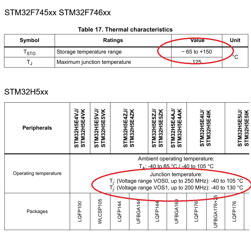

STM32F746IGT7 - LQFP 176 pins  - Industrial temp range
The package is probably an advantage - pins not balls and lots of them.
The datasheet charts many things that are temperature dependent including HSI (internal osc)
You can adjust core voltage VOS and run SYS CLOCK at reduced frequency
You can turn off any unused peripheral clocks
Running your main code in SRAM means no wait states so lower SYS CLOCK will be equivalent. Expect Flash to deprogram over time so write code to check Flash, running your entire app in SRAM may have advantages. Booting it from Flash at startup when the Flash is still cool (or at ambient)
Optimise some aspects of code
Turn off all unused GPIO
Any GPIO’s used, set them for lowest drive and slowest transition
Raise SYS CLOCK for milliseconds when needed
Consider using a Peltier
You have two things working for you see the info encircled in red
The second table is for another device but shows VOS is important and SYS CLOCK is important and that this device will work at 130 deg C in VOS1 at 200MHz and the core can go as low as VOS3 - for this device
The main thing working for you is storage temperature at 150 deg C
The next thing is current consumption - if you can get your current consumption down, your core voltage down then look at the sums  35mA over 3.0 volts is 105 mWatt and over an LQFP176 that’s peanuts will raise package temp a few degrees maybe
You can run the whole IC on as low as VCC of 1.8V if that’s not possible you could use 3.0V
The aim would be to keep power consumption to the sub 100mW level. Then the device begins to look like its being stored not used.
Acid test as ​@LCE suggested and if this is important to you, put a few in an oven and test at 145 150 155 160 degrees for days
