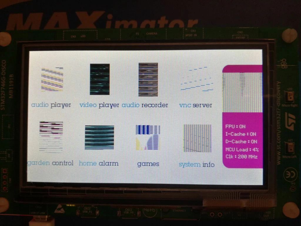

I had a few STM32F746-DISCO boards. This time I bought second hand board and uploaded demo app.
All pictures are 'scrambled'. I cannot figure out what is going on. Seems like a hardware defect.
Please share your thought on this.

    OK. the upload procedure I took was wrong. Need to uload file to the external flash I guess.

    ST-LINK 4.1.1 works fine with programming of external flash (QPSI).
    The problem was related to the clock frequency. After setting it to 4MHz all worked fine (no timeout during flash programming). The images are beautiful (unusually beautiful).
