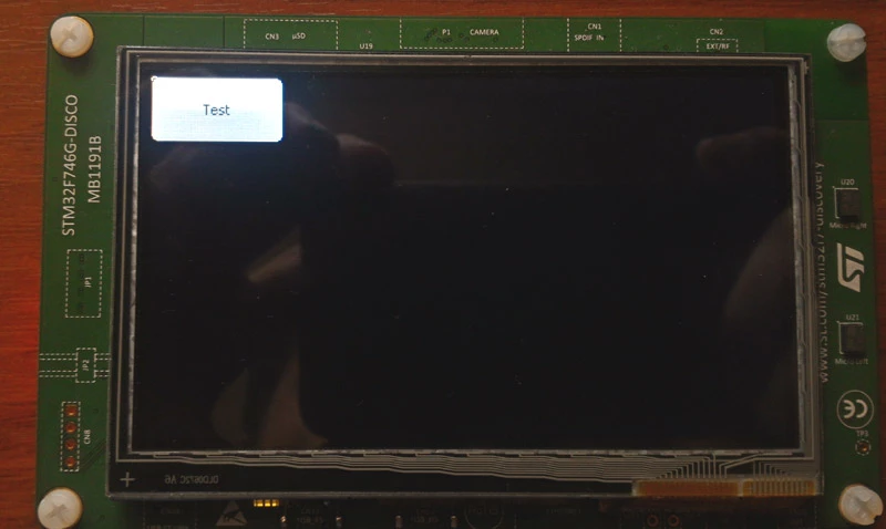

I start with stm32f746g-disco
http://www2.st.com/content/st_com/en/products/evaluation-tools/product-evaluation-tools/mcu-eval-tools/stm32-mcu-eval-tools/stm32-mcu-discovery-kits/32f746gdiscovery.html
. For examples in STM32CubeF7
in particular STM32Cube_FW_F7_V1.3.0\Projects\STM32746G-Discovery\Applications\STemWin\ STemWin_HelloWorld. Compiles example in Keil uVision5 (without optimization) - it's OK, HelloWorld displays. Create a button:
hButton = BUTTON_Create(0, 0, 100, 50, GUI_ID_OK, WM_CF_SHOW);
BUTTON_SetText(hButton, ''Test'');
GUI_Exec();

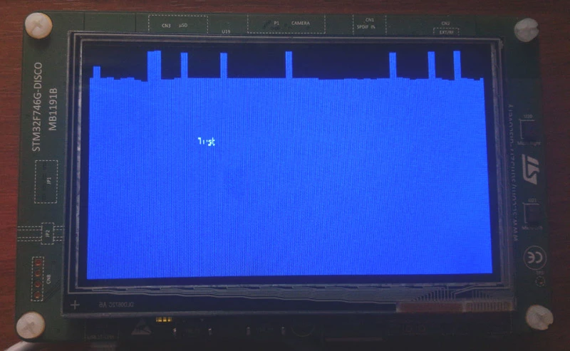

It's okay. 0690X00000603ImQAI.jpg In GUIBuilder.exe do simple box (box + text), call the function CreateWindow - that does not work. Distorted window background and distorted text labels. The reason I can not find. 0690X00000603P3QAI.jpg If you have a board stm32f746g-disco it can flash Hex file can be a problem with the card. Thank you. Source: Changed only BASIC_HelloWorld.c

    My guess is that the configuration of the STemWin library implemented in the Hello World example simply does not include the functionality you are looking for.  This is a problem starting with one of the example programs, and not having a configurable baseline using CubeMX and the libraries themselves.  It would be helpful if ST provided information of how they got to the examples they show, rather than just the final product which is more a demo than an example of how to use their products.
    To print Hello World on the display, all that is needed if the STemWin libraries is a few basic library calls with the display set up as a single window taking up the entire display.  It is likely that this is set up in a way that does not support creation of multiple windows to display on the LCD.  And without more information about what is implemented it is a long road to recreate the demo in a way that would be useful for what you want to do.

    Solution see:
    http://mail.free-ide.com/index.php?page=Thread&threadID=3118
    Please try to disable the data cache by a call of SCB_DisableDCache() before GUI_Init().
