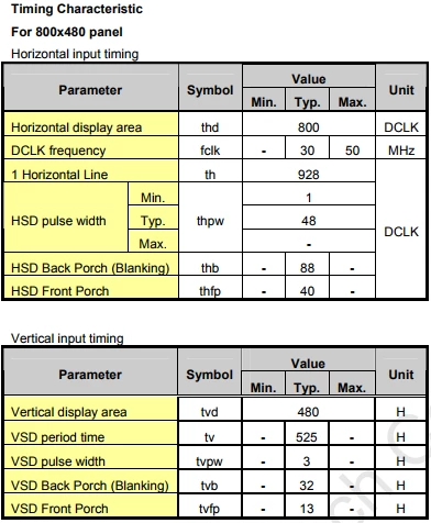

Dear every body,
I are using
LCD TFT 7 inch 800x480
/external-link.jspa?url=https%3A%2F%2Fwww.buydisplay.com%2Fdefault%2F7-tft-lcd-touch-screen-display-module-800x480-for-mp4-gps-tablet-pc
  in our design with STM32F746BTG6 processor working at  200 MHz frequency.
We are using STemWin Library on RTOS operating system
/external-link.jspa?url=https%3A%2F%2Fwww.freertos.org%2F
  with LTDC support.
GUIBuilder.exe software will generate gui data.
I are statically storing the required ARGB format in external SDRAM.
The data is loaded from SDRAM to LTDC (STM32F7 LCD Controller)
using DMA2D and FMC interface
(Flexible Memory Controller – Working at 200/2 MHz).
Timing LCD TFT 7 inch from datasheet:
/external-link.jspa?url=http%3A%2F%2Fwww.buydisplay.com%2Fdownload%2Fic%2FOTA7001A.pdf
 About frequency in system:
- SDRAM: 100MHz, use same bus data 16bit with other device. Examples:nor flash.
/* Timing configuration for 100Mhz as SD clock frequency (System clock is up to 200Mhz) */
Timing.LoadToActiveDelay = 2;
Timing.ExitSelfRefreshDelay = 7;
Timing.SelfRefreshTime = 4;
Timing.RowCycleDelay = 7;
Timing.WriteRecoveryTime = 2;
Timing.RPDelay = 2;
Timing.RCDDelay = 2;
sdramHandle.Init.SDBank = FMC_SDRAM_BANK1;
sdramHandle.Init.ColumnBitsNumber = FMC_SDRAM_COLUMN_BITS_NUM_9;
sdramHandle.Init.RowBitsNumber = FMC_SDRAM_ROW_BITS_NUM_13;
sdramHandle.Init.MemoryDataWidth = SDRAM_MEMORY_WIDTH;
sdramHandle.Init.InternalBankNumber = FMC_SDRAM_INTERN_BANKS_NUM_4;
sdramHandle.Init.CASLatency = FMC_SDRAM_CAS_LATENCY_2;
sdramHandle.Init.WriteProtection = FMC_SDRAM_WRITE_PROTECTION_DISABLE;
sdramHandle.Init.SDClockPeriod = SDCLOCK_PERIOD;
sdramHandle.Init.ReadBurst = FMC_SDRAM_RBURST_ENABLE;
sdramHandle.Init.ReadPipeDelay = FMC_SDRAM_RPIPE_DELAY_0;
- LTDC: 19.2 MHz.
PeriphClkInitStruct.PeriphClockSelection = RCC_PERIPHCLK_LTDC;
PeriphClkInitStruct.PLLSAI.PLLSAIN = 192;
PeriphClkInitStruct.PLLSAI.PLLSAIR = 5;
PeriphClkInitStruct.PLLSAIDivR = 2;
HAL_RCCEx_PeriphCLKConfig(&PeriphClkInitStruct);
While I'm getting data in norflash, LCD have prolems is flickering.
I know that LTDC will gennerate data to LCD automatically after SDRAM refresh, isn't it?
What is solution to hold data on LTDC while other device use bus data of SDRAM (16 bit data)?
Can you tell me solutions to fix that bug, please?
Thank you so much!

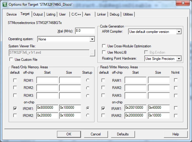

    Dear everybody,
    Beside, I want ask about FPU.
    How to enable to use FPU in STM32F746BGT6?
    How is configure FPU accuracy and MCU can run faster?
    Which toolchain you are using ?
    Some IDEs automatically add the appropriate code if you select 'use FPU' during project creation.
    How is configure FPU accuracy ...
    Single precision (float), not configurable.
    ... and MCU can run faster?
    Proper core clock and Flash settings, and enabling caches.

    Toolol chain: MDK-ARM standard version 5.
    I enabled FPU:
