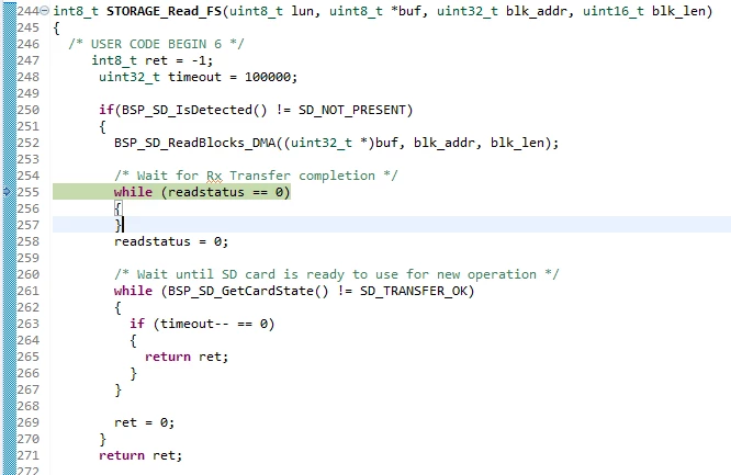

While debugging, I noticed that there were no interrupts, and the program was hanging in a loop, as shown in the picture below.
Then I commented out the while loop and the interrupts started working. I was able to read and write data to the uSD Card. I can't understand the reason for this behavior of the program. Please tell me what am I doing wrong?

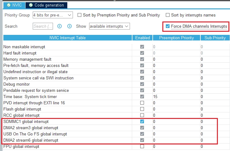

I have completed all the settings in CubeMX. The table below shows the interrupt priorities.
Please tell me how to correctly set interrupt priorities?

Code is far from ideal
Needs better timeout and bounding conditions.
The second loop needs to be bounded by TIME, not ITERATIONs
Likely seeing cascading failure, where the prior command didn't complete properly, so the next doesn't start nor interrupt.
The coherency issues on the F7 can be entirely avoided if the DMA buffers live in DTCM-RAM, the code doesn't need to be there.
I'd bound the first loop by TIME to, and fail with an error, not just stop and die there.. Removing it solves no problems.

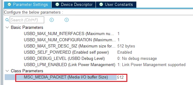

I did the following experiment: I implemented the read and write functions as follows
int8_t STORAGE_Read_FS(uint8_t lun, uint8_t *buf, uint32_t blk_addr, uint16_t blk_len)
/* USER CODE BEGIN 6 */
int8_t ret = -1;
HAL_SD_ReadBlocks(&hsd1, buf, blk_addr, blk_len, HAL_MAX_DELAY);
/* Wait until SD card is ready to use for new operation */
while (HAL_SD_GetCardState(&hsd1) != HAL_SD_CARD_TRANSFER){}
ret = 0;
return ret;
/* USER CODE END 6 */
int8_t STORAGE_Write_FS(uint8_t lun, uint8_t *buf, uint32_t blk_addr, uint16_t blk_len)
/* USER CODE BEGIN 7 */
int8_t ret = -1;
HAL_SD_WriteBlocks(&hsd1, buf, blk_addr, blk_len, HAL_MAX_DELAY);
ret = 0;
return ret;
/* USER CODE END 7 */
When MSC_MEDIA_PACKET = 512 all works good. But when I set this parameter to 1024, disk works is not correct.
The drive appears fine in Device Manager, but when I try to open it, Windows prompts me to format it.
Formatting cannot be performed, an error occurs.
I increased the heap and stack size to 0x10000, but that didn't solve the problem.
What could be the problem?
