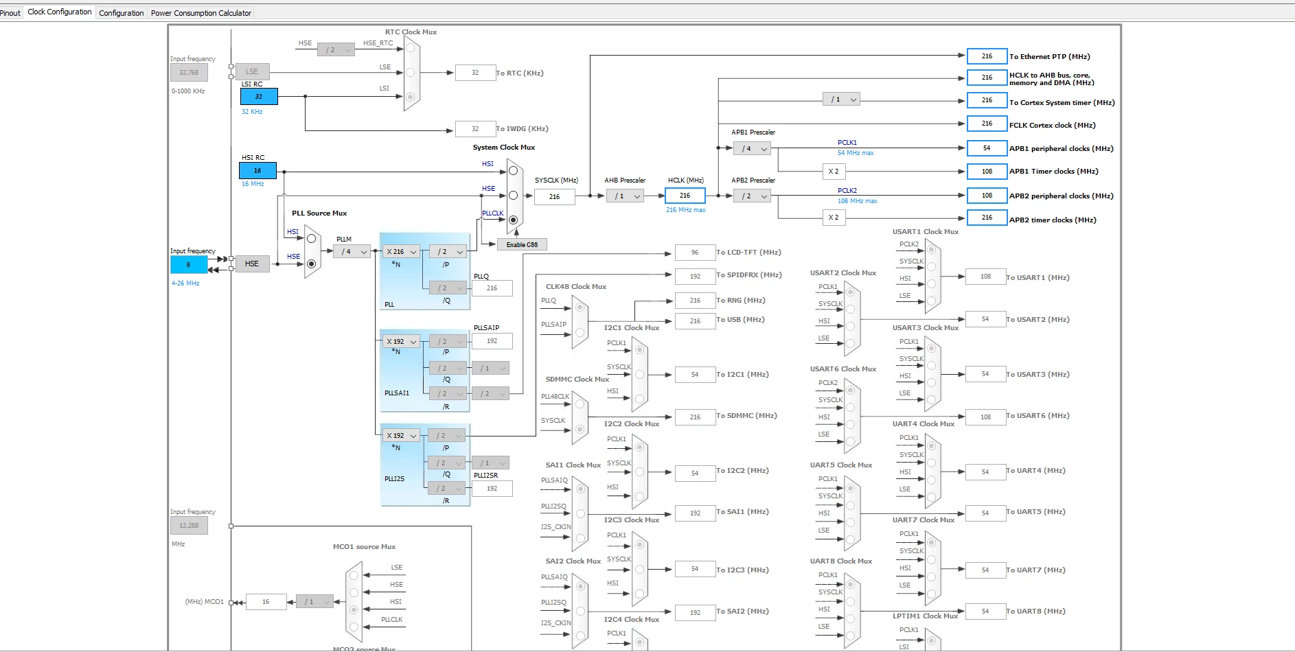

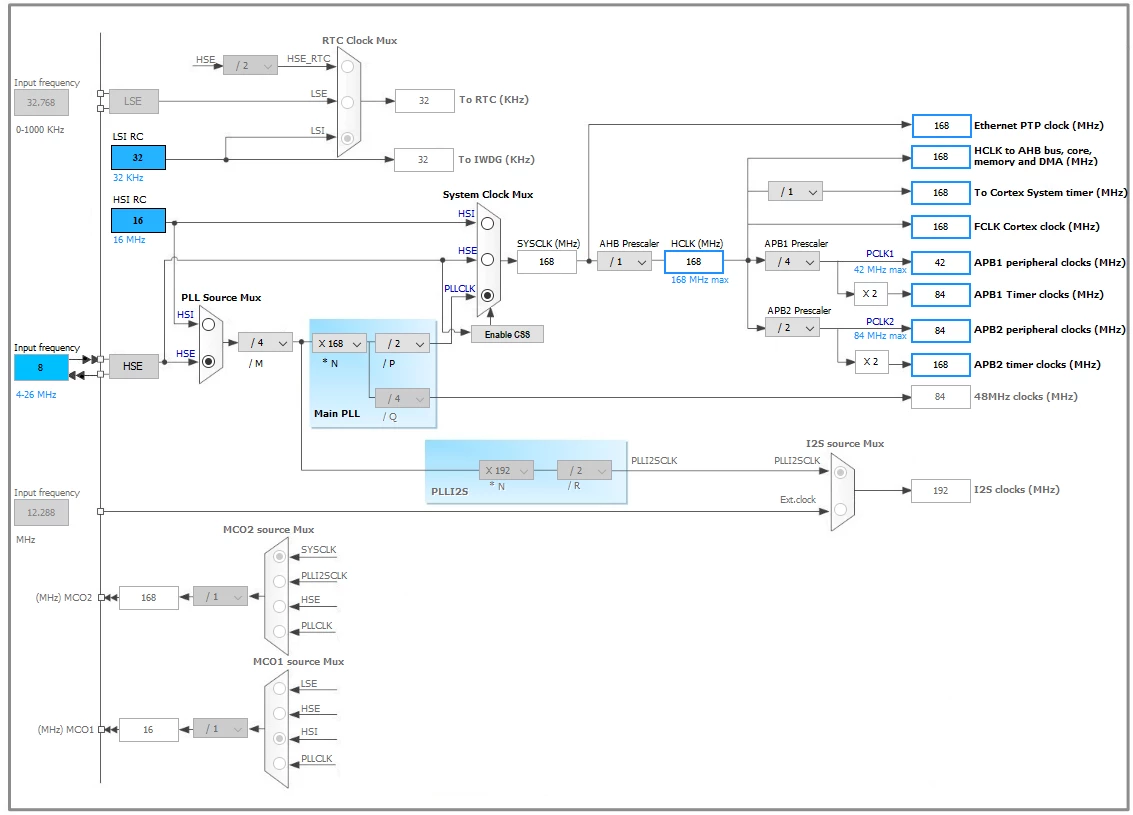

Jun 21, 2018 7:34 AM UTC
Posted on June 21, 2018 at 07:34
Im not sure what do you mean by ''
switching on compiler optimization''. Guess its not about CUBEmx clock optimization.
But anyway this is my clock config for both mcu's:
F4:
F7:
waclawek.jan
Jun 21, 2018 4:41 PM UTC
Posted on June 21, 2018 at 16:41
Read the manual to your compiler/toolchain. Surely there is a mention of optimization.

Jun 21, 2018 7:39 AM UTC
Posted on June 21, 2018 at 07:39
Hi, well ,as you can see clock config images above, sysclock is on max freq, also my code doesnt do any other tasks besides toggling a pin with HAL struct
