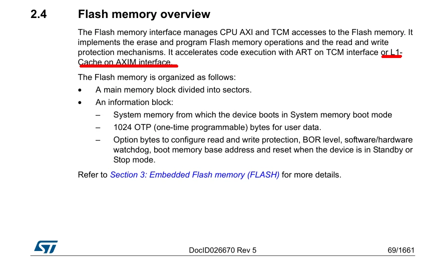

I've got a simple test that runs under an RTOS. There are two identical tasks that blink separate LEDs using a software delay loop. The two tasks are identical except for the LED that each blinks. Both tasks have identical priorities, so the RTOS runs them in strict round robin.
If I have task1 first in the C file, then the LED associated with that task blinks at twice the rate of the LED associated with task2. If I swap the positions of the two tasks in the C file, then task2's blinks twice as fast as task1's LED. Swapping the tasks in the C file swaps their positions in FLASH.
The only thing that changes when I swap the positions of task1 and task2 in memory is the code addresses. The data and stack stay in the same place.
The only explanation for this behavior that I can think of is the relative positions of these two tasks in memory affects how the code is cached by the CPU. This is where I'm puzzled, however. According to the datasheet, only FLASH on the ITCM interface uses the ART accelerator. My code is in the FLASH on the AXIM interface.
Is there another instruction cache different from the ART accelerator? Is there any way to disable it to check whether it's the cause of the effect I'm seeing? I didn't find anything in either the datasheet or the reference manual.
This isn't a subtle effect--the software delay loop runs twice as fast in one task relative to the other.

    Now I'm seeing behavior that's even more puzzling. There are two bits in the CCR (Configuration and Control Register) on a Cortex-M7, CCR.IC and CCR.DC, that control the enabling of the instruction and data caches. I my case, both of these bits were set to zero when I ran my test yesterday. So with the instruction cache off, two identical tasks would run at different speeds depending where they were placed in memory (FLASH). With certain placements, one task ran about twice as fast as the other.
    I ran the test again this afternoon, and confirmed that one task runs about twice as fast as the other with CCR.IC cleared. The really puzzling thing is when I set CCR.IC to '1' to enable the instruction cache, both tasks run at exactly the same speed! I'm at a loss to explain this. My previous assumption was that one task ran faster than the other because it was preferentially cached in the instruction cache. Now I find that I had the instruction cache turned off yesterday, but now when I turn it on the issue goes away.

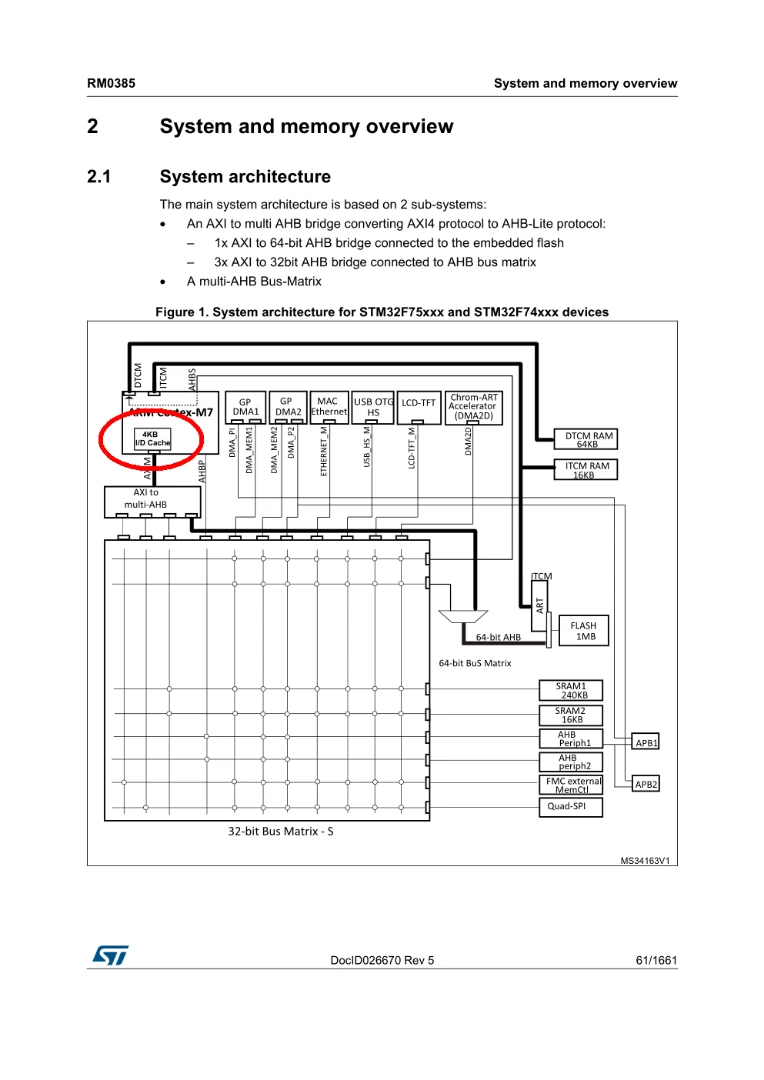

    I'm still puzzled why one section of code executes faster than another section of code when the instruction cache is turned off. This is counterintuitive behavior because neither piece of code is cached and hence should run at the same speed. Moving the two pieces of code around in FLASH relative to each other affects their speed. This affect would imply some kind of caching is happening.
    Is there perhaps some other mechanism at play here? Perhaps contention on the AXI/AHB interface?

    I'd start with simple and single code (no RTOS, no 'multiple instances'), trying to absolutely position its bulk at various offsets within the FLASH data width (64 bit of buswidth, and 256? bit of the actual FLASH, while instruction granularity is 16 bit), and try the influence of that. Changing latency (running it at low system clock) should show what's the real influence of FLASH access. I'd also try to estimate the impact of RAM/data accesses, stack, whatever. I'd then try to play with the caches.

    Ah so. I misunderstood the 'When I invalidate the I cache and turn it on (CCR.IC = 1), the loop runs at the same speed' part, reading it as 'runs at the same speed as when cache turned off'. As David says, this makes sense - running from cache should result in uniform execution time as cache provides instructions for the processor with no latency, as long as the bulk of the code fits into the cache and FLASH fetches are avoided entirely.
    When FLASH fetches are involved, as when the cache is off, then execution is significantly impacted by the number of FLASH reads needed to execute the bulk (one pass through the timing loop in this case), and of course the FLASH read latency (which is what I suggested to be one of the variable to play with - note that you can use freely higher latency with lower system clock, but not the other way round).  The FLASH row is 128 or 256 bits in width (see FLASH chapter in RM); and while there's no prefetch/ART on the AHB (i.e. non-TCM) port of it, I believe this whole row is latched upon a read into any part of it, and then served if a portion of the same row is read subsequently (even if this is not documented to do this, it would be rather foolish to repeat a FLASH-row-read... but one never knows of course -- ST may be willing to comment on this). Subsequently, instruction fetches are transferred through a 64-bit AHB bus into the AXIM-to-AHB interface and then to the AXIM port of processor. The Cortex-M7 features a prefetch unit, 64-bit wide, with a 4x64-bit pipeline; and there's also a speculative jump . The Thumb2 instructions are 16- or 2x16-bit wide... and the processor core is dual-issue superscalar... And then there may be data embedded in the code, such as 32-bit literals... so there is a bunch of opportunities for various caching-like behaviour on various stages between FLASH and processor; and this of course all depends on the particular alignment of things...
